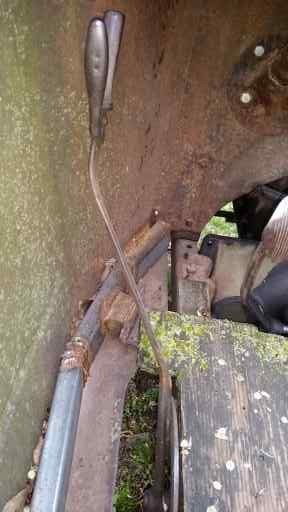

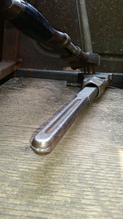

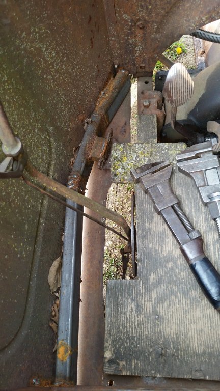

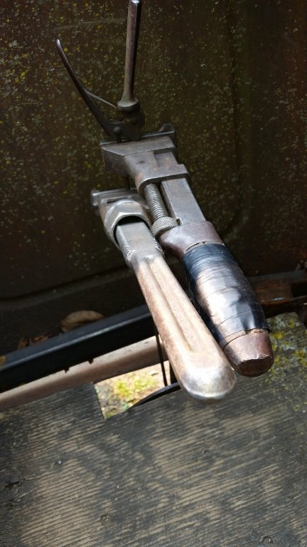

Will. Ed Baudoux. Duey C. Rusty Fords. Had a very through discussion about zee-ing the model T Break Leaver. Feb-12 & Feb 27th 2020 on MTFCA General discussion page complete with a number of pictures. Un-zeeing would use same technique just in reverse. Before You get carried away straightening your brake leaver check to see where You want the leaver. I had my zee-ed because it was right under my left knee and hard to operate and keep your left foot on the Clutch. Had to curl leg around the brake leaver to reach the clutch. Dangerous'
Duey_C
- Posts: 1558
- First Name: Duane
- Last Name: Cooley
- Location: central MN
Re: Straightening Emergency Brake lever
Jim, thank you. I found my pics about adjusting that lever.
Gentlemen, this was/is not a nice T. It's my Crappy '24 Runabout.
You should be able to adjust that handle exactly where you wish quite easily. I'd suggest the lever won't be mad at you either.
It sure does give more space. I tired of the handle poking at my leg. Did the same to the '18 Runabout. Ahhh.
