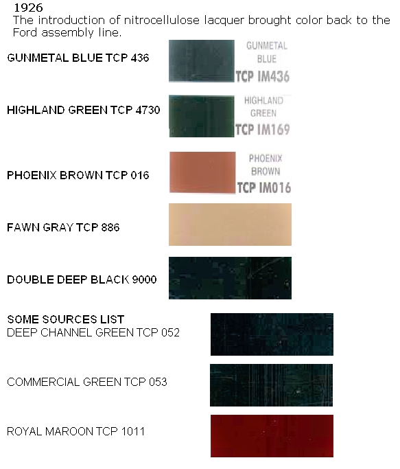

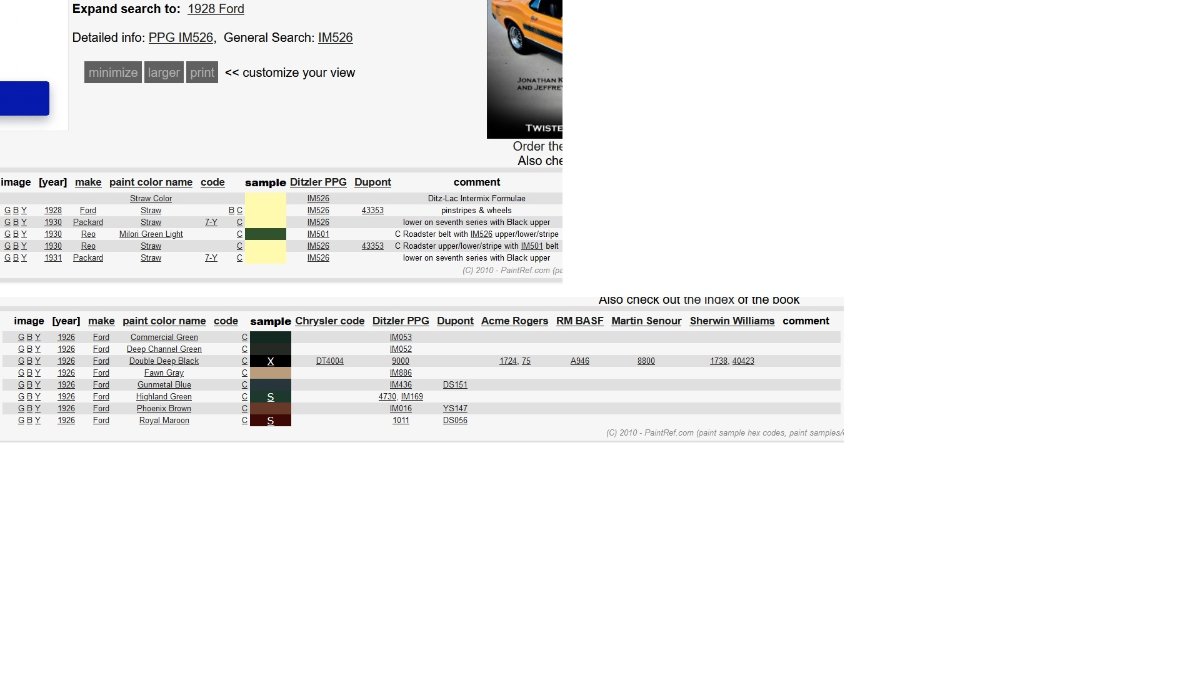

"WAS" ?
Click on images to enlarge
Not sure about these charts

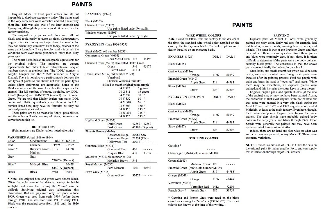

The MTFCA Encyclopedia has a nice article on paint. 26-27 T's had bodies painted with pyroxylin paint, not enamel or lacquer. Pyroxylin paint did not stand up to time, nobody really knows what the actual colors are. There are best guesses for paint colors, and some paint codes are published in the encyclopedia, but again, they are a guess. Regarding colors of wire wheels for the coupe, all wire wheels installed at the factory were painted black. Dealers had wire wheels available for swapping or for sale, color choices were red, straw, green, and black.
Posts: 6575
Re: Paint Color options for 1926 Coupe
Post by TRDxB2 » Mon Dec 19, 2022 1:33 pm
This is a link to the MTFCA Encyclopedia section on paint. Think its the one that Jeff is referring to. You need to scroll down to see all that there is to read. https://www.mtfca.com/encyclo/P-R.htm
