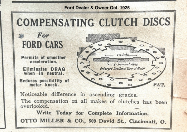

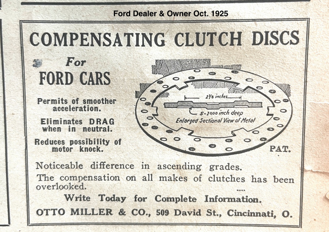

- Posts: 4081
Re: Clutch disk question

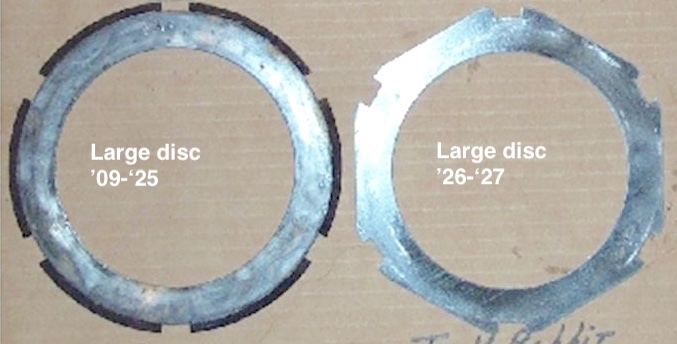

Those Ford clutch discs are flat from the factory, no dish.
There was a suggestion by Murray F. in his Ford Owner articles of penning worn plates to help for a better free neutral, but that was for worn really thin plates.
Of interest is a compensating disc offered in 1925, but only seen this one adv, likely the item didn't work out in practice.
