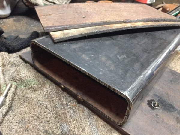

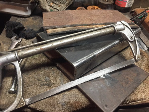

I cut the tube with a hacksaw and welded it back together: The plan is to use two flangers bearings: Matt

Nice old hack saw! My arms hurt for you if yours didn't. 1/4 wall, uff da.
Neat project!

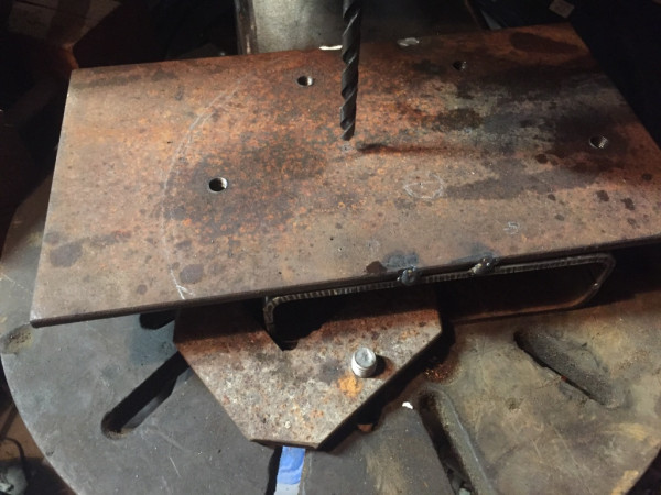

Yeah cutting four feet of quarter inch steel was a fun task. I should do advertisements hacksaw blades

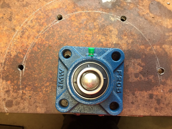

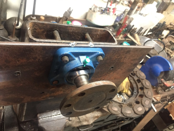

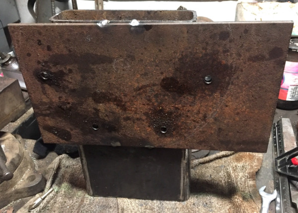

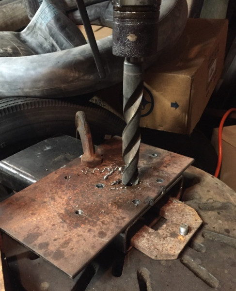

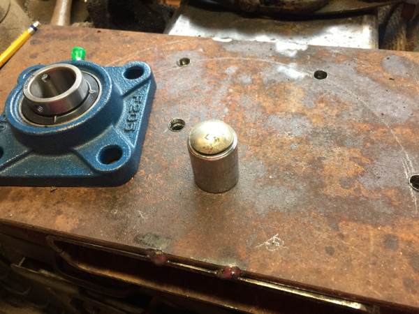

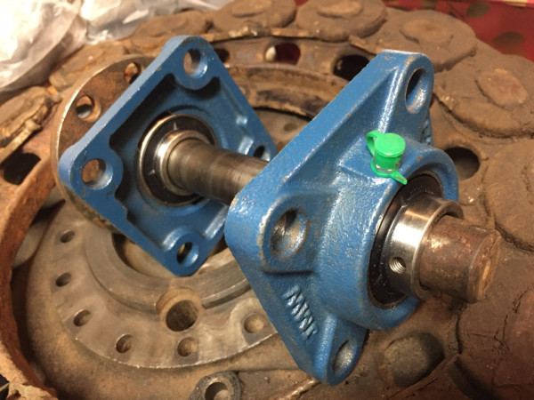

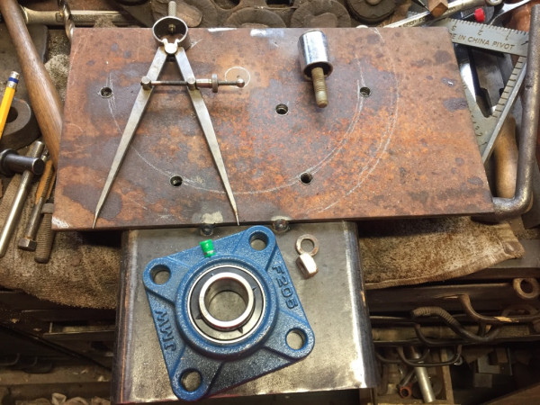

I started drilling holes for the flange bearing and ran into trouble. Things were not lining up. I’m not sure if I didn’t follow the measurements or does bearing was just different. I decided I needed to use the main shaft for as a reference. Does seem to be close enough for the magneto holes, Even though the lines don’t look perfect: I decided to drill the center hole where the shaft would go and use a socket to center the flange bearing for drilling. You can see how far off the first hole is:
browning

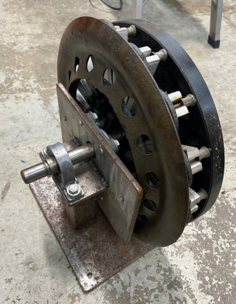

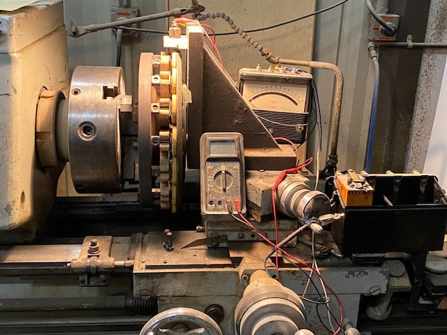

Here is the worlds heaviest and least practical HCCT (not really hand cranked). All I need is the spark ring.

Re: Building a DIY HCCT
David,
Now that you got our attention! That truly would be the heaviest Model T coil tester especially if you never used it as a lathe
What is the battery for?
That is the setup I made to test the rare earth magnet flywheel vs. the stock setup. The benefits are that I can test at various fixed rpm and easily change air gap as well as switch back and forth with different flywheel/magnet configurations. The battery is there because we have been fooling with solid state voltage regulators to see if we can create a charging system. The jury is still out on that one. If the magnets on the flywheel look like medium density fiberboard it is because they are. Its easy to machine on the CNC router and inexpensive enough to throw away when they don't work. The "real" ones will be 6061 aluminum if it goes that far.
Ed,
Yes you need to finish that! Looking at your example it looks like you are most of the way done. Except for the part that’s not mentioned of exactly how you cut the wood out. Of course I am assuming that your magnets are charged
David,
Sounds like you’re doing a pretty interesting experiment. I hadn’t analyzed it enough to see what you were using for magnets!

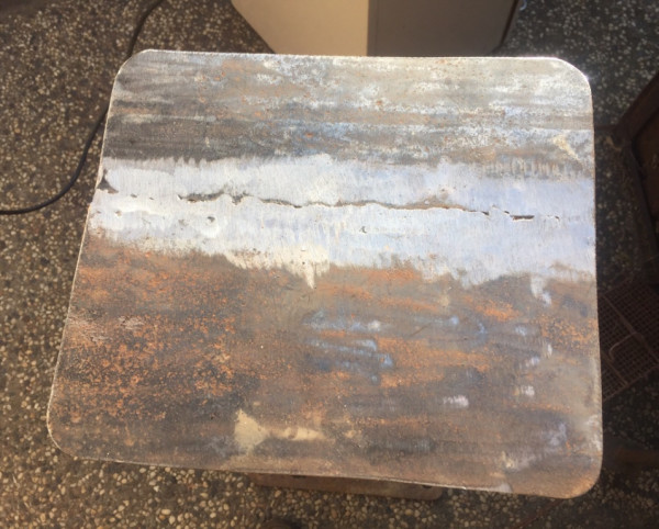

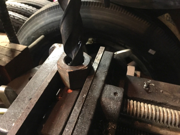

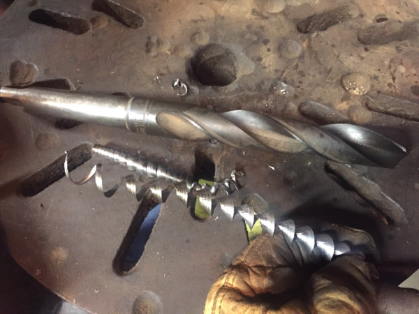

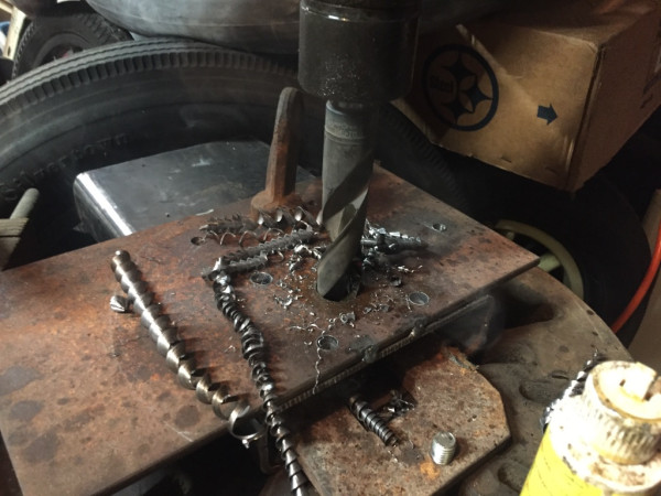

The next step was the fun part! Not everyone has capacity to drill a hole over 1 inch. But not too long ago I was at estate sale and purchased some large Morris taper drill-bits. Look how small those other holes look! I was happy to see the shavings were not getting too hot. I did drill a half inch hole as a starter. Things are looking pretty good with the bearing and shaft in place.
David,

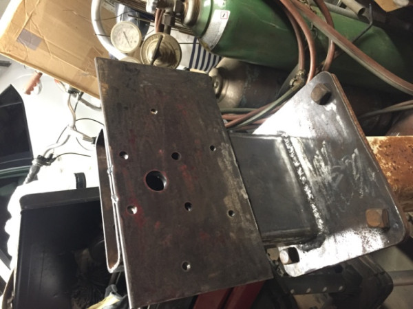

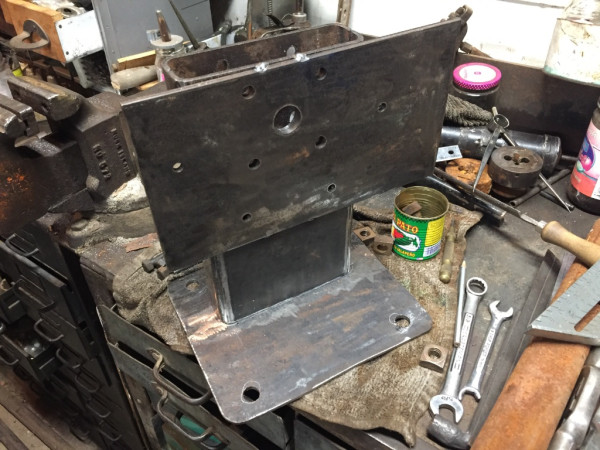

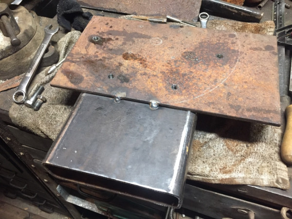

I will do the two pieces I cook out of the original 8x8 inch tube for the base.
Drilled some holes and checked fit:
Welded it on:
I consider myself more of a grinder than a welder… In this case I just left my welds.

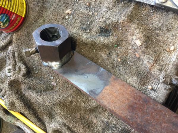

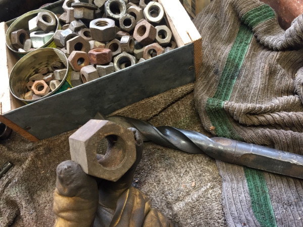

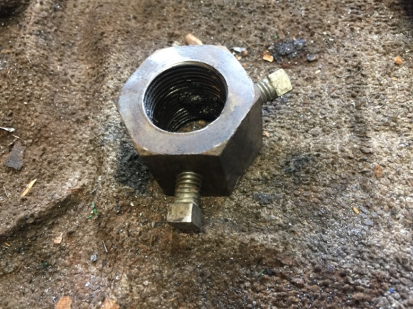

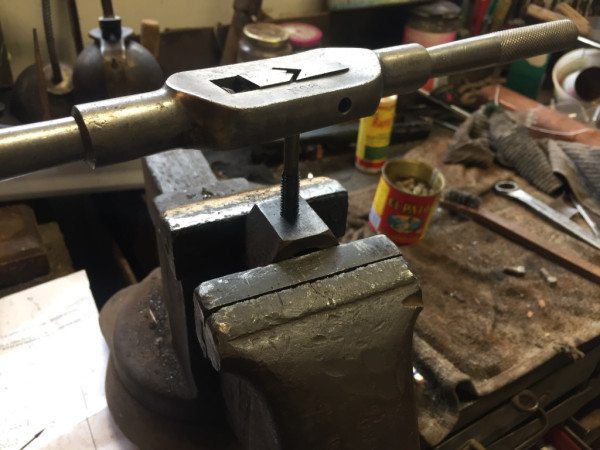

Here is the start of the collar for the handle. Keeping things within budget I started out with a large nut.
It just had to be barely reamed out with the 15/16 drill. (Actually most of the threads were left when I was done.
Then I tapped a couple holes in the side for the set screws:
Well a small start for the crank...

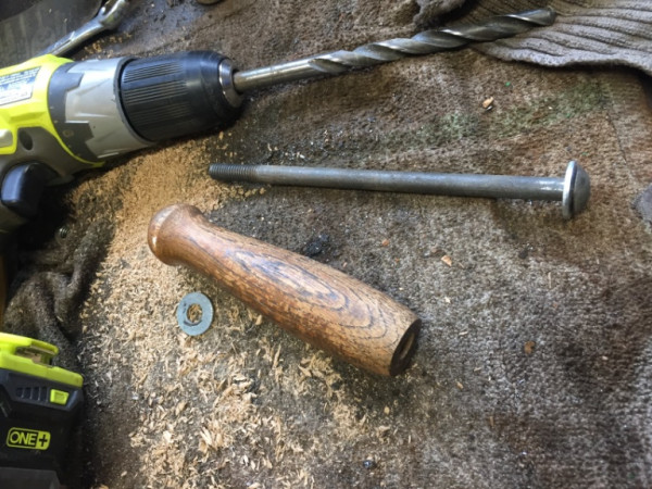

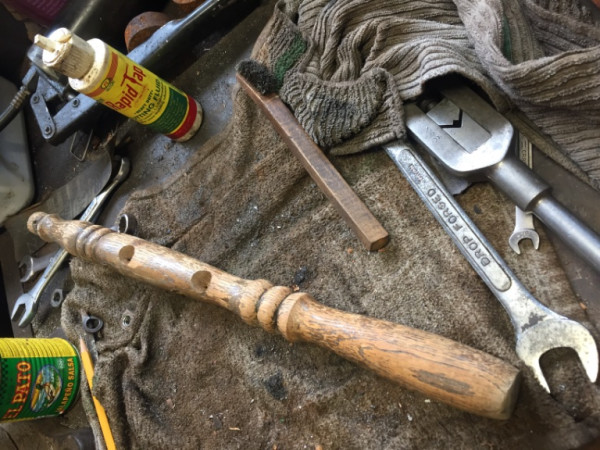

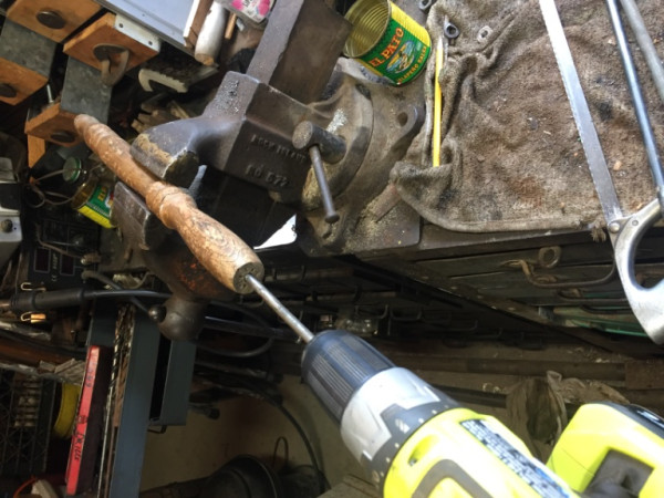

I don’t know about you but when I see a old chair leg like this I see a bunch of handles
I used the drill about halfway from both directions method. First I started with a smaller drill...
The bolt I had is actually a timber bolt, but a carriage bolt would have worked, by just filing the square from under the head. I liked that this one was not treaded up the shank.

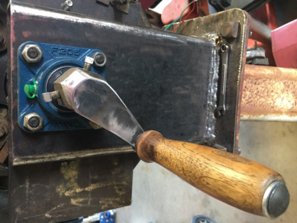

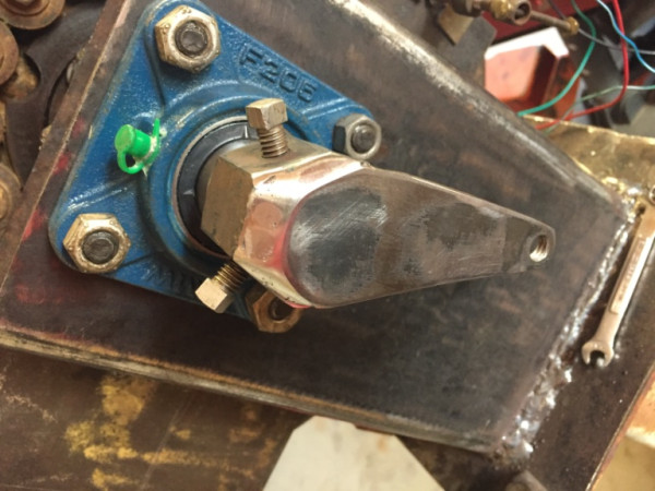

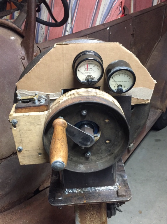

I got the handle installed:
I added graphite inside the handle. It turns very smoothly.

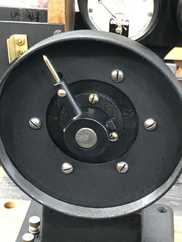

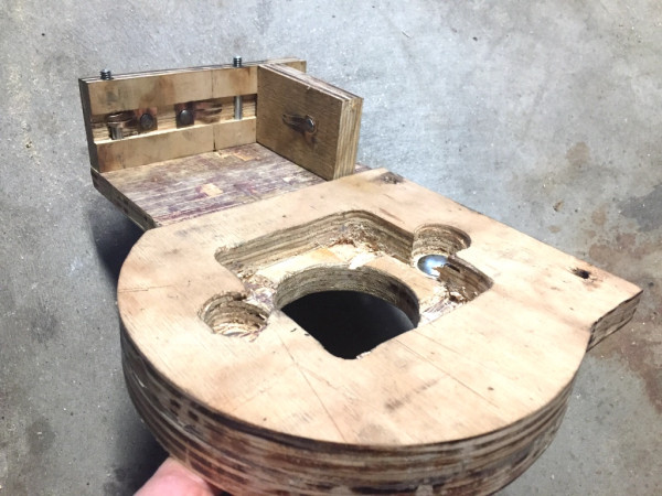

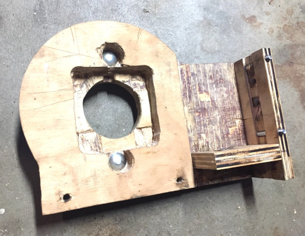

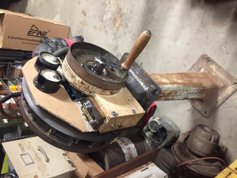

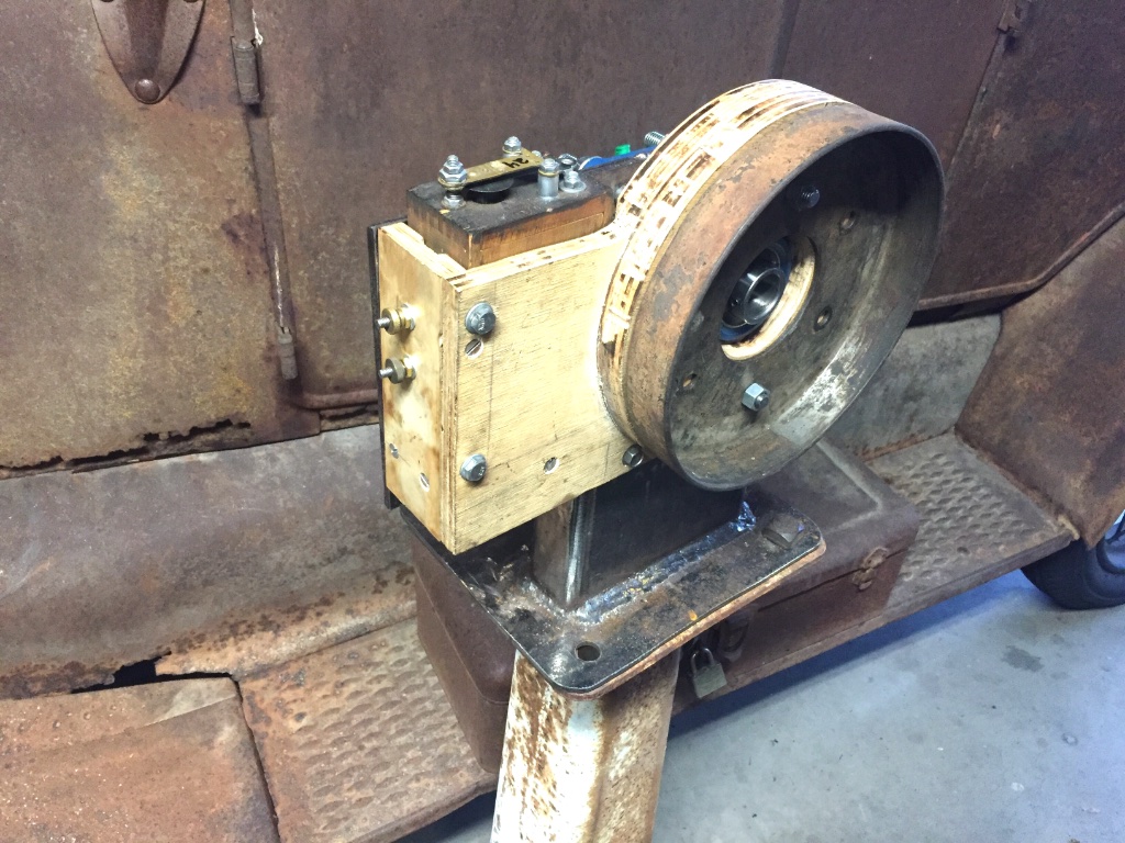

Here is what I did for a hole in the coil box and spark ring. I don’t get any extra points for ease of manufacturing/assembly.

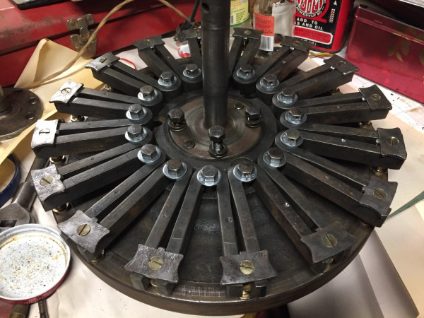

Matt,
I see you are using a brake drum for a spark ring.
Allen used a modified brake drum on some of their HCCT's.
They increased the diameter of the inner diameter to avoid the spark
from jumping to the shaft.
Here is the Allen drum.

Matt in California
Topic author - Posts: 829
- First Name: Matt
- Last Name: G
- Location: California
Bob,
Thanks for the tip and photo! I was under the understanding that the gap should be a quarter inch. With that I tried to make everything else greater than a half inch. Let me know if you see any problems with that logic.
Thanks!
Matthew
Thanks!
Matthew
Ron Patterson
A properly working Model T ignition coil should produce enough energy to jump a spark gap of 1/4 inch.
If you make the gap greater you take the chance of the coil shorting to ground inside the coil and damaging it.
With the spark ring and pointer your using you will need to keep the inner perimeter of the ring and tip of the gap clean.
These parts have a tendency to get a small amount of corrosion and needs to be kept clean. I suggest you keep a small wire brush and clean these parts the first time, every time you periodically use it. The Allen design HCCT with the brake drum/very pointed gap tip is very susceptible to this problem.
Lastly the tip of the spark gap pointer should have a rounded tip with a radius of about 1/8 inch otherwise the tip will quickly corrode and the gap will cease to be jumped.
Ron Patterson
Ron Patterson
Matt in California
- First Name: Matt
- Last Name: G
Ron,
I appreciate your insight and tips. Thanks for underscoring that a larger spark gap may destroy the secondary of the coil.
I was not aware of the needed maintenance for the HCCT pointer. It is helpful to know that the pointer should be rounded off to reduce corrosion. Is it better to use something like steel or stainless steel?
Matt
Matt

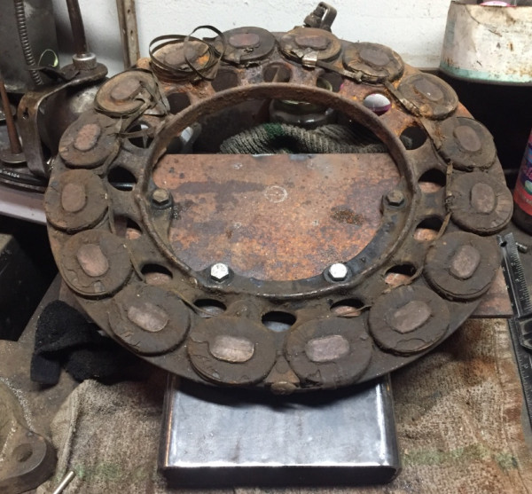

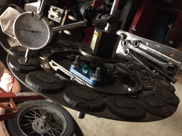

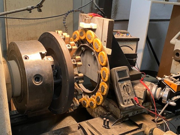

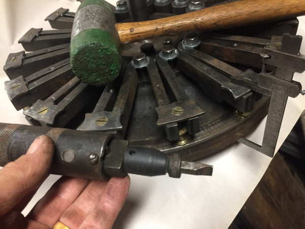

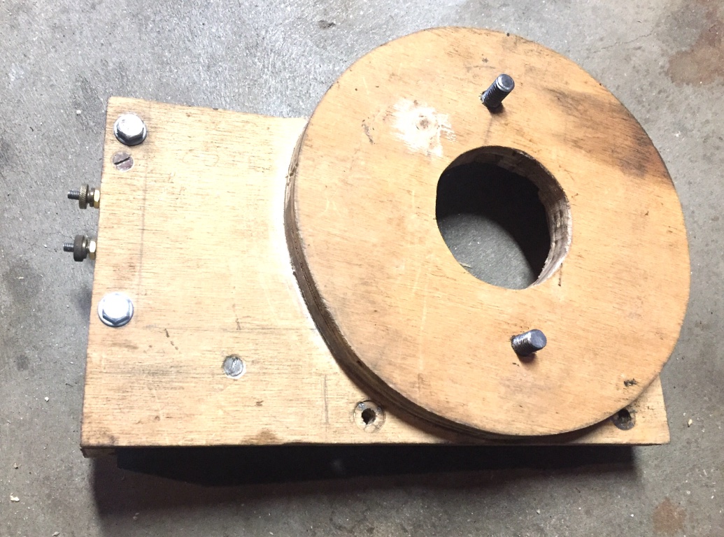

This is how I figured out how much I needed to shim the magneto coil ring: For the next stage I worked on recharging the magnets. I removed all the magnets cleaned everything up and attempted to charge them on a friends old magnet recharger system. I had a couple of magnets with Ford script on them and they seem to charge a lot better than these ones off of the non-starter flywheel. This impact screwdriver came in very handy for tightening the magnets down: I used a Harbor Freight 170 amp welder (please excuse the mess):

Ron Patterson
Matt
Perhaps you were not warned about cracked magnets?
I suspect ho had some cracked magnets? That would account for your magnets that did not recharge well.
Search this Forum for "cracked magneto magnets" and you fill find the easy procedure to check them for cracked magnets. These will need to be identified, replaced and recharged for the magneto to produce adequate output.
Ron Patterson

Adam
- Posts: 1608
- First Name: Adam
- Last Name: Doleshal
- Location: Wisconsin
Ron Patterson wrote: ↑Thu Jan 05, 2023 9:48 amMatt
AND/OR…. He has some magnets that he re-charged against their original polarity.

Ron,Ron Patterson wrote: ↑Thu Jan 05, 2023 9:48 amMatt
Ron Patterson

Adam,
I used a compass and magnetized accordingly. But when I saw the issue I reversed the polarization with the Ford Script magnets and found they still had twice the holding power (i.e. 9 lbs vs 4 lbs) of the other magnets.
Matt
Ron Patterson
It is uncommon to find a newly disassembled Model T flywheel that does not have at least one or more cracked magnets.
You cannot visually check for cracked magneto magnets.
Magnaflux and Zyglo is not necessary. Do the ring test and don't be bashful when banging one end of the magnets on the anvil of your vice. If the magnet rings like a tuning fork and doesn't break in two pieces they are fine.
It is not good practice to reverse the original magnetic orientation of Model T magneto magnets, but if your magnet re-charger can produce a full saturation recharge (at least = or > than 5000 Ampere Turns for Model T magnets) you should be OK.
Ron Patterson

Matt in California
- First Name: Matt
- Last Name: G

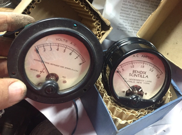

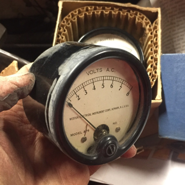

I needed to do was get the gauges. I connected with Bob Cascisa. As many of you know he restores these early gauges. He even offered me a set of panel gauges that would work at a reasonable cost. I ended up getting the following NOS gauges off of eBay:
One gauge I needed to remove the basil:
Hi temporary mounted them on cardboard for prototyping testing:
I mounted the unit on a pedestal I got at a local estate sale:
(I wish I could get this photo upright.)
Here is the breakdown of my expenses:
$5 Pedestal (Great find from an estate sale.)
$17.95 two flange bearings
$24.99 amp meter
$32.80 volt meter
$12.00 hardware (nuts & bolts)
$0 steel (got this from a friends scrap pile)
$0 Miscellaneous electrical parts came out of my stash
$$$ Elbow grease
$92.74 TOTAL
That’s far I have come in under $100, but in hindsight I now understand why something that is over $1000 can still be worth it! This took a lot of time.

A quick update:
My first test of the HCCT. I was using a rebuilt coil that I had on the shelf. The gauges were jumping a bit and the current was over 2.0 amps. I was’t sure what was wrong so I put the coil in the FACT unit that I built, saw the cushion spring needed adjustment. Placed it back in the HCCT and the gauge movement smoothed out and it read a little over 1.3 amps at 6 volts.
Initial observations:
1. The HCCT is up and running.
2. I really had to crank the HCCT to get it up to 6 VAC. Maybe the issue is weak magnets.
3. The FACT unit is a great alternative to the HCCT. The live o-scope feature maybe even a lot easier to tuning a coil. It also is about 1% the weight.
Matt
