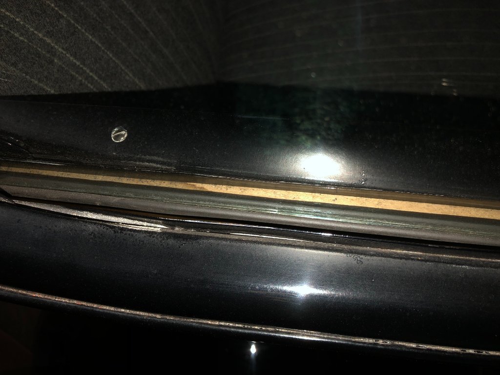

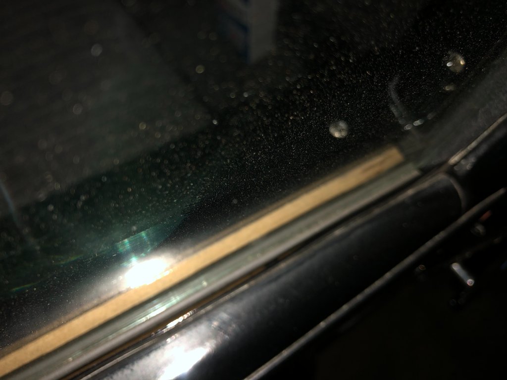

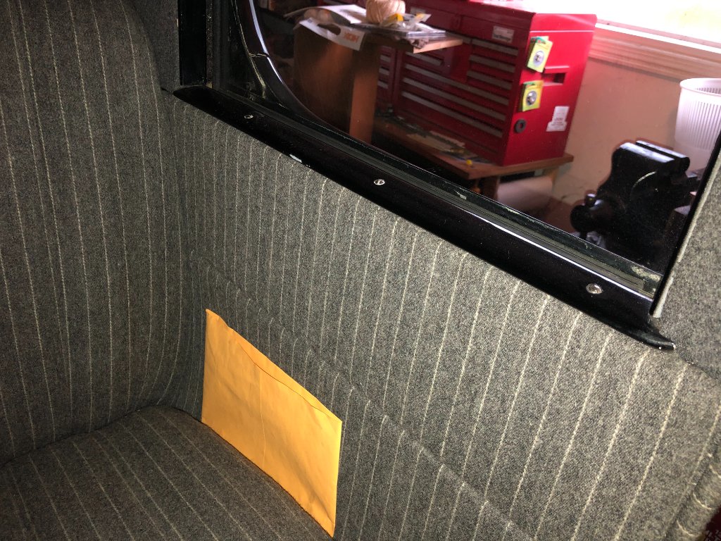

Here is what the window frame looks like. Almost as if someone decided to modify the windows so they would be fixed glass versus functional.
