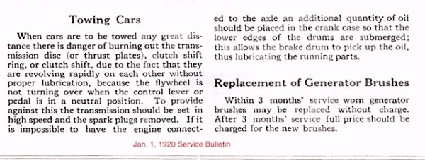

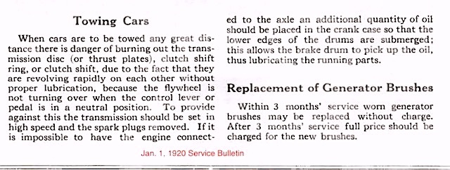

Ford gave service agents these important instructions on flat towing a Model T on all 4 tires.
Note: the instructions seem to have a misprint, as the safer method is to disconnect the drive shaft from the rear axle, so it won't turn the engine. If that can't be done, then the instructions seem reasonable. However, be reminded. the towing speed was very low back in the days, as likely a TT was doing the towing. Any speed above 5-10 mph may be real trouble.
