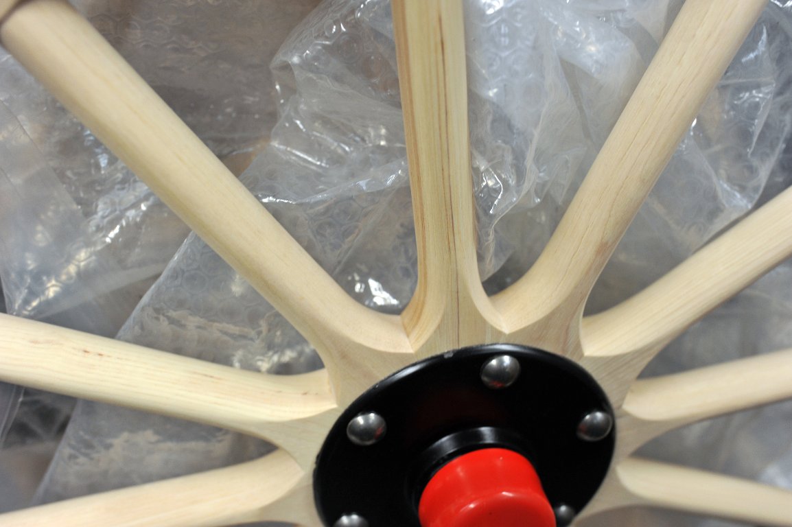

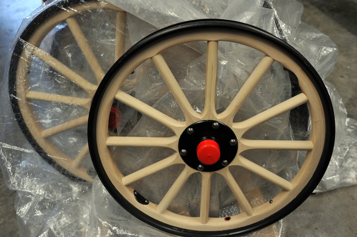

Looking for some advice on mounting tires onto my clincher rims for my 1912 Roadster. I searched through the archives and found all sorts of information but thought it might be time to get some "fresh" advice. I had wheels rebuilt by Stutzman using new rims (see pictures). My immediate questions are:
1. Would you advise mounting the tires first before painting the wheels? Obviously that would be quite a bit of masking but given the horror stories about mounting these tires I wonder if that would be the thing to do to avoid chips in the paint.
2. What about tire flaps? I have some but are they needed when I have nice smooth rims versus old rusty rims. One benefit I can understand is they can help avoiding a tube pinch/puncture during mounting.
Then I see there are all kinds of tricks to help tease the tire on the rim, from baby powder to non-pumice GoJo. Like I say, I know this issue has been discussed and re-discussed but I welcome any "fresh" advice.

The wheels look great. Any chance you can tell me who re-spoked them?
- Posts: 8510
Re: Mounting Tires on 1912 Clincher Rim Advice
Any paint on the wheel rims is likely to get some damage if you drive the car. Using enamel on the rims will give a good finish and allow for touch ups.
Distagon2
Noah Stutzman in Baltic, Ohio did the wheels. I am extremely pleased with his work.

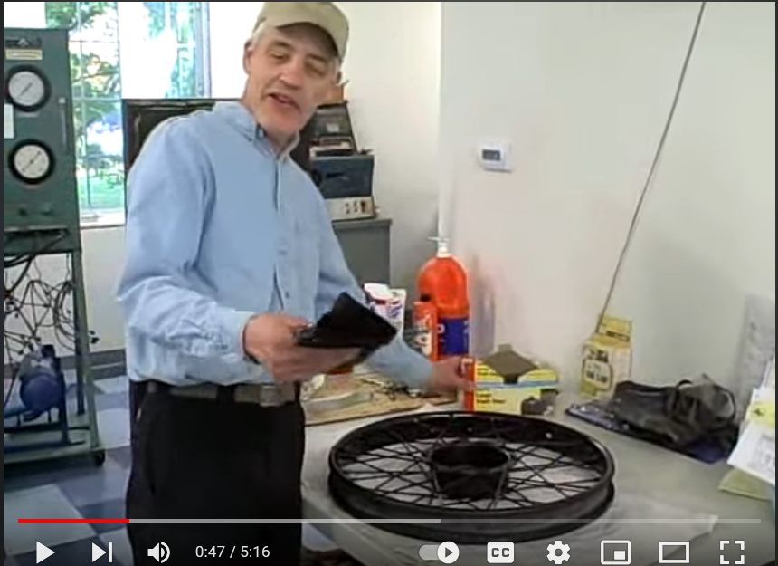

A very controversial approach to mounting a tire on a clincher rim without tire irons https://www.youtube.com/watch?v=P6sH8WR ... eRefresh=1
Worth a try anyway....
KimDobbins
- Posts: 1685
- First Name: Kim
- Last Name: Dobbins
I rarely go to Harbor Freight and have never recommended anything they sell.that being said, they sell 24" tire irons that perform well and are cheap!

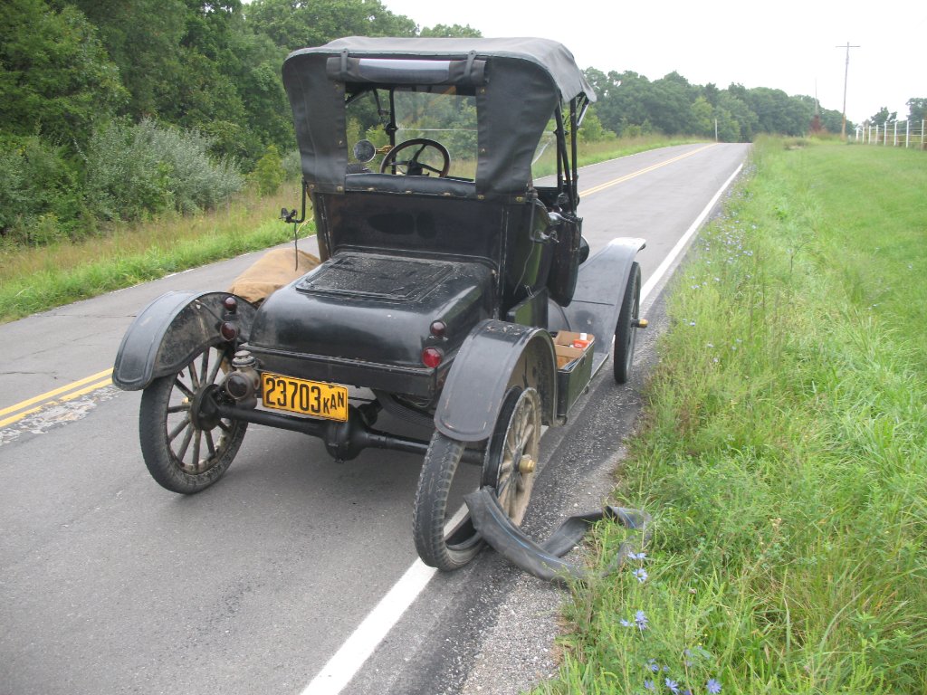

I have found, especially as shown in your picture, the job is a snap.Steve Jelf wrote: ↑Tue Dec 27, 2022 11:58 amThree tire irons and two people work the best...
True, but if you're new to this game don't get the impression that doing the job solo is murderously difficult. Very seldom have I ever had any help with a tire change, but with long irons and a bit of experience I don't find it an arduous challenge.
You have a lot of good going on.
The tire is pre-streched & warm & the wheel is held in a good position to work the tire & new tube back on.
