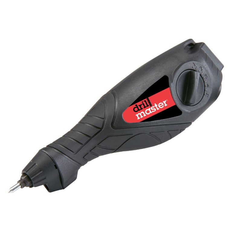

I installed 6 oz of balance beads in each tire....they do the job! Laying the tip of a vibrating engraver to the side of the valve stem and you'll speed the process dramatically. Took me 8-10 minutes per tire.

You mean engraver, Tim?
