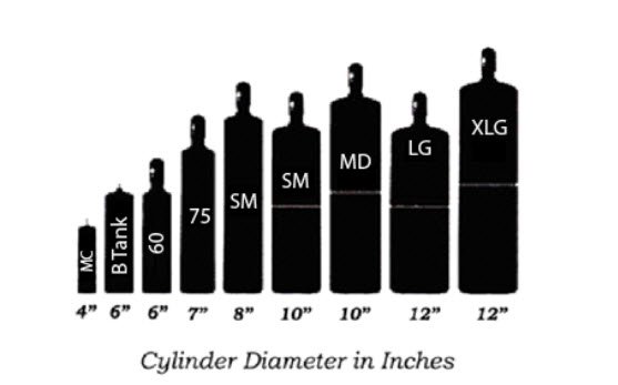

Most industrial gas suppliers have "B" bottles available. They also have "MC" bottles which are much smaller. An MC bottle will fit under your back seat.

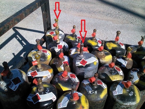

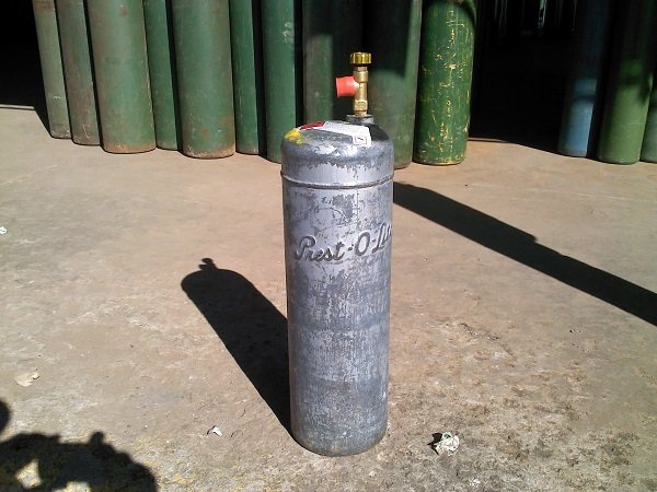

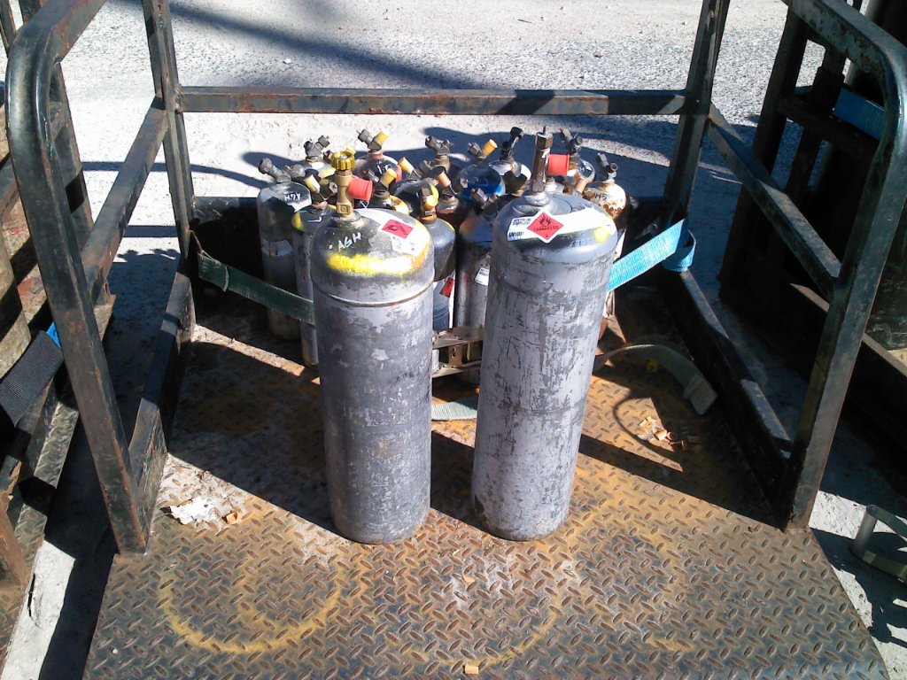

You can still find Prest-O-Lite "B" tanks with the off-set valve. These you
may lay on their side as Wayne says with the valve "up" on the running board.
They do not have the "pressure valve gauge" in the bottom which precludes them
from being filled today. There is a plug where the old "Prest-O-Lite Tank Pressure
Valve" was.
I have found these "more modern" Prest-O-Lite Tanks mixed in with the regular center
valve "B" tanks at both my AirGas and Praxair supply houses. You have to look carefully
to see them when they are mixed with the regular "B" tanks.
Below is a batch of "B" tanks that were at my local AirGas Welding Supply. There were two
Prest-O-Lite off-set valve tanks mixed in. Two arrows. I like the "coarse" knob style
valve because I don't have to fiddle with a "key" to turn off the bottle and it closes faster.
I use a small regulator. Those who "crack" the valve will probably like the old style valve.
The acetylene tanks in my area of Texas are filled about sixty miles from me and I discussed
these tanks with the manager a number of years ago. They replace the old style valves when they
fail with the coarse style with the knurled knob. He said the Prest-O-Lite tanks with the pressure
gauge fail almost every time in the bottom where the gauge is. As long as the POL tests, he fills it.
I keep one on the car and another as a spare to exchange when I find another one.

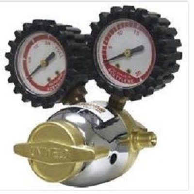

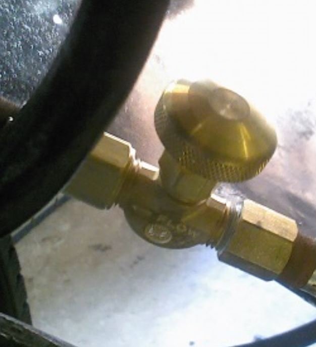

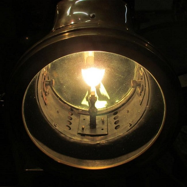

Jerry,
I use a small Uniweld Regulator on a Prest-O-Lite "B" tank.
I'm sure the welding supply can set it up on a Motor Cycle tank.
I set it to about 4 to 5-psi. Then the small Radnor acetylene valve
(located between the radiator side panel and each headlamp)
allows you to set the flame right where you want it on each headlamp burner.
There is only a short piece of acetylene hose between the Radnor and burner base.
Once you set the flame, turn the headlamps "on/off" by opening or
shutting off the acetylene tank. Makes it real easy to light up without
having to set everything again.
Keith made the best photograph of a lit headlamp, see below!
That is what you are looking for....
Just set the Motorcycle Tank valve "up" to keep the acetone out of your
small regulator. They were made to lay horizontal across the handlebars of motorcycles.
Most supply house folks don't know why they are called MC tanks or B(us) tanks.

Bryan,
If your local gas folk won't fill and return your offset B tank, I'd suggest to ask them to notify you when one comes in. Maybe they will, maybe they won't, but it wouldn't hurt to ask.
I have a B tank on my car that has a brass "collar" near the neck that has a Prest-O-Lite logo on it. I took it to my local gas dealer to be filled, and specified that I wanted that particular tank back. They called when it came back in filled. I was devastated when I picked it up and saw the brass logo was gone! I check the numbers and it was the same tank. The guys at the shop knew nothing about the brass logo.

Seems I remember there was a orifice made in the fitting that screwed on to the tank that set the flow to the lights? Have not seen one in years. Dan

Thank you Keith T for the draw-down cautions and experience with the MC tank.
Also, DO NOT enclose these fuel tanks in tool boxes, non-working carbide generators,
under touring car seats, or any other enclosed or poorly ventilated areas!
Keith T's last post at 10:00 a.m. is spot on.
I went by Airgas this morning and he only had eight regular center valve "B" tanks.
He said he had several Prest-O-Lite's last week or so but if I would leave my number,
he would pull one when Western International Gas makes their next delivery of "B" tanks
with a Prest-O-Lite in it. He also offered to chase one down for me using the picture
I posted above in this thread of the Prest-O-Lite tank. Western International Gas is an
acetylene filler and supplies all over the U.S. and currently are filling them.
While at Airgas, I checked today's cost on acetylene tanks, refill charge and both include tax.
