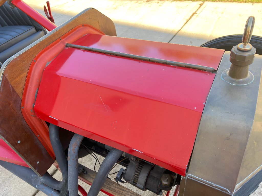

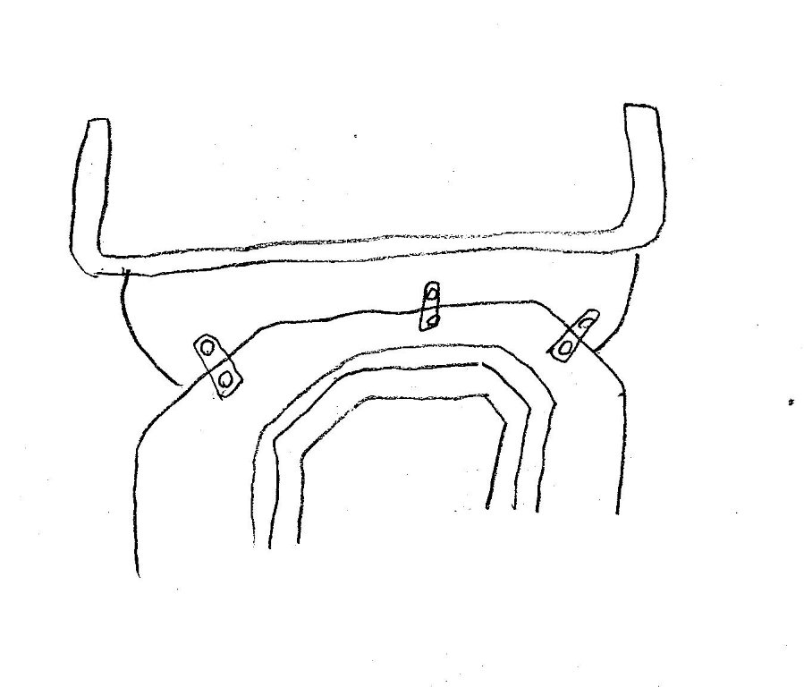

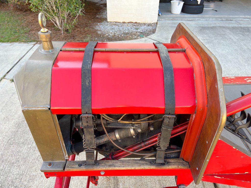

I am in the process of buying a 1914 Speedster that was built by a Ted Oney in Oklahoma. That car has the original monocle windscreen. I want to fit a full width windshield, preferably one piece. The firewall appears to have been customized: not sure. Anyway, I have attached two pics and wonder if anybody has an ideas for installing a windshield. Thanks! Bill

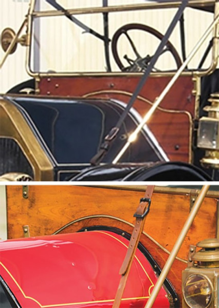

I would think that firewall would want something like this to give a little more support. It may need support rods.
"Just Sayin".

Richard has the right idea - either utilize the original '13 - '14 w.s. clamps along with additional supports (homemade & longer) for placement at the lowered corners of that firewall OR replace with a stock dimension firewall.
Obviously, that firewall was "clipped" to emulate the shape of the brass radiator.

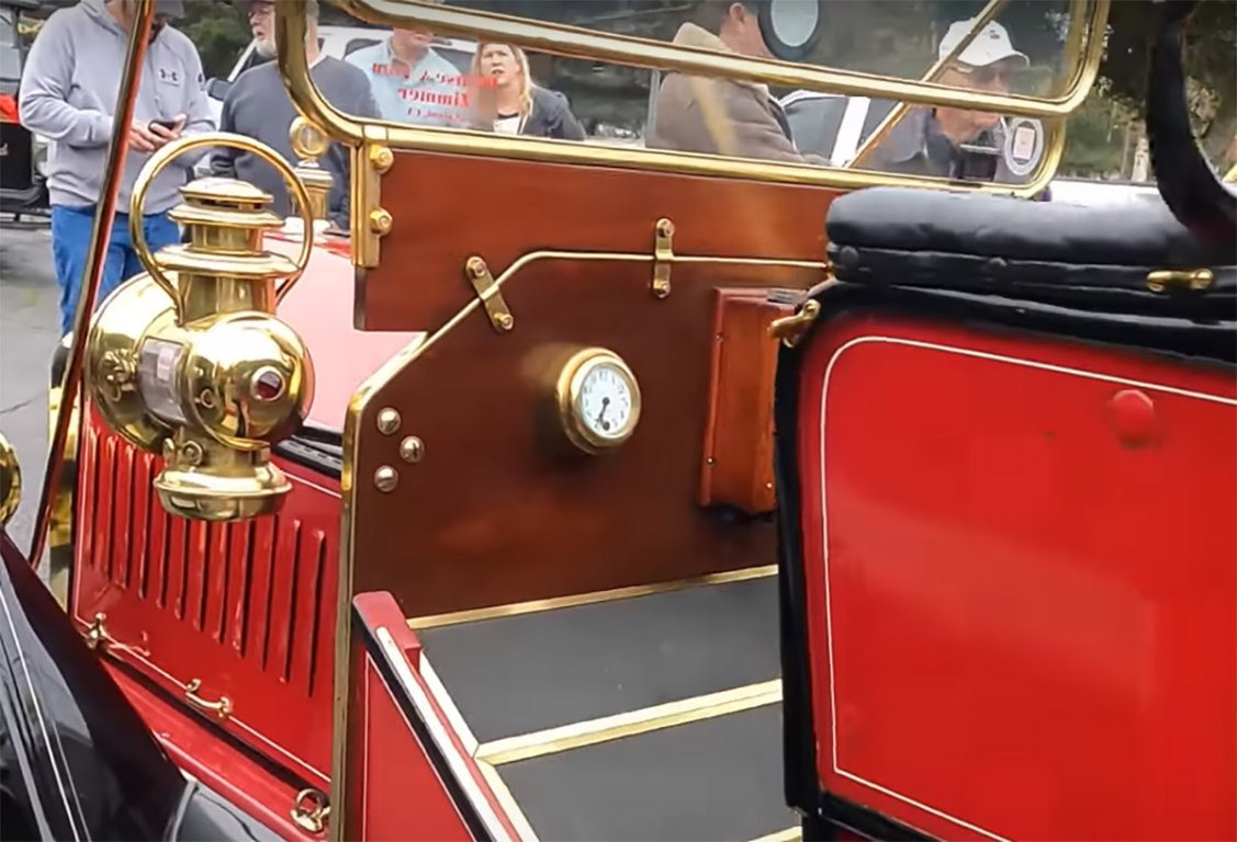

Re: 1914 Speedster windshield
This might be a good design.
It was on the HME video Tim posted.

William, can you give us some details on the car? The three exhaust pipes on the right and plug wires on the left suggest a Frontenac head.
brasscarguy knows his fast T stuff. If he says it's fast and loud, I believe him!
That car posted by Rich looks very nice and may be my easiest solution. Whose car is it? Bill
