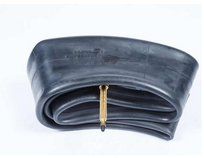

Has anyone fitted these two there Blockley's inner tubes? are they suitable with the 30 by 3 and half inner tubes? https://www.modeltford.com/item/DC1.aspx

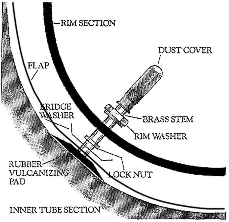

those covers do not screw onto the tube stem
they screw onto the rim nut, which WILL screw onto the tube stem
you need both...look closely at the notes on the Lang's ad
if you have any further questions, call Langs, ask for Steve, and let him assist you in getting exactly what you want and need

picture from Lang's link
picture from Blockley
Blockley tube.png (130.83 KiB) Viewed 3551 times

Read the notes on the Blockley website as well… I recall reading something about not using a bridge washer as the stem is vulcanized into the tube…

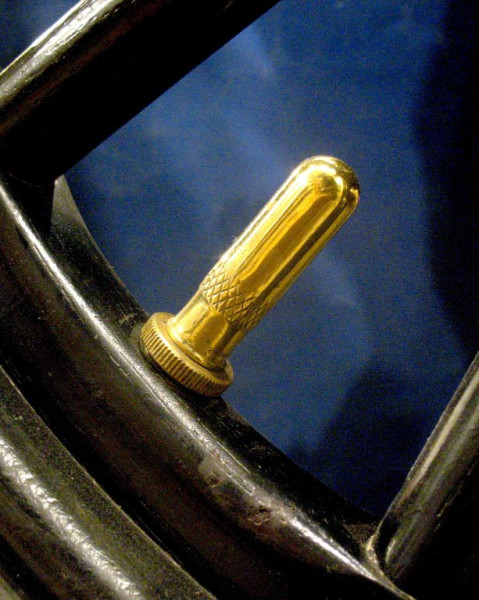

Some dust covers screw onto the rim washer and some screw directly onto the stem. All of today's metal stem tubes use the larger sized stem not used by Ford. I believe all the reproduction dust covers are made to fit that larger sized stem.
This reproduction cover is an excellent copy of originals I've found at Hershey.

The reproduction dust cap posted by Steve Jelf is an original.

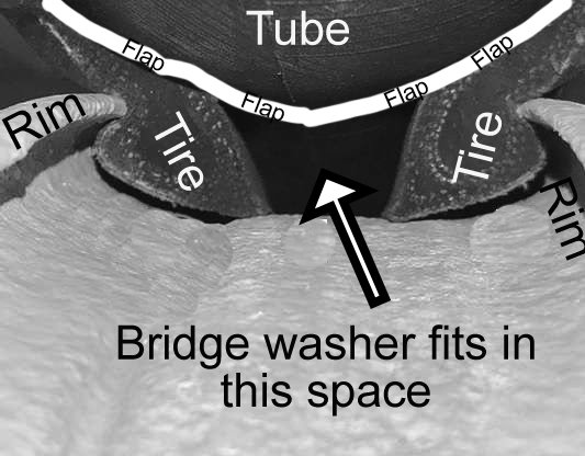

Flaps protect the tube from contact with the rim. Flaps will not form a bridge above the beads creating or maintaining a void. Air pressure from the tube forces the flap into the space. Yes the bridge washer keeps the valve stem base from sitting in this area shown as a "void"
I question the langs depiction of the bridge washer UNDER the flap.(between the flap & tube) I have never seen a tube/flap installed this way. Normally the flap goes over the bridge washer/tube. The flap gets stuffed into position after the tube is in place.
Am I wrong about this??

Langs picture shows the flap against the tube & the bridge washer on top all held together with the lock nut.
Is that right?
I also question Jerry's portrayal of the flap not conforming in the gap between the beads, but creating a bridge & empty gap between the beads.
Posts: 7248
Re: Blockley's inner tubes
Post by Allan » Fri Dec 30, 2022 5:12 pm
The flap does indeed get pushed down between the beads, hard against the rim. That is what 60 lbs of pressure will do. I believe the correct installation of the flap does not have it fixed to the tube by the bridge and nut. The tube goes in the tyre and the flap folows, if you have the money to waste on flaps. A rim liner will suffice.
