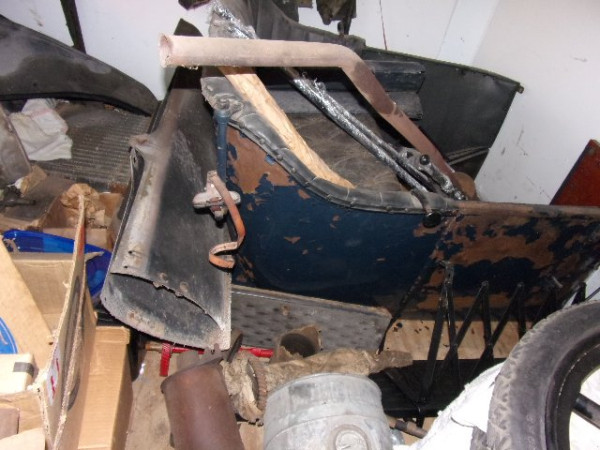

Original Ford factory paint doesn't peel off in sheets. That's a sign that it was most likely painted with lacquer which, years ago, was a popular choice for hotrodders and antique car hobbyists who did their own paint work because you could repeatedly paint and buff as many coats as your heart desired and end up with impressive results. However, lacquer can be prone to checking and peeling. It can typically require periodic buffing and waxing in order to keep up appearances.

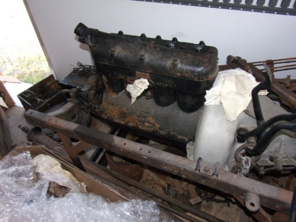

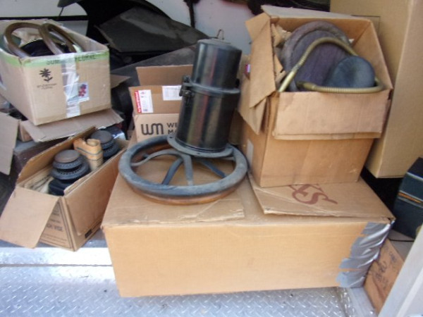

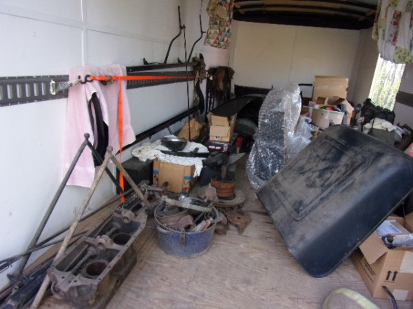

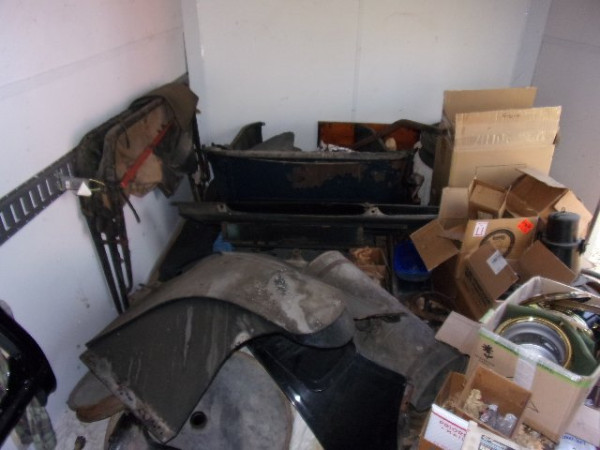

Decided to revive this thread since I finally got the car home. I don't have room for it inside so it'll have to live in my trailer for a while. Had a model T friend over yesterday and we found 99% of the correct 1914 parts for the car among the plunder. I need to decide if I'm going to keep it or not as i need another project like I need a hole in the head! I am growing quite fond of model T's however and am excited about the prospect of finishing it. I also have a '31 Model A DeLuxe Roadster. One of them will need to go, I just need to decide which.
Also a correction I need to make from an earlier post. The car has a late October casting date on the engine, not November.
