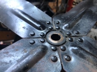

Fan hub bushings
Post by Rich P. Bingham » Mon Jan 02, 2023 1:59 pm
I have some notions on changing out the worn bushings, but I'll bet our members can offer some valuable tips ! 1916-20 (?) cast iron hub. Thanks, fellows !

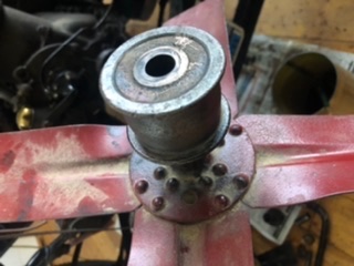

And the front :

A pipe tap threaded in either end then tap out with a drift.
Posts: 7248
Re: Fan hub bushings
Post by Allan » Mon Jan 02, 2023 4:06 pm
Some I have seen have been soft soldered in place, presumably because the bush was not a good fit. A little heat may be in order while driving on the tap.
Posts: 3018
Last Name: House
Post by George House » Mon Jan 02, 2023 7:42 pm
They’re very easily driven out with a 3/8” brass punch since they’re dissimilar metals with no rust. I keep the old bushings and cut them about 1/8” beyond the flange. Needle bearings are controversial with this crowd. I use them with no problem on all my Ts then reinstall the cut off bushings....Original will disagree 😞
