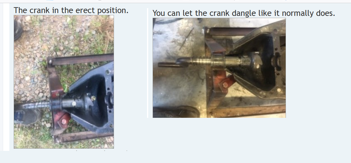

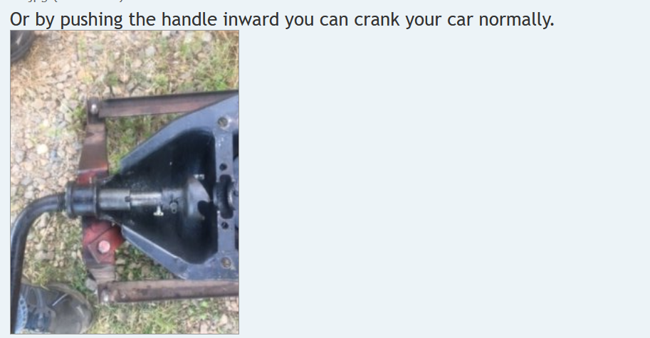

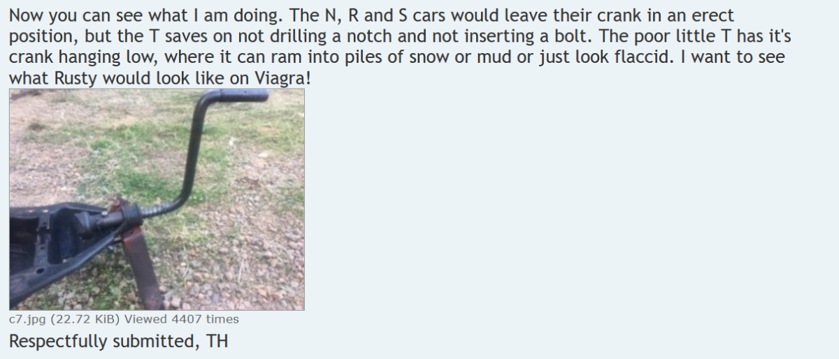

This is it by Thorlick » Mon Oct 14, 2019 1:36 am
https://mtfca.com/phpBB3/viewtopic.php?t=7524

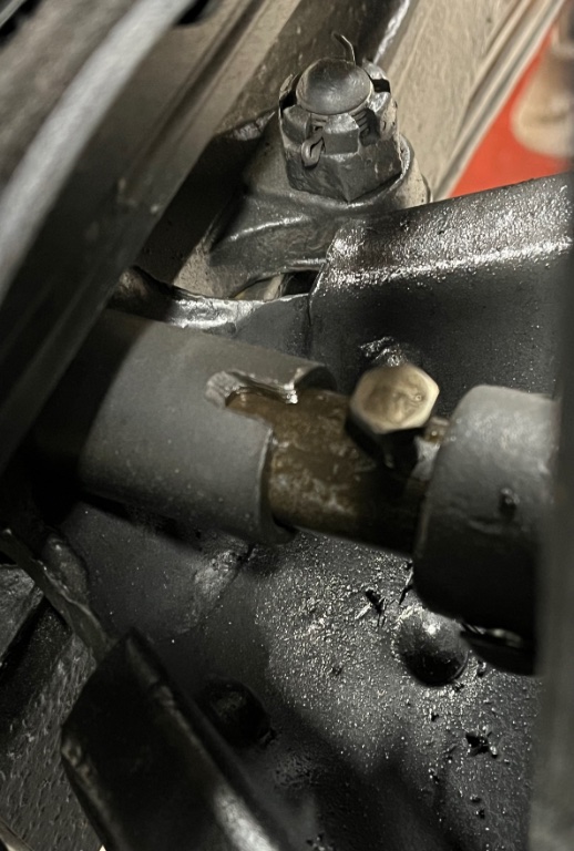

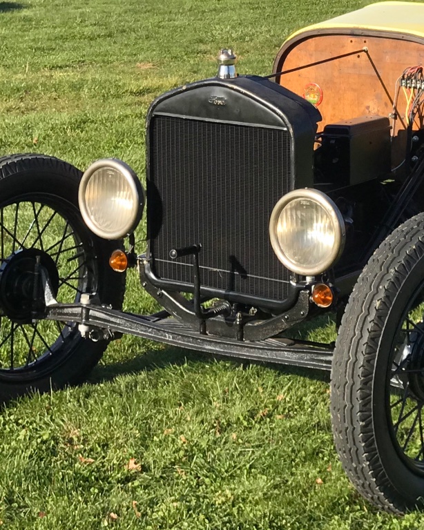

Here is a close up of the hand crank on my speedster. I drilled and tapped the hand crank for a #10-32 bolt and cut a notch in the hand crank bushing that presses into the front of the pan. The hand crank spring keeps tension on the hand crank and holds it into the notch. I’ll post a better picture when I get back out to the garage.

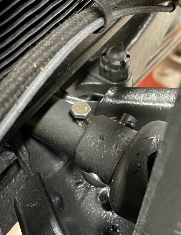

Here are some more pictures of how I did mine.

Thanks for posting pictures. Dan
