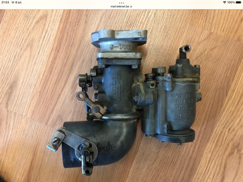

The first one: Putting a FRONTENAC head on a 1925 engine and make it run as it should be.
A while ago I found a Frontenac head and Winfiekd carburetor, now I am willing to set them on a 1925 engine.

Looks like a great start to me! Hopefully the head has no major repairs needed, and the carb looks to be in runnable shape too.
What is the serial number on the head…? There should be a “T” or “R” stamped before and after the number. “R” heads are high compression, and may be adequate compression ratio already. “T” heads will be equivalent compression ratio to a stock flat head, pop up pistons would be nice.
There are adapters available to convert your carb to a sidedraft for easy installation, or you can build an elbow. Check the serial number in the carb bowl, it should read SRBB ”U” XXXX. The “U” designates updraft. Either updraft or downdraft bowls can be used as sidedraft.
