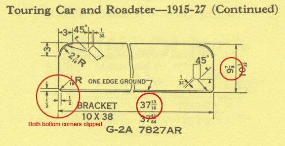

I need an upper windshield for my 1919 Touring (if anyone has one available) and have found the attached pattern. The original glass is broken and wasn't cut right to begin with so I plan to have one cut to the pattern specs. The glass cutter assumed the radius of the rounded corners is 2-9/16" while to me, it looks like the drawing says it's a 3" radius with some sort of edge work like a chamfer. Anyone know for sure... or have glass ready to go?

As a former draftsman, I would say the 2 9/16ths is the radius to cut the glass and the 3" is the start of the 1/32" chamfer.
If you are using the brass setting channel, caution the glass fitter to smooth the glass edges carefully. I have broken a couple windshield and found them rough there.

yes, yes, and yes
Matt
let the glass guy do his thing...between him and the drawing and having the channel as a double check, it falls on him to make it fit. Rich's advice on smoooooothness is an excellent one.
yes, yes, and yes
Matt

Some glass fitters will not use the nickel plated (brass) channels for various reasons. Some will say the glass won’t fit right and etc. If the glass shop won’t use them find one that will. If you still have your channels they will clean up nicely with polishing cloths. Do it before the glass is installed. You can do it after but it takes longer to do it. A windshield really stands out with cleaned up window channels. And it makes for a neat looking job where that detail stands out.

Many thanks for the responses. It looks like 2-9/16" is the radius then. I am doing this mail order because there is no local glass place and the glass cutter won't have access to my frame so anything I can do to make sure it's cut correctly.
