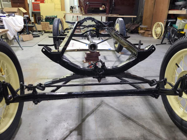

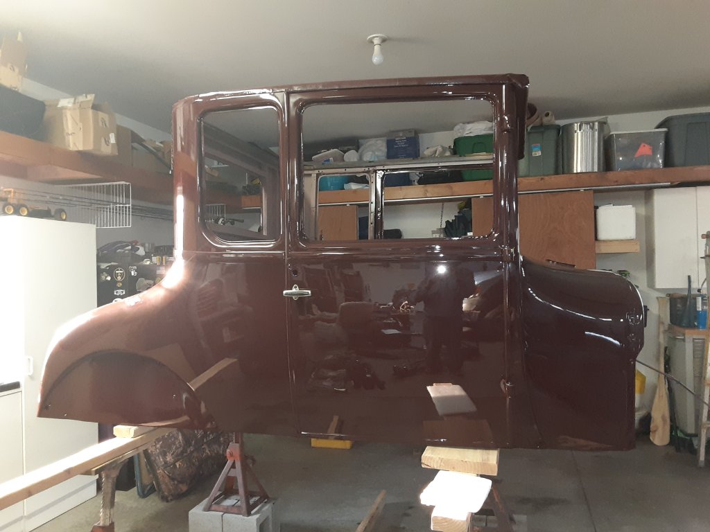

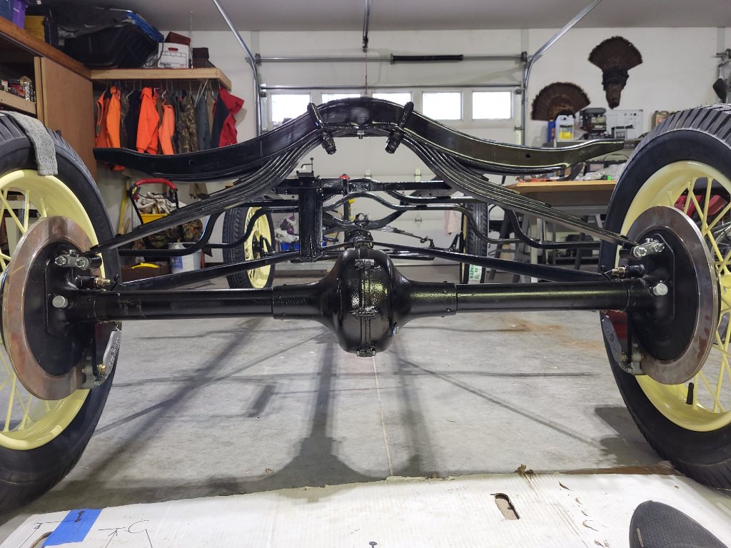

Photos were taken before the engine was installed.

Jack in the middle of the front axle to position casters under both front wheels but jack on both axle housings to individually place your casters under each rear wheels. . But I’m with Allan. More fun with friends lifting...
Re: Locations for Jacking on a Model T
They tell me the jacks are best placed as close to the wheels as possible. Some think there is danger of bending the rear axles.

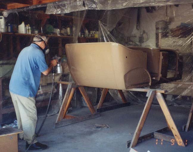

When I had my body off, I made two sets of stands out of 2x4's . They had three leg stands and a cut out to fit one 2x4 across. It just sat there without being fastened in. They were high enough and spaced far enough apart that the chassis could be rolled under with the body on top. In fact I could even put the chassis under with the engine in place by turning the body around opposite the picture and push the chassis in from the front. If you put one rear wheel on loosely without the key it will push easily then when you are ready to drive, you put in the key and torque the hub.
I could paint the body in this position and even crawl under and paint the under side of the body this way. When you are ready to lower to the chassis, you merely lift it up enough to remove the cross 2x4 and set the body down on the chassis.
