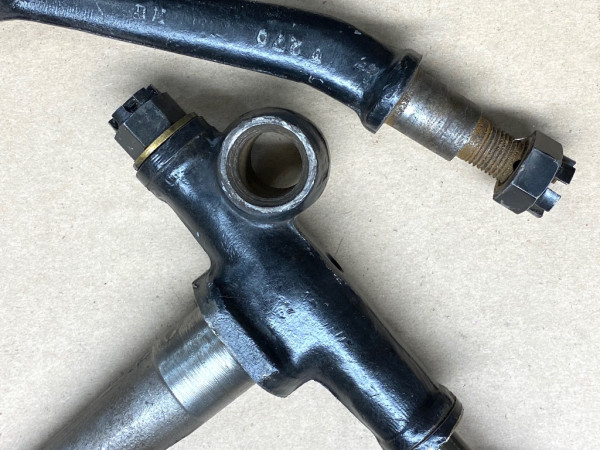

I'm helping a friend with some 1911 touring front end repairs. We found the left-hand spindle arm loose in the spindle bore — still nutted and cotter-pinned fortunately, but rattling around and the nut not even finger tight once the pin was pulled. Yikes!
Upon disassembly, we were puzzled: the arm is 0.740-0.742 OD but not visibly worn, and the spindle bore is 0.750-0.752 ID and again not visibly worn. Bottom line there is 0.010 clearance which is surely not needed and surely can't be correct. The spindle bore is clearly countersunk but there is no corresponding fillet on the arm (photo 1 below).
Looking in my parts stash, I have several later, curved, arms, all with a bit of fillet on the arms and all loose in their bores, although less than the 0.010 of the arm in question. I have only one earlier, straight, spindle arm and spindle. It too has no fillet and is also loose in the bore but only by about 0.005 (photo 2 below).

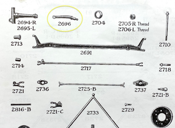

The purported 1911 arm is marked "T 270" and also with what is probably "DB". My straight spindle arm is marked "T 270" without a DB. The MTFCA Axle book illustrates typical 1911-1919 front axle parts and identifies the spindle arm as "2696" (photo 3 below).
My questions:
— Despite the variance in part #s, are these T 270 DB or T270 spindle arms correct for a 1911 touring?
— Is it typical to see a 0.005-0.010 clearance between the spindle arms and spindle bores?
— I'd like to add a bit of weld to the spindle arms and shape it down to a clearance fit into the spindle. Advisable or unnecessary?
— Alternatively, or as well, I'm tempted to dish the end of the spindle arm nuts to nestle into the spindle countersink and help centre the arms in the bores. Again, advisable or unnecessary?

Not an expert here, but... . The spindle has flats, so is much later than 11. The flats were added for the tapered timkin bearings.
Secondly, the side where the nut goes has no chamfer/countersink. The chamfered side is for good clearance for the arm. Dont dish the nut.
Are the threads correct for the side you have? Could you have a later, wrong side spindle?

Couple things. I like your idea of welding up and turning down the db spindle arm to fit with minimal clearance. I personally would not modify the spindle nut. It's not necessary. Besides, the spindle body is later than 1911. Try to find one where the backing lip that seats the inner race is round as opposed to having two opposite sides squared off.

Yes, that spindle is 1919/25.

Speedy: Oops, yes, brain fart my end, the countersink is NOT on the nut side. I double-checked both spindle threads... they are correct, but the spindles were mis-labelled — the one in question is the RH spindle not LH.
I'm still curious if the 0.005-0.010 diametrical clearance with these parts is typical, or perhaps the result of mis-matched years?
Good to learn about the earlier and later spindles. The other side has the earlier style without flats. There may be little appetite for sourcing an earlier, correct-year spindle if the one under discussion can be made serviceable and safe. This car is a year-round driver, very reliable and presentable but not a show-piece. Photo below was taken last week. We like to get out at least once a month thru the winter.

The .005-.010" fit is uncharacteristically loose. Been run with a loose nut quite a while. Normally they need to be pressed or tapped apart. Since you dont have a correct early spindle, I would look/advertise for a 19 & earlier spindle. (no flats) The flats make for much easier Timkin servicing/replacing. Having the flats is a big sign flashing "not correct" on a brass car.
But any pre 26 spindle for the correct side in good shape would be an improvement & not expensive, if you determine it has the wear.
Going back to your first post, dimensionally, I believe your arm has the wear problem.
