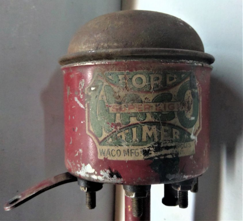

Does anyone have any advertising or literature on this timer? I do not see much advantage to using one of these except for easier access to the roller. I am just going to use this as a shelf item. But would like to see some literature of the companies claim of advantage. This one does not show to have been used very much. Any literature and/or photos would be appreciated. Thank you

The label says Ford super eight timer. Waco Mfg. Minneapolis Minnesota.
Even though it says super eight, it is still for a 4-cylinder engine.

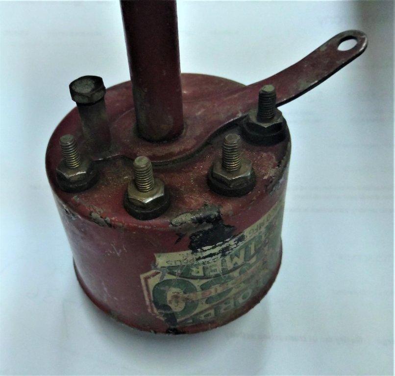

This only has places for 4 plug wires. And this fits a T. This is why I am wanting information and literature on this. John has some information posted above. Maybe this helps some.

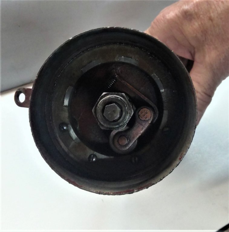

I would be inclined to see if the 4 feed-throughs actually connect to to 4 discrete contacts each at 90 degrees to each other. From pictures, it looks like the contacts are 4 in a row across a 180 degree sweep, with 180 degrees of rotation totally dead with no contact hook ups for those 4 contacts. This thing may not be what everyone believes it is.
from the name, to the apparent variability (rotationally) of where the thing can sit against the engine, to the lack of traditional stabilizing mounts at its base, this thing is certainly an oddity

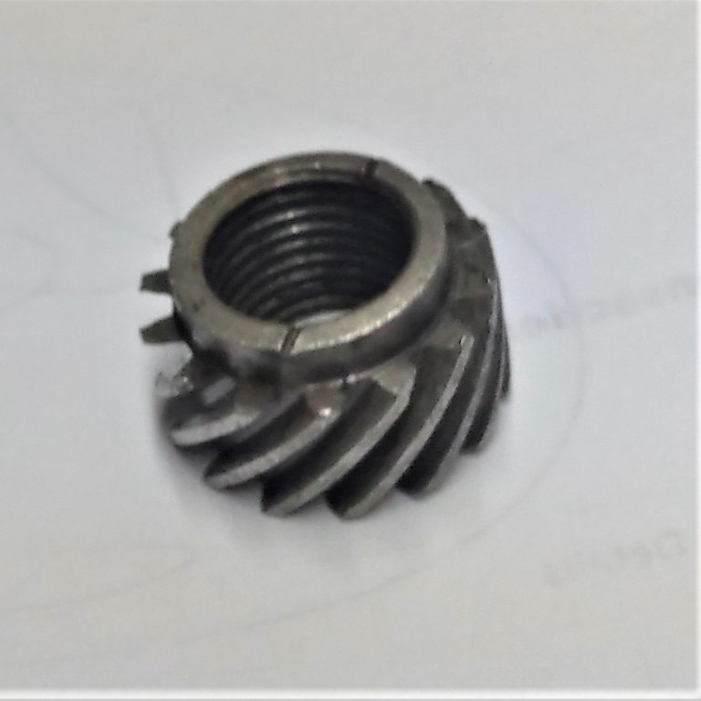

Scott, you are correct on the contacts. I just tried the drive gear, and it screws right on the end of the T camshaft. This fits perfectly on the end of the T timing cover. And why would they have called this a super eight? This also has a patent pending. So, I have no date to research the patent.

Maybe the contacts are arranged so that the plugs are meant to also fire on the exhaust stroke, as a way to burn off oils and carbon. Can you do a continuity test to see if each terminal is connected to 2 contacts?
- Posts: 4450
Re: WACO Timer
That timer won't fire 8 plugs, neither in pairs* nor in any sequential firing order.
*Unless each of the 4 terminals fired 2 coils, in an 8 coil system. But even then, that still wouldn't explain 8 contacts.

Continuity test shows that it fires on 2 terminals. Each opposite of each other.

Could it be that the ratio of the gears makes it rotate half the camshaft speed ? The teeth on the gear shown seem rather steep ? In effect it would fire each cylinder twice in one complete revolution of the roller but with two revolutions of the cam shaft and four revolutions of the crank shaft.

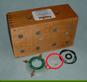

- Posts: 6575
Re: WACO Timer
Right on! It is a Wasted Spark design just like the True Fire system (coil box & timer). The True Fire Rotor had two opposing contacts so it could fire the primary cylinder on the compression stroke (for example cylinder 1) and its complement on the exhaust stroke (#4).
The concept behind a Wasted Spark.... well read all this https://en.wikipedia.org/wiki/Wasted_spark_system
The name Super 8 relates to the 8 contacts & a single flapper (functions the same as the True Fire). Note also that the contacts are on the underside of the unit likely to reduce exposure to the elements

If the contacts opposed to each other share continuity then I would suspect that the timer itself runs at 1/2 speed. Perhaps the thought was to minimize wear and thus somehow boost performance. It's rarity would indicate that the designer was probably wrong.

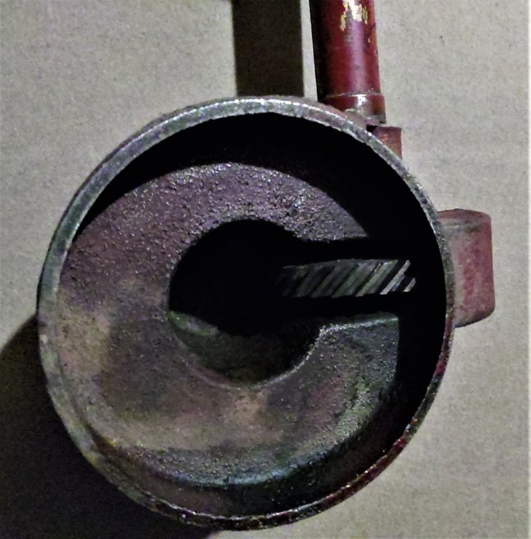

Given the shape of the lower housing, it does appear that there might be room for a distributor shaft gear with 2X the number of teeth as the camshaft gear. I'd think it might have been easier however to adjust the helix angle of the gears to achieve a different ratio. The gear shown appears to have a 45 degree helix. Maybe the OP can post a photo of the other gear??Scott_Conger wrote: ↑Sat Jan 07, 2023 10:35 amIf the contacts opposed to each other share continuity then I would suspect that the timer itself runs at 1/2 speed. Perhaps the thought was to minimize wear and thus somehow boost performance. It's rarity would indicate that the designer was probably wrong.

It might have the wrong roller/contact installed. If the ORIGINAL roller was a “double” contact that contacted segments 180 degrees apart at the same time, it would be sort of a double failsafe system. They may have made it to also accept the regular roller so it could be easily replaced if the original failed.

The cam gear has 14 teeth. The timer gear has 28 teeth. I am still searching for an advertisement. I have several wholesale hardware catalogs. Most of them out of St Louis MO. They usually have automobile sections just like Montgomery Ward and Sears had. I know that Marshall Wells Co out of Minnesota sold car parts. Even Bingham's Best Brand did also. Thinking they might have sold or advertised something like this. Since these companies were in that area. But so far, I am not having any luck. Advertisements would tell it all. Whether it worked or not. Where I got this was out of some stuff that came out of MInnesota.
- Posts: 4450
Re: WACO Timer
Cool! Leo and Scott have it right! The rotor turns at 1/2 speed. I can't see how this wouldn't be an improvement. It would be fun to use!Lyndon wrote: ↑Sat Jan 07, 2023 6:40 pmThe cam gear has 14 teeth. The timer gear has 28 teeth. I am still searching for an advertisement. I have several wholesale hardware catalogs. Most of them out of St Louis MO. They usually have automobile sections just like Montgomery Ward and Sears had. I know that Marshall Wells Co out of Minnesota sold car parts. Even Bingham's Best Brand did also. Thinking they might have sold or advertised something like this. Since these companies were in that area. But so far, I am not having any luck. Advertisements would tell it all. Whether it worked or not. Where I got this was out of some stuff that came out of MInnesota.
As I believe Scott mentioned however, there's no obvious way to brace the housing against slipping/rotating in its mounting. Maybe there's a bracket that's missing? Anyway, I like it!
Just noticed, the part of the housing marked "U.S.A." has machined edges that might have engaged with a slot in a special timer clamp.

Jerry I noticed that flange also. I would imagine that there would be a heavier made holder with a slot that fit snugly around the flange to hold the assembly tight. Looking at the control adjustment arm how would the advance rod be connected to it? Perhaps a similar type connection that the vaporizer had but on the advance rod with the connector to the steering column positioned higher up & not at the bottom. Hope that makes sense.
