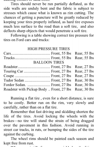

Re: Trick to getting the tube out of the tire?
Ford recommended 55 psi in clincher tires and 27-30 psi in balloon tires. Here is the chart from a 1926 owners manual:
