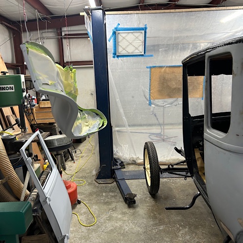

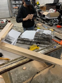

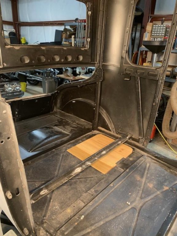

Greetings to all,

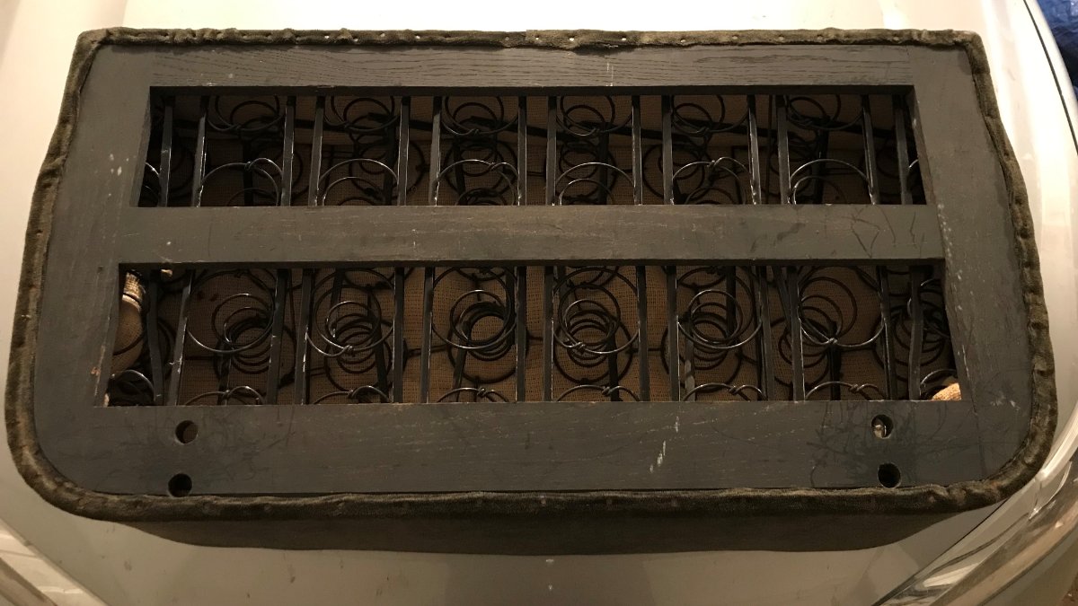

I am trying to restore a 26 coupe that my father bought back in the early 70's. I was not here during the time he was doing the disassemble as I had just joined the service. To say the least it is an adventure trying to put all the pieces back together. He did quite a bit of work on it but it has been in storage for the past 25 odd years. There are some questions I have for the group. I believe this is a coupe (all metal) with no wood around the windows. I have researched all I can find on the forum but can't be certain. Can someone verify this for me? Pictures attached. Also there were no seat springs and the associated wood pieces that attach to the springs that I can find. I cannot find any pieces of the package tray and am not certain whether it was all wood or some metal. I'm just getting started and have ordered quite a bit of parts.
I believe I can reproduce this wood for the seat bottom, seat back and package tray. If someone has the templates or the dimensions. Any help appreciated.
I hope the upload of the pictures work.....
Jesse in North Carolina.

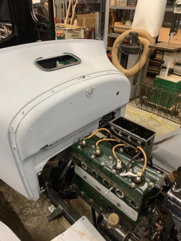

- Posts: 7411
Re: New Member Restoring a 26 Coupe

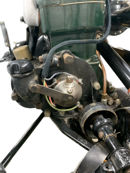

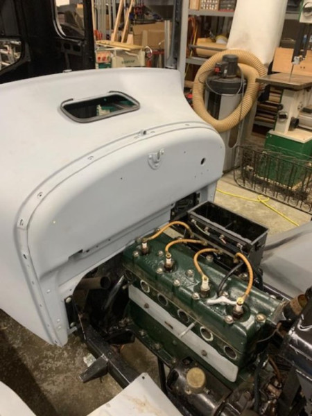

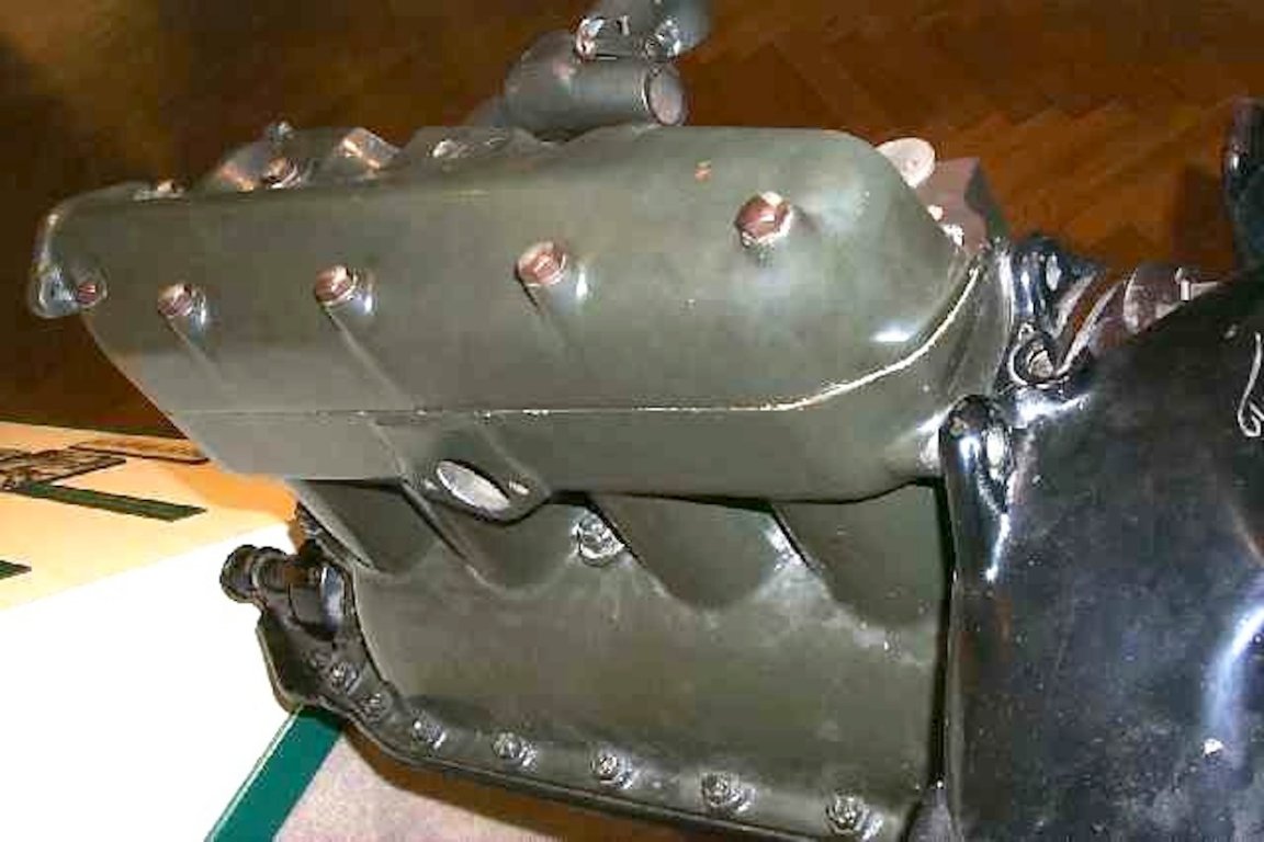

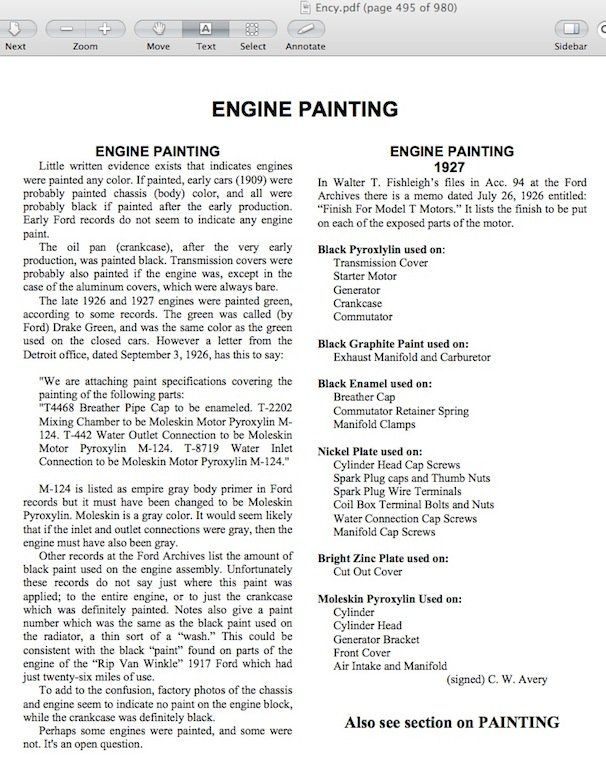

Good engine color. It's mighty close to original.
Jmeredith

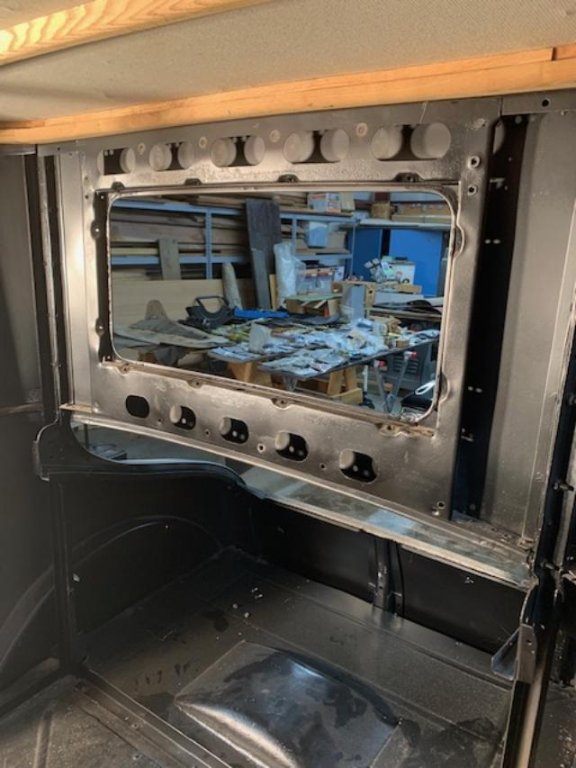

It is my understanding some of these 26 coupes had all wood package trays. Not sure if mine was supposed to or not. If metal was supposed to be attached then could you post a picture I may be interested.
I have the seat springs already (my dad had ordered them) you can see one piece on the floor beside the front end picture. There are no wood pieces attached to these. I think they were bought from Snyders way back..

I'm 6'4" also. Hopefully the rearmost position on the seat bottom will work. If not my son who is 5'11" should be ok.
Steve - Great to hear. What color is the valve cover usually painted? I was going to use high temp glossy black??
- Posts: 7411
The memo doesn't mention the valve cover, but I'm guessing engine color.

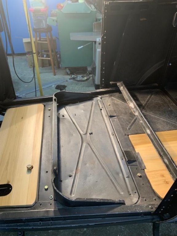

- Posts: 4681
That’s a good looking car you have. Really nice shape and not rusted up. I don’t know if your Father cleaned up the inside of the body but it is a nice solid original. Did he paint the engine? These days it’s hard to get the right shade of green. It is pretty close but it may have gotten closer to correct if you Father painted it years ago and it’s faded after many years.
Glad you leaving it an original car and not
hot rod it like some have done to the all metal body T’s.
Another thing to check on now since the body is apart is the gas tank condition! The 26 - 27 T gas tanks are a little harder to remove and work on than the earlier T’s!
Now a is good time to make sure it’s OK before you put it back together!

- Posts: 4464
The valve cover on my '26 Fordor is black. Dad would have painted it the same color as it was originally, when purchased by my grandfather.

I just looked at my early production Canadian 26 coupe and there is No wood around the rear windows. My understanding is that in fact Ford converted some of this area to wood framing for the 27 model.

Steve-
Thanks for the memo.
So I believe I will go with black on the valve cover....

There was no gas tank that I could find. I found one on ebay and had to pick it up in NJ. boy that drive was fun....not used to all that traffic...I took it to the radiator shop and they cleaned and made it right...so good to go there.

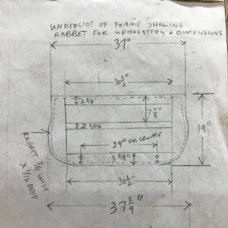

Jesse,

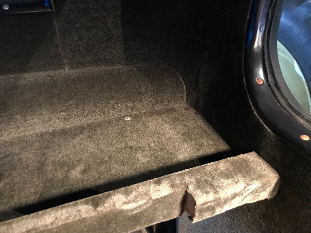

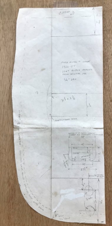

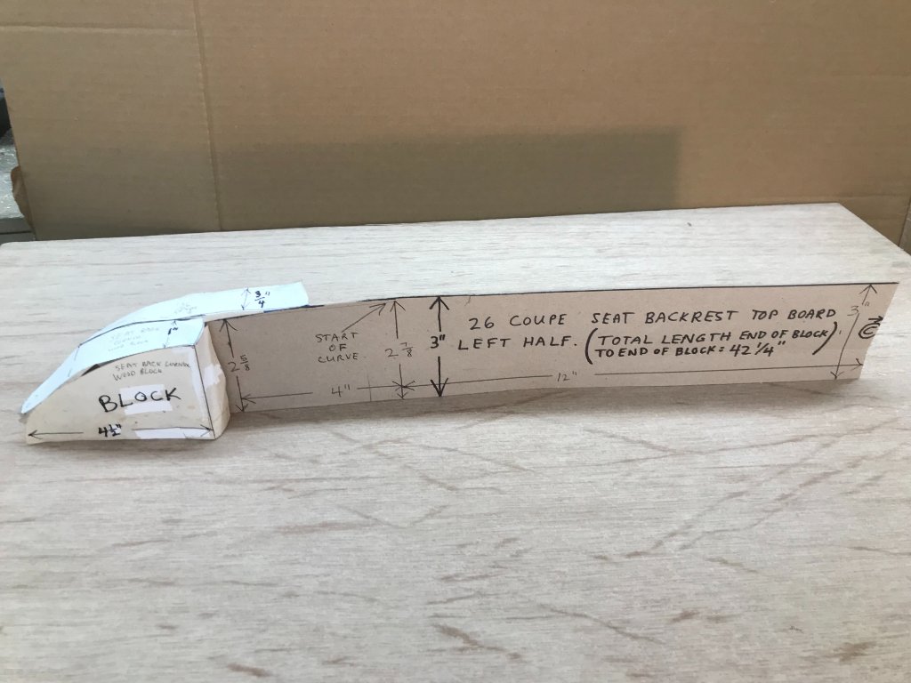

Similar to your car, my 26 coupe did not have any seat wood or a package tray. I was fortunate
to take measurements and some templates from a totally original barn find coupe that a friend had.
Raccoons had eaten away most of the upholstery so that made the job easier.

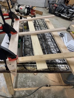

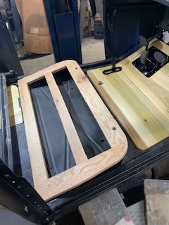

Bottom seat frame. Note that the sides are not straight, they are curved:
Template showing the curved bottom seat edge on the left side of picture:
Bottom seat frame is made from 3/4" oak. (Upholstery color is not original)
Upholstery on the barn find car was tacked into a 1/16" deep X 3/4" wide rabbet.
You can see that detail on mine: The holes that fit onto the seat riser are placed as original and you would want to set the seat to
the rear as much as possible for leg room.
The "Ford Service Manual" has good info and pictures about moving the seat back.
Highly recommended book.

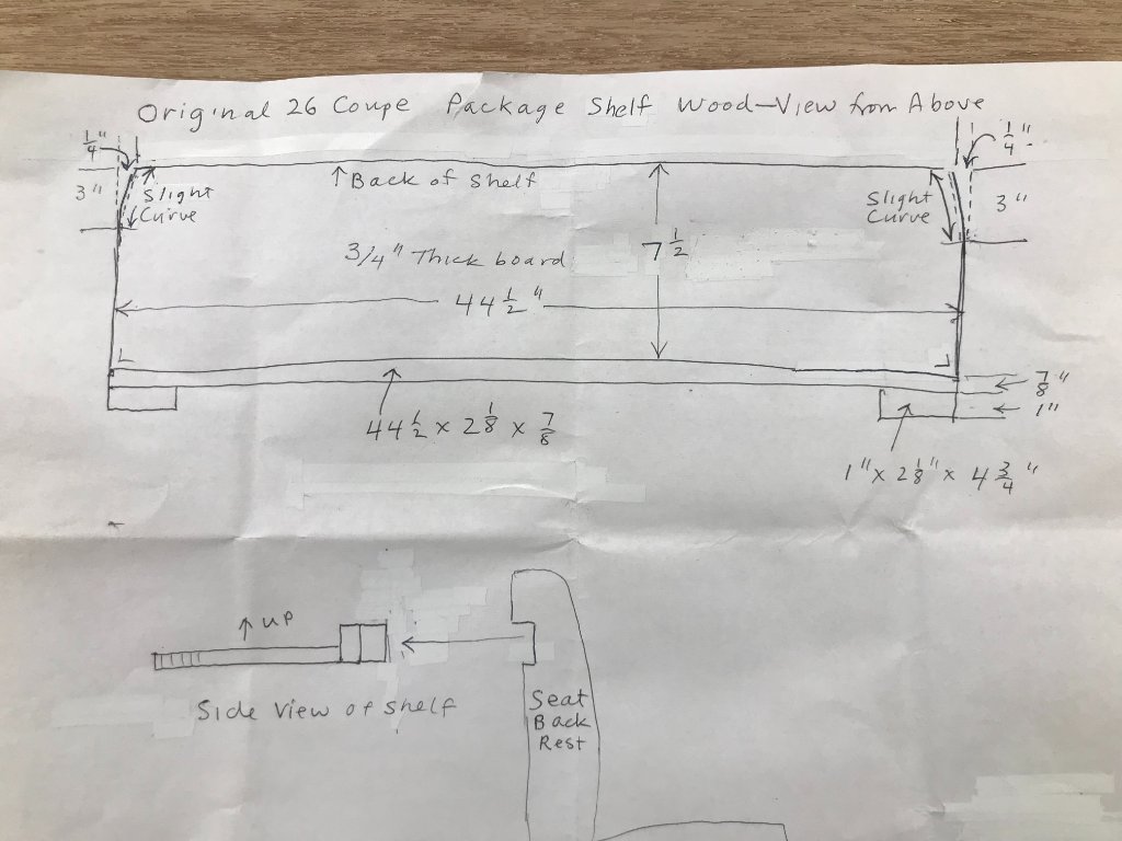

I have some seat backrest and package tray details also and could post that later.
The package trays I have seen have a curved sheet metal covered with upholstery that is then
attached to a horizontal wooden shelf.

Your 1926 coupe is correct without wood around the windows. My 1926 coupe, manufactured in March, 1926 has no wood around the windows either. Some 1926 coupes had wood and some didn’t. Jim Patrick

Nathan,
That is exactly what I need, thanks so much. My engine s/n is 12494960 (Oct. 1925) The frame s/n is 13417658 (March of 26), It also has a number on the cross member of the body in front of the seat (077065 B) not sure what that signifies?
I have some red oak that should work nicely..
Does yours have the metal piece attached to the package tray or not? And if not how is it attached to the body?
Yes post the package tray detail if you would thanks.

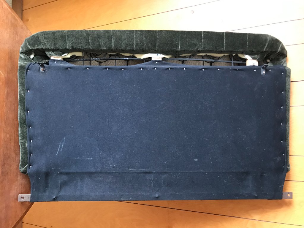

Now all I need is the detail on the seatback wood and how it is attached. I see how it is attached on the bottom. On the top I have seen it displayed for the cars with wood around the windows but not sure on the all metal bodies..
Jim, that is one SWEET looking ride....

I was able to work on the seat bottom wood today almost finished with that.
I’m not sure whether they braced the door openings when they put the top on but I haven’t had a chance to hang the doors yet. I need to find some screws and such first.
Nathan Pederson
- Posts: 138
- Joined: Fri May 08, 2020 12:51 pm
- First Name: Nathan
- Last Name: Pederson
- Location: MN
Hi Jesse,

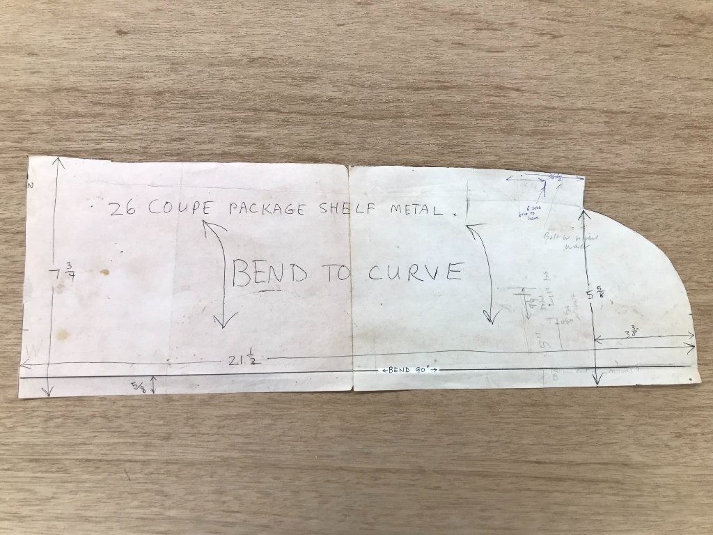

Here are wood package shelf measurements from an original 26 coupe (the car had wood around the quarter side and rear windows).
Note how the seat fits into it.
And measurements for a half side of the metal curved piece:
I made one for my car.
Here's how my package shelf looks:
Top wood rail on the seat backrest (left half shown and viewed from the front) is a little complicated as the ends curve in two directions:
Back side of the seat backrest I added a 1/2" plywood piece (where the tacks are) to cover up the springs.
Seems like adjustments always have to be made to get things to fit and look ok.
Nate

Jmeredith
Topic author - Posts: 45
- Joined: Wed Nov 16, 2022 11:39 am
- First Name: Jesse
- Last Name: MEREDITH
- * REQUIRED* Type and Year of Model Ts owned: 1926 coupe
- Location: Winston Salem NC
Thanks Nathan, that is very helpful. I believe I have enough to make what I need.
Got a little more done on the seat back and bottom.
- Attachments
- 66EBF9DB-1754-407F-A551-AB273167BDDA.jpeg (72.03 KiB) Viewed 9009 times
- 5B863368-F9F1-4142-AAA5-1F5D9057C903.jpeg (35.26 KiB) Viewed 9009 times
- B5044067-4B6C-4D38-A572-5C590449CA4A.jpeg (70.65 KiB) Viewed 9009 times
Finished up the wood backrest and bottom.

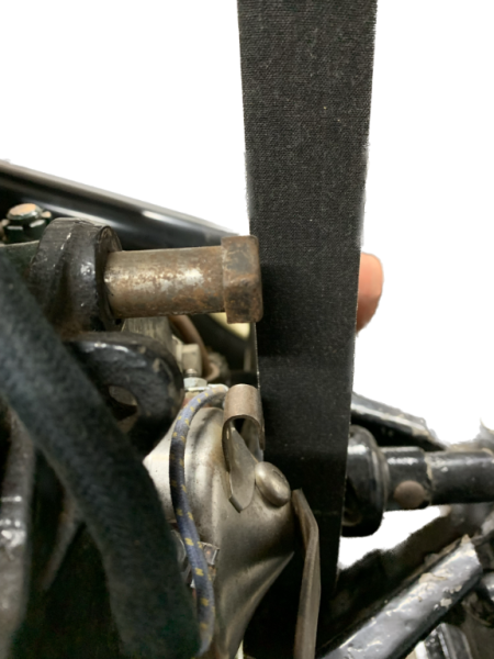

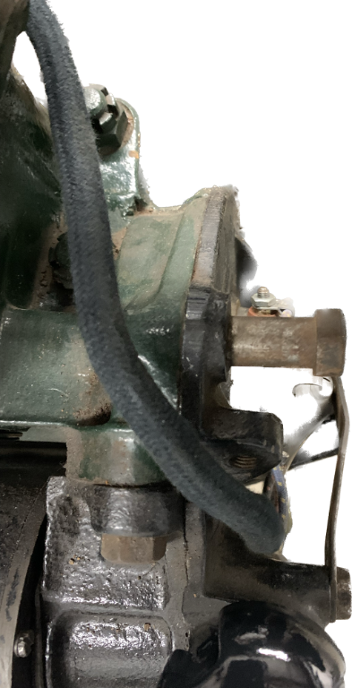

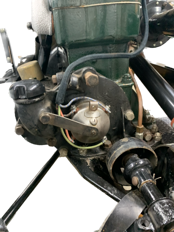

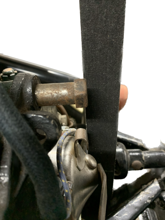

Can anyone tell me why there is a bolt with a long shoulder installed here?

Can someone tell me why the long shouldered bolt is here go?
jab35
- Posts: 1037
- Last Name: Bartsch
- Location: Dryden, NY 13053
That looks like a pivot bolt for a pre-'26 fan arm. The '26-'27 used an entirely different Fan Assembly where the fan axle was mounted in an eccentric that could be rotated in a 'bearing' in the water outlet casting that bolted to the head. The fan belt tension was adjusted by rotating the eccentric bushing and then clamping it in place. Is your engine earlier than 1926? jb
The eccentric you are speaking of is above where this is. This appears to be in one of the top bolt holes for the timing cover?? Here is another picture

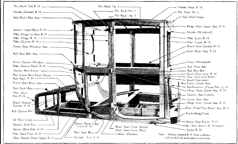

Here is some reference material
This is a link to a lot of Model T documents
This is the link to the 1926 Body Parts list scroll down to the 1926 Coup, body wood, followed by sheet metal and then interior
https://www.cimorelli.com/mtdl/1926/default.htm
jab35
- Posts: 1037
The timing cover in your pic is from a pre '26. The lug with the threaded hole and bolt you show identifies a cover of earlier vintage. You don't need that long bolt, but you do need a bolt. Best, jb

Cimorelli's is a great resource. The item of interest is "Parts list-MAY". The wood coupe body shown is pre '26, but later versions are shown in the May parts list on the Cimorelli link. Thanks for posting that link! jb
ps:
Distagon2
If in fact you need a 26-27 timing cover I have a half dozen of them, and could part with one.....
- Posts: 6790
Boy, I sure would not remove an earlier timing cover just for the experience. It isn't doing any harm there and if the engine is rebuilt and everything is sealed up, I wouldn't mess with it until there was a darn good reason in the future. Install the proper water outlet on the head that belongs there and be done with it. Maybe I'm lazy...actually, yes, I'm lazy when it comes to this stuff. If it was a rare car and it just had to be "right" that's one thing, but trying to get a car on the road to enjoy it, I'd spend the time and effort on things that HAD to be done. This isn't one of them.
After you've enjoyed tooling around in it for 6 months (whenever that happens) if it really bothers you, change it then.
- Posts: 5248
If you change out the cover, you need a special tool to center the cover to the cam.
Of course, you dont know if the current cover is correctly centered. This is important for accurate cylinder firing.
I would want to know.
The thing to do is to get the gauge or check the centering by other means. Acquire the correct cover. If the current cover needs to be removed to correctly center, put the correct one on.
I am with Scott to not be in a hurry to replace the current cover if not necessary.
Jmeredith
- First Name: Jesse
So let me get this straight…. This is earlier timing cover with the wrong bolt installed? How do you determine the difference between the two covers. Here is another picture.
- Posts: 5248
That bolt is the fan arm pivot bolt.
See the threaded boss to the left?
Thats the adjusting bolt boss to tension the fan arm. A 26-7 wouldnt have this boss.
Jmeredith
- First Name: Jesse
Ok, I think I understand what I’m seeing. As long as it will run with no problems with this cover all should be fine. I have installed a new outlet connector which has the correct eccentric and all should be good. The old one was very rusted out were it connected to the hose to the radiator. I am not planning on restoring and showing this car, just gonna try to fit in it and try to drive it and enjoy it.

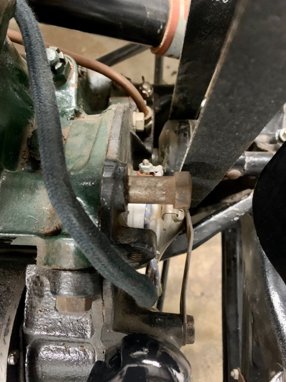

Jesse, I see that only one of the two bolts under your timer is installed correctly. Both bolts should be installed with the bolt head up. The bolt sticking up and split pin (on the left in your photo) can short out the timer if the timer contact touches it.

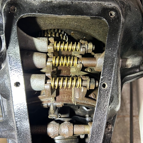

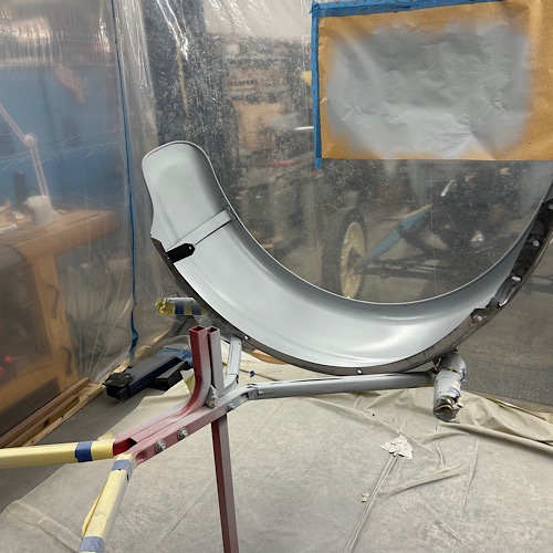

Finally finished painting, my ‘booth’ was a little small but I made do.
Now I need to determine whether I should replace my bands. I’m not sure when they were changed but it must have been about at least 30 years ago !!
It appears that the low band is worn more than the rest. Not sure why that would be. It would seem the brake band should have more wear right?
As I have the body off of the frame now would be the time to do it.

- Posts: 7272
Definitely do the bands before the body goes on. Even if they weren't shot just yet, it is worth saving the angst of doing the job with the engine in the car.
