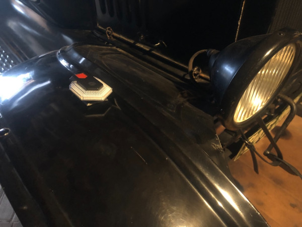

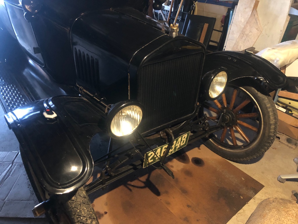

I went on Amazon, put in wireless turn signals and found [Goldfox Bike Tail Light USB Rechargeable, Bike Turn Signals] for less than sixty dollars. For another 12$ I bought some square 1.25" X 1/8" Neodymium magnets.

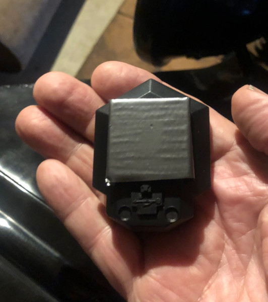

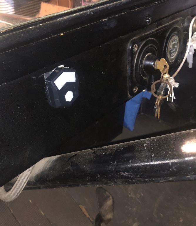

I used my dremel to take off the small square used to attach these units to handlebars etc. When the back was flattened I hot glued the magnets to the signals and to the controller. I had tried round magnets first but needed the square ones to abut the crease in the fender and not move. I've tried to shake them loose on some backwoods trails and on a few trips recently and they stay put. I also put a magnet on the small controller and simply attach it to the dash in front of the wheel. All of the magnets have heavy duty duct tape covering the magnets so they don't scratch the paint. That seems to work well.
The units themselves are rechargeable, in fact the package comes with a four line usb charging cables so all four signals can be charged at once. The signals are bright, turn off in 30 seconds easy to work with the small controller. Additionally the units can be set to blink red leds for parking or all four signals to blink red then signal orange for an emergency situation.
I made a roll up sleeve to keep the units in and it takes about a minute to put them on the fenders and place the controller.
This update sure beats hand signals and I feel much safer when in traffic in my T.

Thats 2 turn signals on the front fenders, do you have 2 on the rear fenders ? I’m very scared of being rear ended as I have my arm signal on. Great idea ! Thanks for sharing 🙏

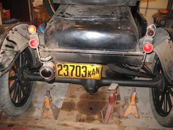

I consider my fling with magnetic tail lights a failed experiment. I drive on country roads a lot and had to resort to welding rod hooks and rubber bungees to keep them in place. That worked for one driving season, but the next year one of them shook to pieces. I had to decide: show car, or driver? The decision was definitely driver. So I made rear mounting hardware sturdy enough to survive, I hoped, and held in place by wing nuts for easy removal if I want. For tail/brake lights I used Model T electric tail lights, and truck running lights (or motorcycle tail lights?) for turn signals.
I could have gone with wireless front signals, but I saved the bucks and wired them. The mounting bolts are drilled hollow for wiring.
Tail lights on, signaling for a left turn. I haven't cleaned up since my last trip. :)

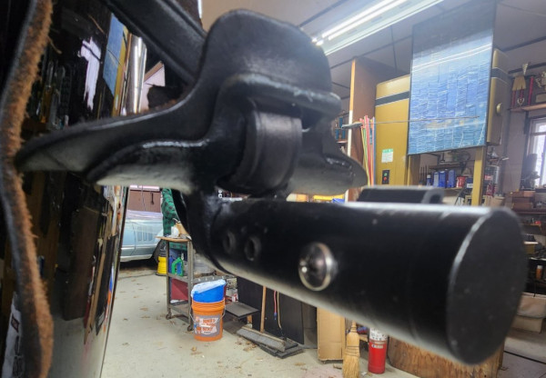

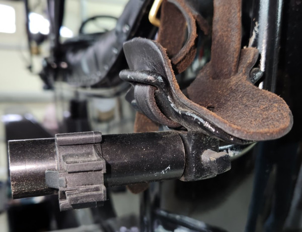

We used the same bicycle turn signals as shown above called "CarryBright". I bought then on Amazon.
They are wireless work very well, rechargeable and bright.

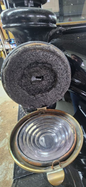

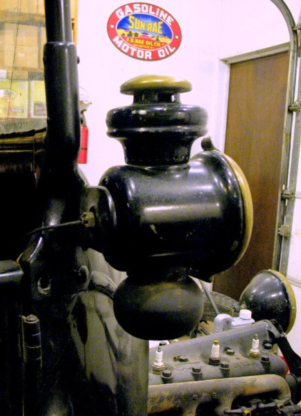

The front we placed in side the cowl lights using black Styrofoam cutting for a tight fit. You can't see them until turned on.
The rear we put on the top arm. We took a piece of round aluminum drilled it to slide over the arm and used set screws to hold it in place. When my dad takes it to local car shows he just unscrews them.

Yes, there are two on the back fenders as well.
They don’t seem to move on rough roads. I tested on the trails throughout my farm. T’s are like old Jeeps!
I like the idea of putting the signals inside the cowl lights.
