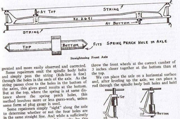

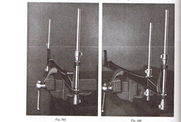

A few ways to check the axle
There may be a reason that the perches are on backwards and that is if they had bee-hive Hassler Shocks (pancake style did not have the reversed)
Now here's the rub.... what else is wrong with your setup. Rotating the axle 180 degrees corrects the perches but then what about the spindles will the left hand threaded nut be on the correct side?
Removing perches can be an impossible task most of the time.
