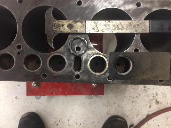

Weld them out
Post by D.Yoder » Tue Apr 30, 2019 4:50 pm
Valve seat replacement

Why are you removing them, Dean? Did someone not install them correctly?

Two had been replaced but were too eroded to resurface. I will install replacement Nickel Chrome seats in all of them so they are uniform.
