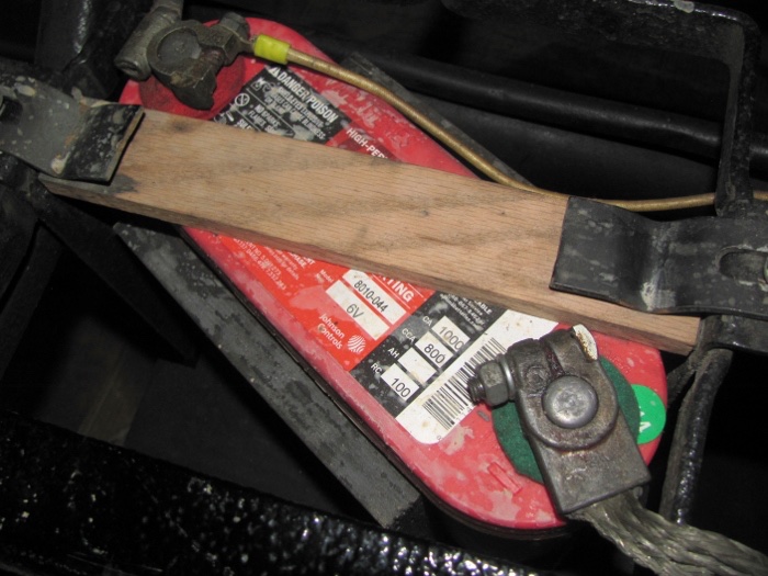

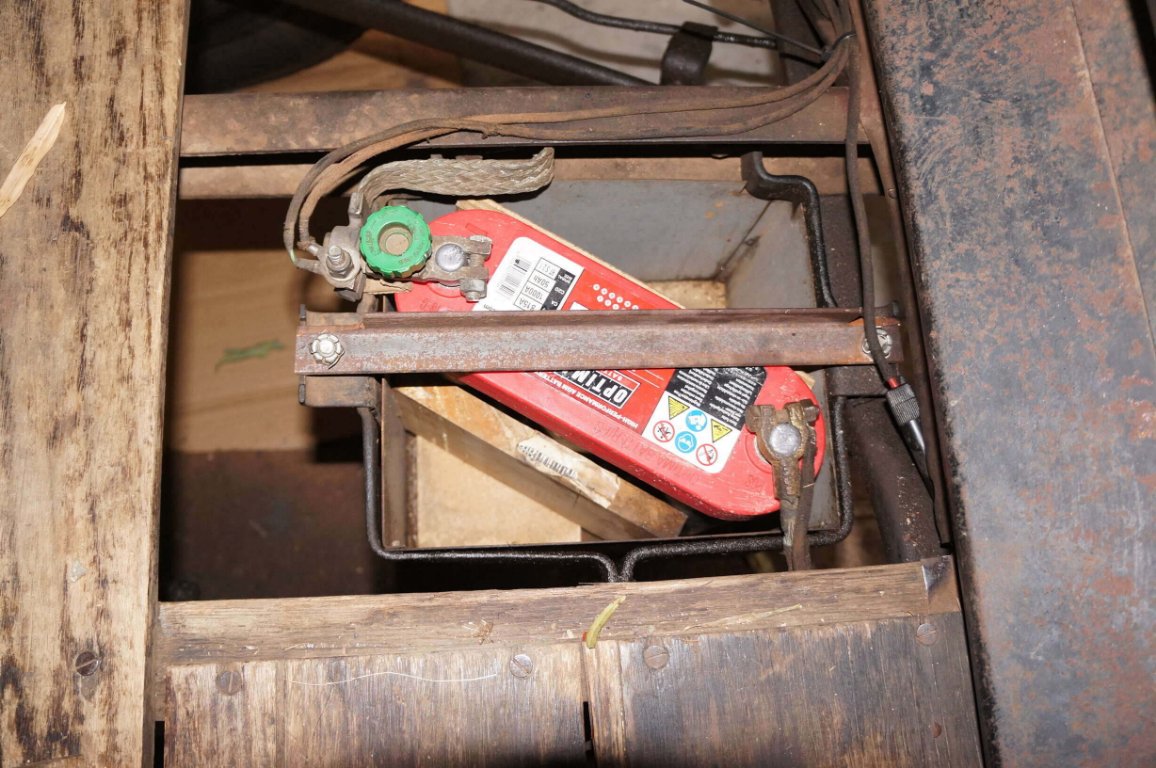

I'm also running 2 of them - just have to install on a diagonal & use wood or rubber extensions for clamping - that's how I did mine anyway.

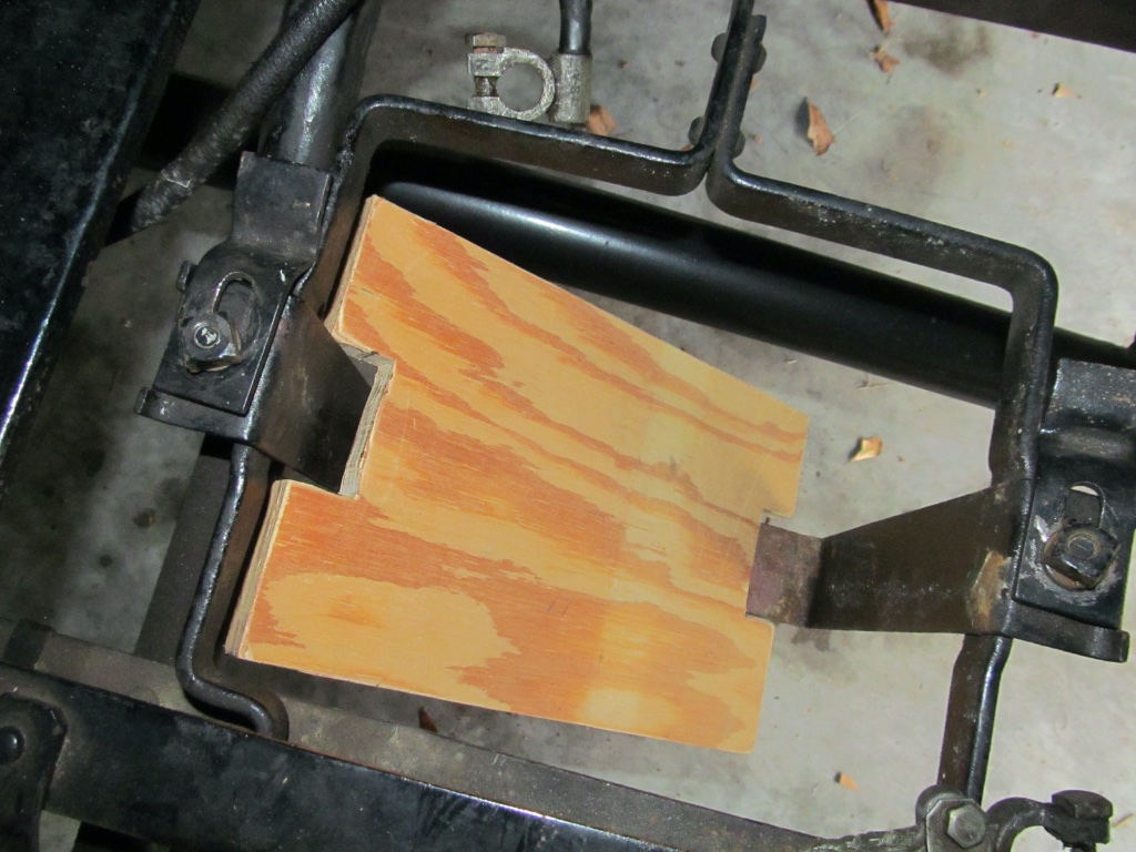

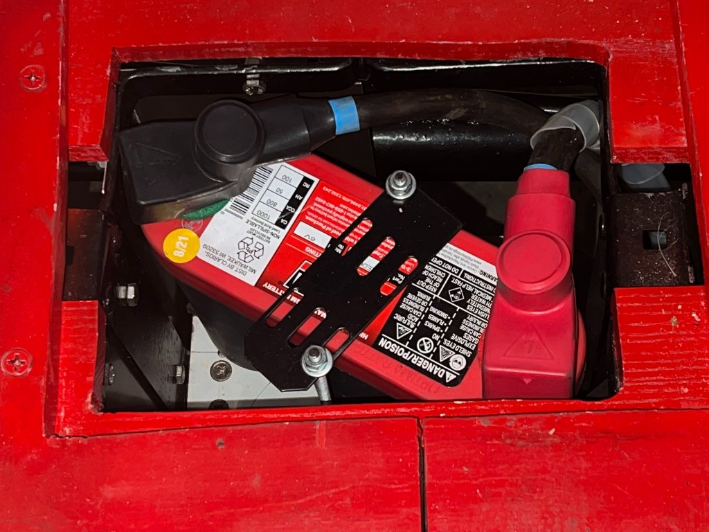

Simple board cut with slots for base of battery hanger. Then screw a pair high side boards onto the base, to help keep the narrow battery from tipping. Painting the unit is optional but hides best.
Finally use a wood strap across the Optima battery to lock it in place with factory battery box clamps.

Depends on the car. 1919 or later I'd use the built-in battery carrier and make a box to fit it. Before 1919 you have to improvise (running board box, under a seat, etc.). I just put the battery for my 1915 runabout in the trunk.

My wide body roadster battery is in a metal running board toolbox. It is clamped down and the side cut out of a small plastic chemical drum acts as an electrical insulator on the top, in case anything else in the toolbox gets loose.
On Henrietta, the running board box is fashioned from an old timber box, complete with wooden lid. It is a snug fit within, so It just sits there. The old, stiff earth lead keeps it tied down.
Dan's hold wooden hold down bar is a neat job in a standard battery carrier.

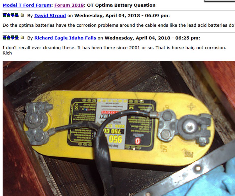

I made a box for a Group 1 tractor battery and the yellow top Optima fit in there like this.
As mentioned, it has been in there since 2001 or so and worked last summer just fine. I didn't check it today.
I would buy some new ones if they are as good as this one has been.

I have one in my '16 Touring.
I installed a Model T battery carrier and set it at an angle like others have.
I also put one under the front seat, behind the gas tank on a '15 Roadster.
