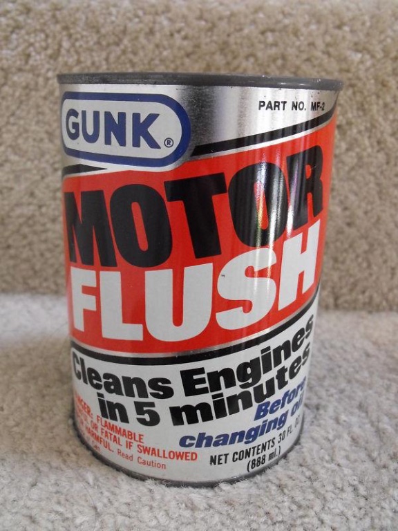

There are motor flush products that you pour into the oil and run the car until hot. It this the oil while cleaning the interior of he engine. Drain, then replace the oil. Jim Patrick
This is the one I have used successfully.

Scotts method is the safest.
You dont want a bunch of loose crud splashing into the oil pickup areas in a T motor & blocking those holes permanently obstructing needed lubrication.
Also a detergent may attack & further rot band lining.
In a modern engine, the crud gets filtered thru the oil pick up screen. The kind of thick crud found in T engines, (Paraffin based oils, etc.) Can even plug up a "modern" oil pick up screen enough to lose that motor.
In my early T apprentice years an old expert said to run only non detergent oil in old, dirty T motors. Detergent oil would suspend the crud & distribute it into oil delivery areas. I followed this advice for several decades. I had not thought of manually cleaning a motor by removing the dip cover. This is where the lions share of crud rests.

I would not use kerosene or other solvent to "flush" an engine. You'd as likely to flush grit and crud into bearings as out of them. Loosening too much crud too quickly can be worse than leaving it alone. Manually removing as much debris as possible, especially from around the oil pan inspection cover, is a good idea. I'd follow that with clean detergent oil like 10W30, or 10W 20 in cool weather.
Reducing the oil's film strength and lubricity with solvents invites embedding grit in the babbit bearings and perhaps into aluminum pistons. If the clean oil gets dirty quickly, change it again. I'd also drive an old, neglected engine at only moderate speeds for the first few hundred miles. Adding a good auxilliary oil might be a good idea, and adding a transmission cover screen is always a good idea. Be sure the transmission bands aren't severely worn or shedding lint due to decay.

I’ll assume that motor flush in a can might not harm a T engine because of the non pressurized oil system but I wouldn’t use it in a modern. Saw the result of this years ago when a friend dumped a can of it into his mustang. Some bit of junk got lose and made the pressure regulator in the oil pump unhappy. Zero pressure. Luckily, since we had no way to pull the engine those old Stang’s had a tubular bolt in cross member which I pulled out and dropped the pan. Lesson learned.
