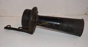

"...mag horn has a very small back end compared to the larger backside of the battery horn."
I have robbed an image from the Internet that is the same horn as I have. See photo below.
Marshall
Marshall

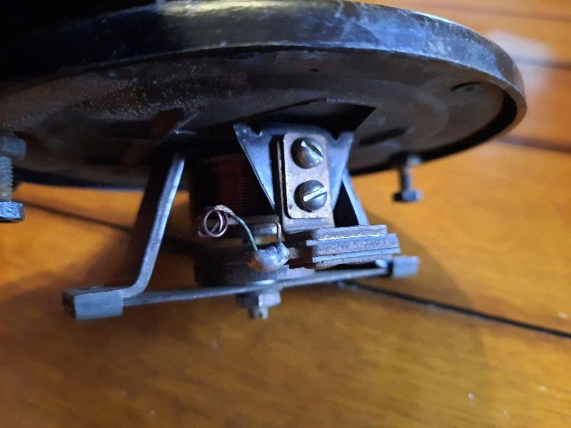

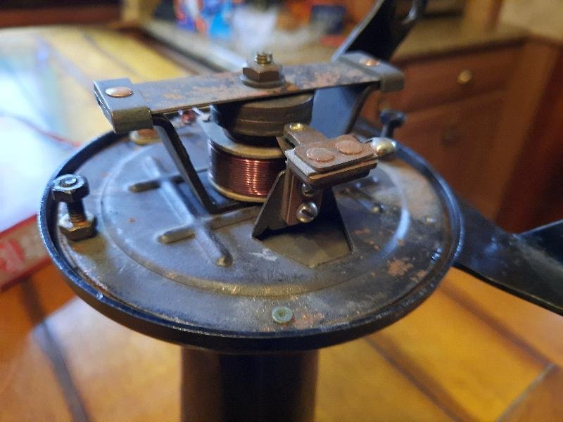

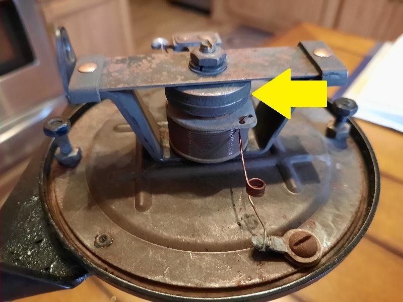

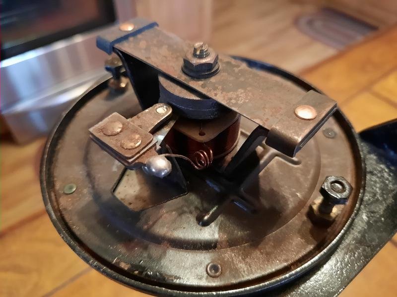

Here are four photos of the ELECTRIC horn in question. Do you see anything obviously wrong? Is the "drum" with the yellow arrow supposed to spin freely? It is sluggish and difficult to turn with my fingers. Could this be the problem? Or does it simply vibrate? I don't see where to oil the shaft if this is supposed to turn when juice is introduced.
I'd sure like to get this horn working for my friend and also gain a new Model T skill I can use to help other Model T owners locally, who also have non-operating horns. In this town, you NEEEEEEEEEEEEED a loud horn!

Those "drums" are steel disks that are pulled down upon activation of the electromagnet. Note on the opposite side the disks open the points, shutting off the magnet. The proper opening of the points via the location of the disks & length of travel changes the frequency of the vibration effecting the horn tone. The disks location is to be moved/tuned by loosening the lock nut & rotating via the slot in the stud.
It appears in the picture (or its not shown well) that the points are not making contact @ rest as they should. Power pulls the points open with the electromagnet.

Looking at the slotted brass stud and lock nut, they do not look like they are in the proper position. The brass stud should be exposed a bit more. If they are not in the right orientation you’ll get no sound. You can connect the horn to your 6 volt source and adjust just as Chris & John stated by loosening the nut first & adjust the slotted stud. These are not gross adjustments but rather fine adjustments.

The "drums" are not supposed to rotate and should NOT be oiled. They are just hunks of metal that the electromagnet pulls against to make the horn operate.
Show a close-up photo of the point contacts when the horn is "at rest". Also, the solder joint, shown in your first picture, looks kinda iffy. Maybe not. Hard to tell.
