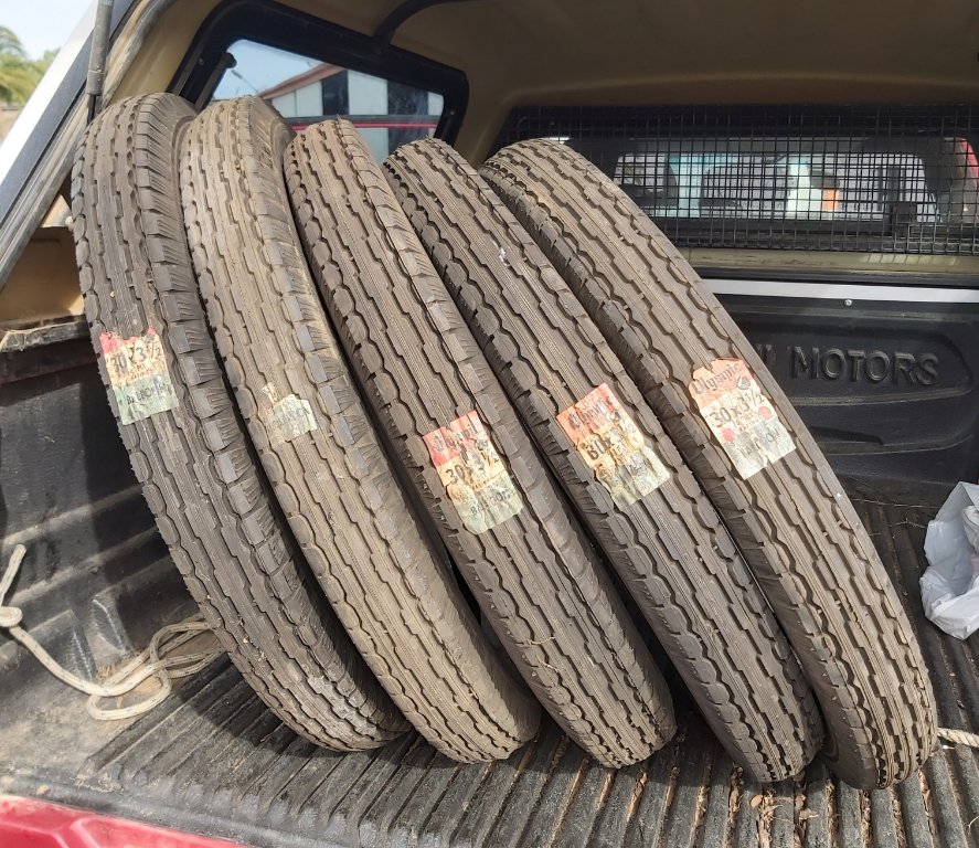

When the Olympic Tyre and Rubber Company decided to cease production of their legendary beaded edge tyres in the early 1970's, they advised old car enthusiasts so they could lay in some supplies for later. I traded som labour for this set of beauties.

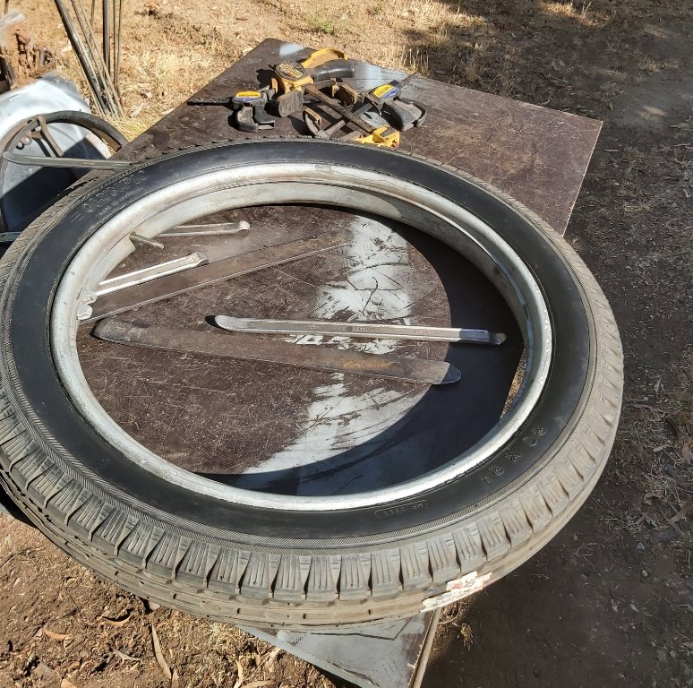

Over time they shrink, having no wire in the beads. My local tyre shop used their machine to roll one side on a rim, but there was no way they could then insert the tube. I picked it up and left it aside for some hot weather. With the temperature in the high 90'S, I levered it off quite easily. The fired bead was almost an inch bigger in diameter than the non fitted side.

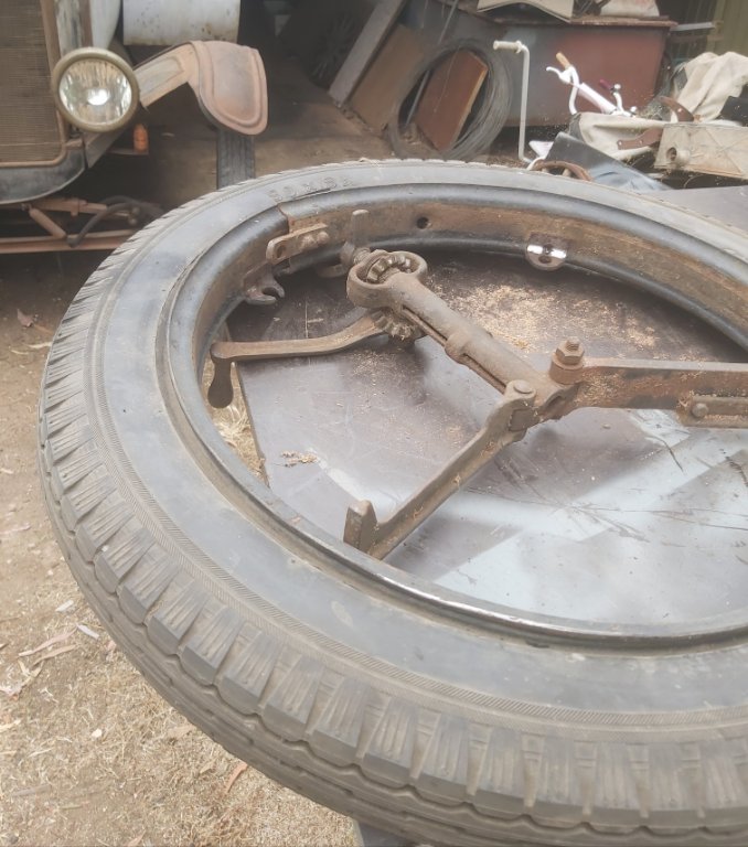

Normally, I stretch old tyres by fitting them over flat 13" car tyres and then inflating them to stretch the BE tyre. I have 3 of the others fitted over 3 different sized wheel/tyre combinations to stretch them in stages. This one has gone a different route, which has been a game changer.
Here it is, easily fitted over a collapsed 23" Chev split rim, and then expanded even bigger than 23", there being a 1/2" gap in the rim ends. Today's temperature is expected to be over 100, so I will try fitting it up this afternoon. Wish me luck. Only 4 more to go.

Success! I got the first one mounted today. It was a warm day rather than a hot one, but it was enough to allow me to get the first tyre on a rim. A second one is now on the split rim spreader. I can jack them out until there is a one inch gap at the rim join. That makes it easier when levering them onto rims. Tube goes in the tyre. Rim liner on the rim. Valve stem and both beads clamped in the rim. Both beads levered on at the same time. i Managed it on my own.
4 more to go!
