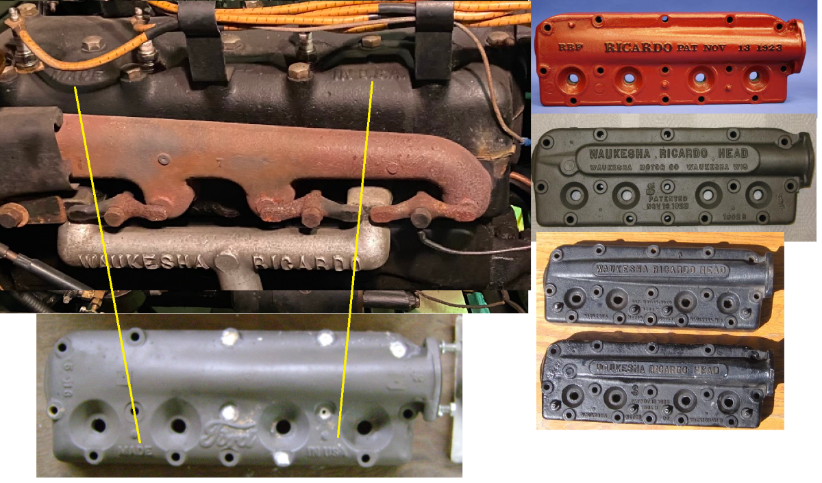

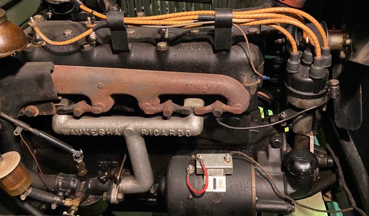

I am looking at a T Coupe that is fitted with a “Waukesha Rigardo” intake manifold. Can someone wiser than me tell if this is a factory cylinder head on this motor?
- Posts: 5159
Re: Waukesha Rigardo
Looks like an original high head. Never seen a W/S intake manifold. Seen many heads. Very cool.
I see your economy fits all diode cut out. Safer replacement over the cheap, light weight mechanical cut out thats available.
Obviously an improved T. The added fuel filter may give you starvation grief as the tank gets lower.
Safest deal is to remove it & make sure the screen is still in tact in the shut off valve.

Very hard to find intake.
- Posts: 5489
Looks as though that might be an "Improved" Ford - plenty of head pressure for a filter.
Nice intake - only second one I've seen w/mine being the first ! I have the matching "early" head with priming cups on our '19 Centerdoor.

Not a Waukesha Ricado Head. Likely stock head

Thanks for the responses everyone. The head has either a “C” or “G” in the casting on the top up front. Does this marking have any significance? I believe it is a “C”

The letters vary quite wildly. Presumably mold letters to keep track of the mold condition to know which of many being cast @ a time need repair or replacing.KenJackman wrote: ↑Sun Jan 15, 2023 9:35 pmThanks for the responses everyone. The head has either a “C” or “G” in the casting on the top up front. Does this marking have any significance? I believe it is a “C”

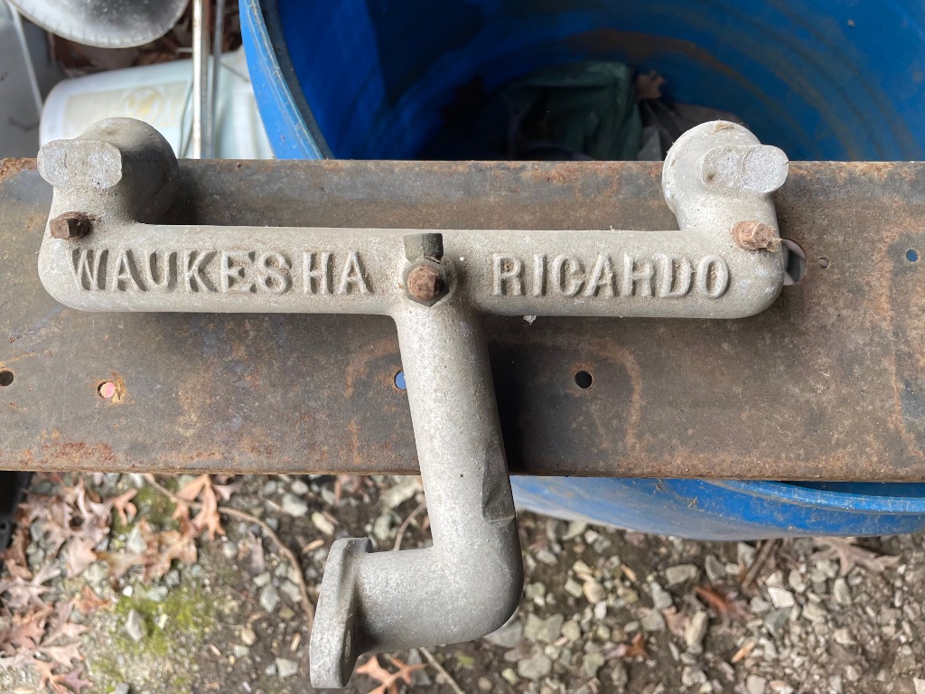

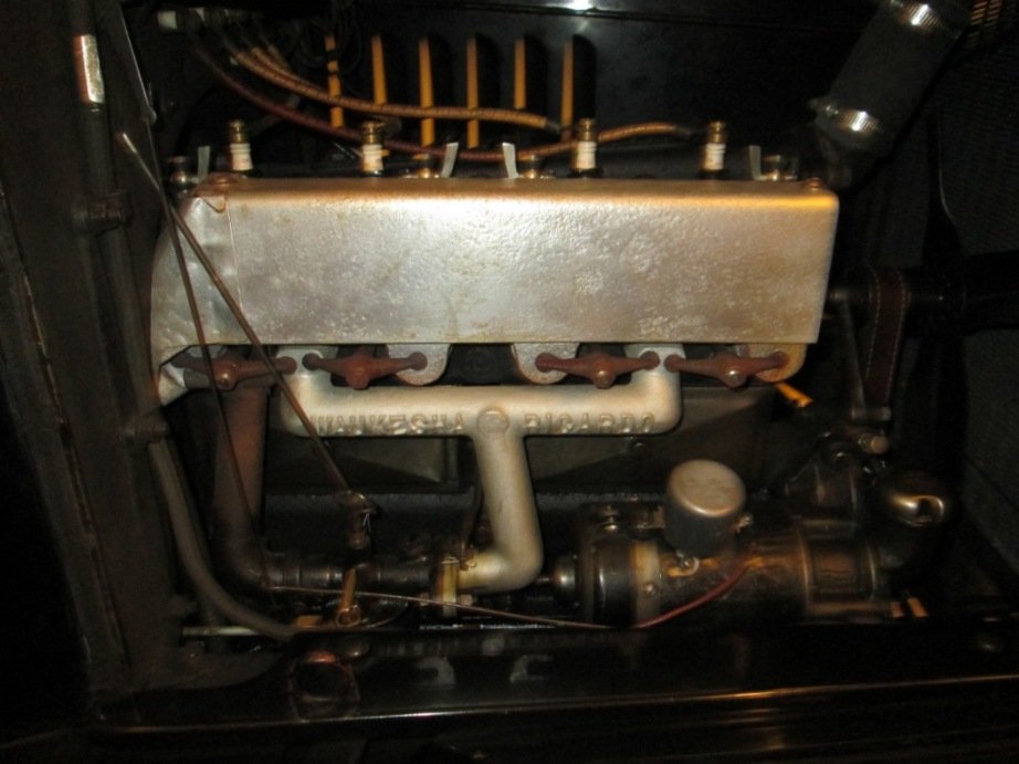

Here’s another. I have the head also. I’ve been wondering how efficient theses intakes are with the ninety degree turns.
- Posts: 8443
It's not a high speed manifold. It probably worked very well on a closed car or TT truck running a Ricardo head and 1920s gasoline. In winter, you'd have wanted want a heat stove.
