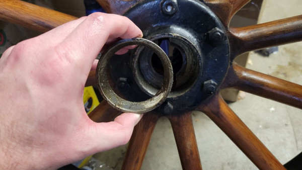

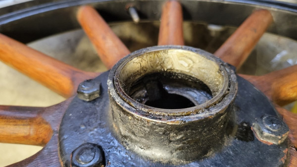

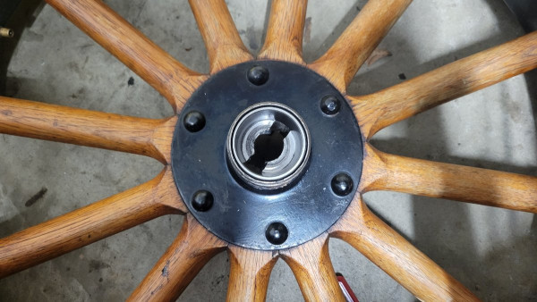

While I had the wheels off to replace my spindle bushings, I figured I would install my front bearing set.

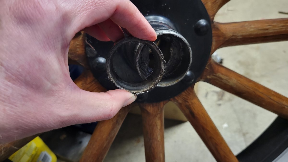

The old bearings came out easy and the races needed some persuasion. It wasn't a brutal fight as some describe, but definitely required a creative tool and some hammering. It took about 10 minutes for the driver's side.
With that behind me, I got my new races out of the box and I was surprised that the inner race slipped right in and was loose. I tried the outer and had the same result. Here is a video: https://photos.app.goo.gl/C1FAykr3P5vMSTYZ6
I tested the gap with a feeler gauge. I was able to force a .010 into the gap but not a .015. Given the curve of the hub and the width of the gauge, I'm not sure I can get a better measurement.
Well, that's not supposed to happen. Do I need new hubs (yikes!)? I searched the forum and saw some people used a Loctite product but I wanted to put it out there to you all. Have you used Loctite or some other solution? Thoughts?

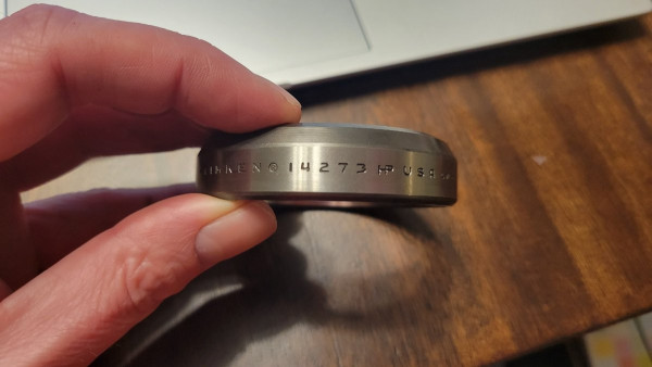

Despite the parts on the boxes, I'm wondering if by some mistake, the new races could be for Model A instead of Model T,...???

Thanks for the reply 2nighthawks... The inner race is loose too and it has the part number stamped on it. Looking at Langs kit, this is the correct race.2nighthawks wrote: ↑Tue Jan 17, 2023 7:51 pm....oops! I meant to say,....despite the parts NUMBERS on the boxes....

Arbs: I'm curious, What are the diameters of the old and new parts? thanks, jb

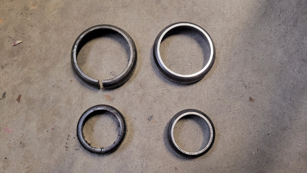

Some thoughts... for what they're worth...
The inner races can be a loose fit and still need to be driven out. The hub bore only wears where the race sits, and not where the hub seal goes. So, you'll need to tap out the race to get it past the seal area. It makes you think the hub isn't worn...
Old races may seem to be tight in old hubs that haven't been used in decades. Sometimes, it's only the dried-up grease and oil that has them "glued" in place.
Outer races may also seem to be snug when you remove them due to small burrs and other abuse that rolls over metal at the nose of the hub. Pushing out the old race, forces it over these spots, making things seem snug/tight. Once the old race pushes these high spots back, and without those same interferences in play, the new race simply drops in.
The old races can also be split, or maybe even swollen, by overly tightened bearings or previous accidents.
Driving out old races unevenly by allowing them to get cocked in the hubs, can swell the hub and ruin it.
For loose inner races, I have carefully closed up the hub bores by repeatedly hammering the outside of the hub with a ball pein hammer. With the hub firmly supported by an anvil, or other significant hunk of metal, I beat on the hub repeatedly while slowly rotating it. Don't hit it too hard or you'll get the hole out-of-round! Many small hits and lots of patience does the trick.

Jerry,Jerry VanOoteghem wrote: ↑Wed Jan 18, 2023 11:36 am
I noticed the "split" in the old races and incorrectly assumed they were meant to be that way. Well, after a more careful look and clean up, I'm realizing they are the same type of timkin races that I bought from langs but broken.
I haven't done the passenger side yet but I quickly looked at the old races installed on the hub and they appear fine.
A replacement hub is looking more and more in order, but maybe I only need the one.

A split bearing ring normally is caused by an excessively loose mounting fit. The outer ring in this application must have an interference fit.
If the new bearing is installed with an adhesive, care must be given to maintain acceptable wheel runout, mostly wobble. As Scott commented, this would require a lot of skill.
I cannot comment about the durability of any adhesive in this case.
Art Mirtes

I suspect the split race, or a previous split race, allowed your hub to be expanded. It's also possible the hub is cracked. A better hub would be the best choice, epecially if the car is expected to be driven much.

Happy Birthday Perry! I saw references to hammering the inside surface of the hub with a punch in some old forum posts. I believe at least one or two of them mentioning that it should look like the surface of a strawberry when done. I like the idea of a chisel, especially if it's curve matched the curve of the hub. I'm looking for a replacement hub at the moment but I will keep this in mind if I ever need to use the bad hub.Perry Goble wrote: ↑Wed Jan 18, 2023 11:54 pmI just had my 70 th birthday , A classmate of mine farther had a large mechanic shop in town . I became good friend of his father and was a pallbearer at his funeral . He had driven Model T fords in his youth as every day transportation . This is how he taught me how to repair loose wheel bearing sleeves . take a small cold chisel grind away the two sides so you have a point . lay the sleeve on the workbench . take the chisel and put the point at the top of the flat side of the sleeve that makes contact with the hub . tap with a hammer .It will make a debit in the sleeve ,move the down a little and repeat the process .when you get to the bottom move over and start another line . do this all away around the sleeve . you are creating sharp points that will dig into the hub and hold it in place . This method has worked for me through the years . good luck .
I just found a post mentioning this: https://www.mtfca.com/phpBB3/viewtopic.php?t=21026#p161125
I take Scott Conger's comment seriously. Our worn out or bad parts today may be someone's key to getting a T on the road in the future, so I won't be ditching the old hub.

Arbs, The link you posted above is an old post of mine. The "strawberry fit" I described will work very well when used with a locktite press fit type of product. The "strawberry seeds" act as a centering device. The large number of "seeds" very accurately will hold the race centered. Make sure to inspect the hub for cracks. A cracked hub should not be used. Like I mentioned in the link. Make your own decisions as to the use of this technique.
- Posts: 4479
Re: Spinning Races - help
Without the use of loctite, the dimples you create will soon wear down and leave things just as loose as when you began. Even with the loctite, as Donnie says, "use your own judgement."dobro1956 wrote: ↑Thu Jan 19, 2023 9:40 amArbs, The link you posted above is an old post of mine. The "strawberry fit" I described will work very well when used with a locktite press fit type of product. The "strawberry seeds" act as a centering device. The large number of "seeds" very accurately will hold the race centered. Make sure to inspect the hub for cracks. A cracked hub should not be used. Like I mentioned in the link. Make your own decisions as to the use of this technique.

If you truly want to rebuild this hub, the "right way", you could take it to a machine shop, have the bores ground slightly oversize, or at least trued up. Then, have the bores hard chromed, then ground back to the proper size. It would be expensive. There may be some spray weld techniques that might also work.
Just how much size difference are you seeing? Can you accurately measure the hub bores and bearing OD's?

The caliper I have won't get deep enough into the hub to measure the seats of the races, and I can see the race seat is worn more than the rest of the hub bores.Jerry VanOoteghem wrote: ↑Thu Jan 19, 2023 10:32 amJust how much size difference are you seeing? Can you accurately measure the hub bores and bearing OD's?

- Posts: 8665
It would be best to replace the hub. Short of that, I'd try shimming it with a shim made from a steel soft drink can.

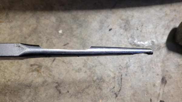

I'm happy to say that the passenger side is behaving more normal. So far I got the inner race out and it was a bear. The races aren't cracked either. I'll pull the outer this evening.
I checked the new inner race and it doesn't slip into the hub.
Hopefully this hub is in good shape.
Mid extraction: Time to let my arms rest:

I use this for similar situations.
https://www.amazon.com/Loctite-37424-St ... B0002KKTIG
As for the hub, I would use a center punch and put peen marks all along the area the race rest in. Done right and you will have to knock the new race in as a new 1.with the peening and the loctite,should be good as most on the road.

The outer passenger side race was harder to get out than the inner race and only because I couldn't get on it with any tools I had. Inspired by Dan Treace's post from 2015, I went to a local swap meet and bought some inexpensive tools. Then I hit the grinder. The end result was this:
Which led to this:
The next step will be to clean up the hub and insert the new races.
I'm still in the market for a replacement hub for the driver's side. If you have one you are willing to part with, please let me know.
Which led to this:

Look up weld-removal of races and you won't be modifying any more tools

I had a similar situation pop up a little while back when installing bearings in a pare of hubs (not as bad as Dan did ) I found the hubs I was
working on that the outer bearings did not offer the resistance I expected when driving them in. They did not fall in or spin I just thought they
needed to be a firmer fit. I figured I would use Loctite 660 because I have had good success with it on shaft to bearing issues, but thought the
fit was close enough that it would likely displace most of it when installing the bearing. Mack mentioned steaking & Loctite& that got me to
thinking about knurling the hub to get a better fit. I looked up I.D. knurling tools & almost had a heart attach. $200-$300+ so I came up with
something that works for a lot less by modifying a inexpensive straight knurling tool ( (under $25 )it had to be cut & welded to make it a right
angle I.D. knurling tool.(This will only work if you have a lathe or a friend that has one) It's a little tricky to get square but takes little pressure
to make a rough knurl that will reduce the I.D. by .006 most of which will be displaced by the bearing but will give a place to retain the Loctite.
This should be used at your own discretion but if your hub only needs a little help? I would not think this would be a repair for a hub that the
bearing was loose in.
Craig.

I used 609 on my outer races, and they are fine. However, mine had some resistance to spinning, and I'm sure my smallest feeler gauge (.002" or maybe .0015") would not have fit in the gap. The fact was that they were not tight.
.010" sounds awfully big for even a good product like 609. Knurling might be a good suggestion.
I use locktite 660. It's a silver paste rated to .020" fill.
You place the race & turn until it locks up. I dont know if it would work with a knurled surface.

I am with the 660 Locktite guys. Probably work good with a knurl,or a shim. I've used it a lot, with never a problem.
