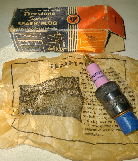

A couple years ago I bought a T that had a set of Firestone Polonium spark plugs in it. They seemed to work fine but I eventually replaced them and put them up in a cabinet. I came across them the other day and was curious to know if anyone knew much about them. Are they a better plug by being radioactive or was it just a gimmick?

It’s a gimmick, a remnant of “Atomic Age” marketing, “put the power of the Atom to work in your car!”
Idea was polonium would help ionize air, improving spark.
Check the half life of polonium, and you will see why it sure did not last long or work well.
They were often (not always) a lovely Pink, if you enjoy that…

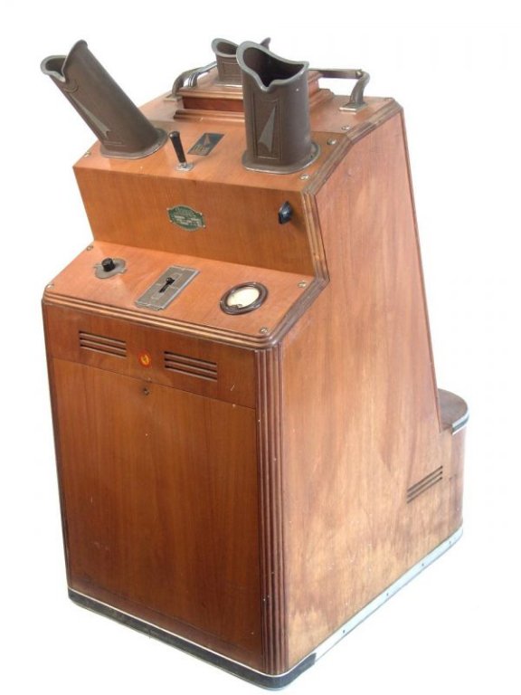

Radiation was thought to be a good thing, or at least harmless.
If you were born before the war you probably remember sticking your feet in one of these at the shoe store and watching the bones in your feet move when you wiggled your toes. As you can see, Mom and the salesman could watch too. Eventually somebody figured out that radiating kids' feet was not a good idea.

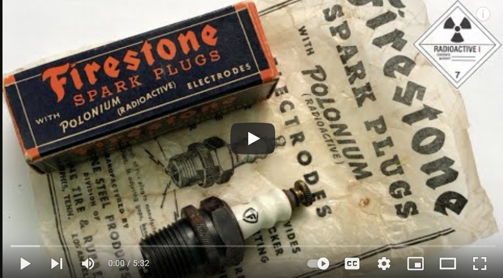

Neat Youtube about them https://www.youtube.com/watch?app=desktop&v=pBHmScF7-ww --
