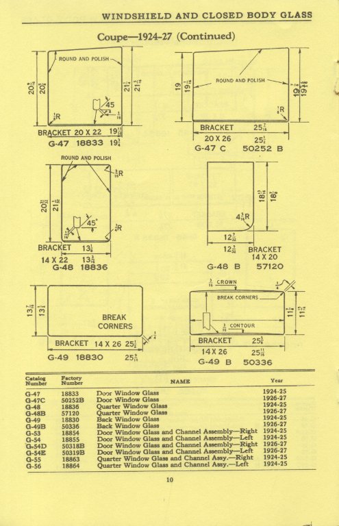

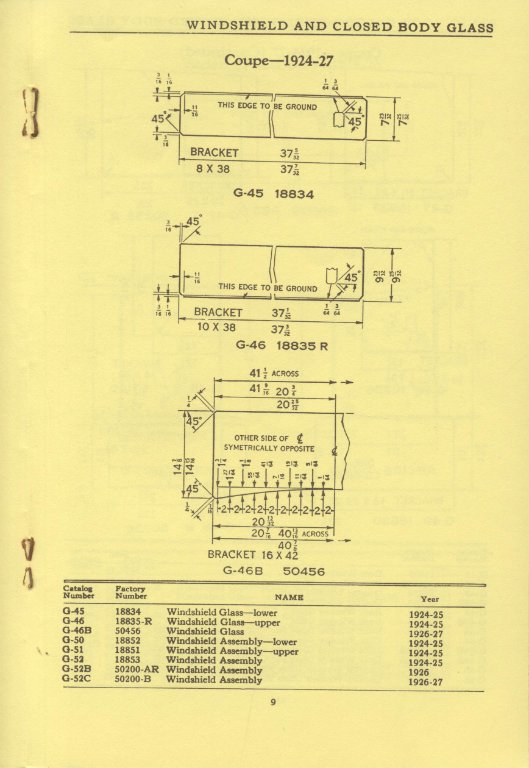

Re: Windows
Here are the glass dimensions in case the glass shop can't or won't use your old glass for patterns.
