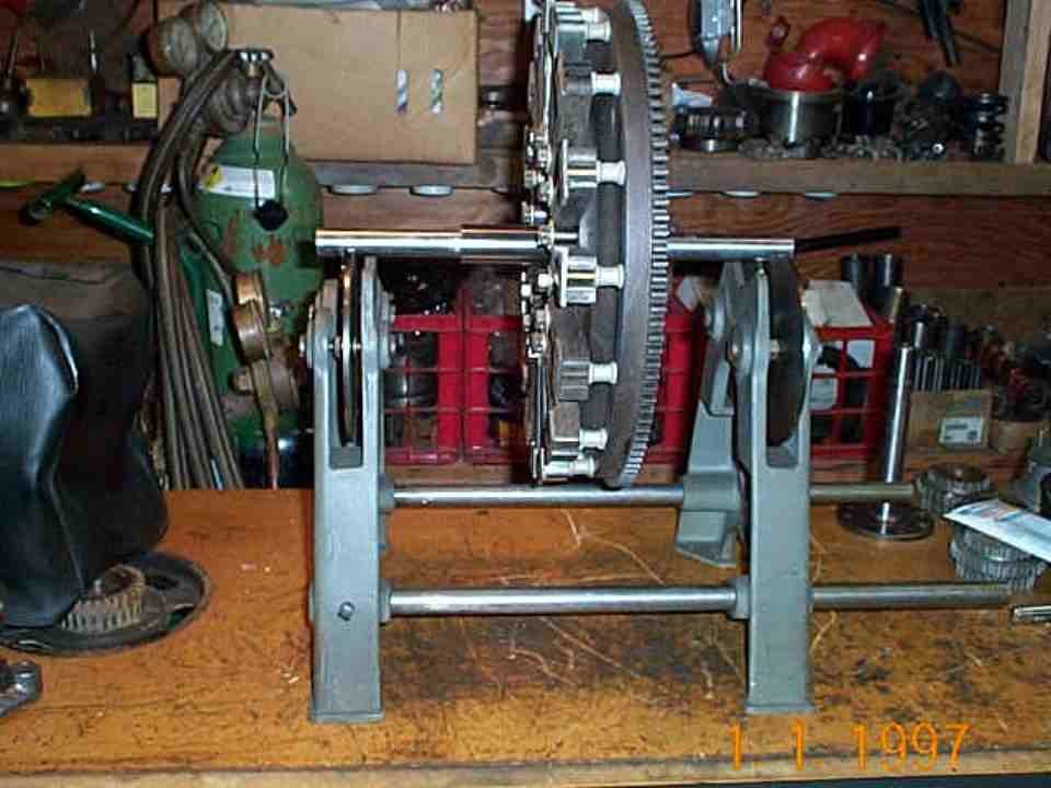

I balance flywheel or flywheel/magneto assemblies using two transmission main shafts end to end for a mandrel. I make sure to offset the key slots for the clutch hub 180 degrees apart. Then the unit is static balanced on precision leveled knife edges. This procedure is accurate far beyond what is needed for a model T. In fact I sent one of my static balanced units out to be spun on a dynamic balancer at a speed shop. It came back with two 1/4” holes drilled about 1/8” deep to zero it out. I also made mandrels to balance the transmission drums on the same rig. They are much more difficult to deal with.

Eric does as I do, except my "precision" edges are ground down back edges on 14" hacksaw blades. It is easy to determine the heavy spot and have at it with a 5/8" drill in my drill press. The hardest part is repeating the drill/balance/drlll a bit more/ balance cycle until the heavy spot goes away. I too had one of my own primitive jobs balanced by a machine shop, with just a smidgeon more in one hole, "just because we could" was their verdict.

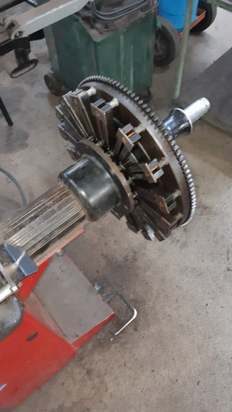

Post by dykker5502 » Sat Jan 21, 2023 7:13 am

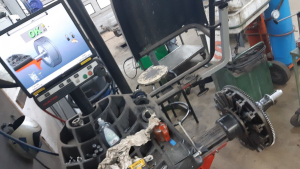

Well, a flywheel is a wheel like any other whell I presume :-) so I have twice with great succes balanced a model T flywheel with magnets and all on a regular wheel balancing rig:

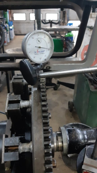

The cone on the axle ensured that the flywheel was centered but I had to measure for a little tendency to wobling, but a hit with a rubberhammer could get it right. Just to be sure I checked both axis:

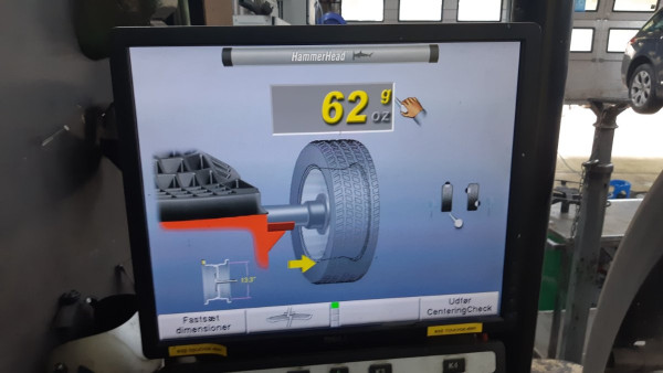

Initially it was quite out of balance!
It shows where to put the balancing weight. Well, we can't do that, so we have to remove that weight from the direct opposite place :-)
So how much steel to remove for 62 grams? Well, drill and meassure, drill amd meassure and at last it's OK:
You can see the final turn here (Youtube video).
And the final result here:
"OK" means it's within +/- 2 grams.
I have since assembled the engine and put it in the car and driven it - it goes like a Rolls-Royce :-)
Theoretically you can do both a static and dynamic balancing on a rig like this and I have done it on a 1926 Chevrolet flywheel, but it requires a certain thickness like a regular wheel, and since model T flywheels are so relatively thin, only static balancing is done here.

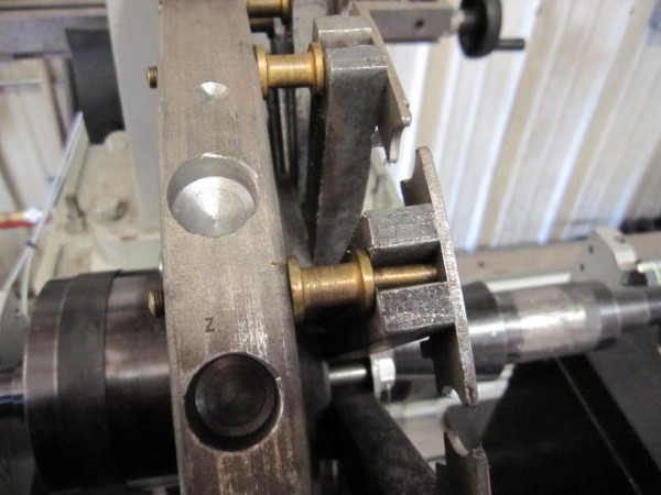

Post by J and M Machine » Sat Jan 21, 2023 9:48 am

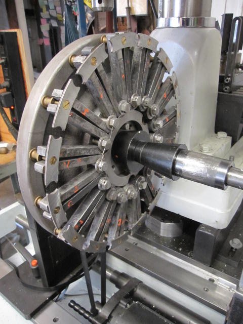

'Quote" If I sandwich the flywheel between two transmission shafts, bolt them together, and put the works on the balancer, will that be good enough, or is there likely to be too much runout in the shafts.
Yes You can get away with this to get it close but right way is to have it dynamically spun on a balancing machine.
I have posted pictures of most likely worst Model T flywheel we balanced showing significant unbalance of flywheel assembly.
I individually weigh the triple gears and then weight match them to each other.

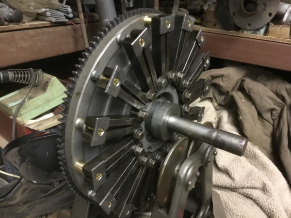

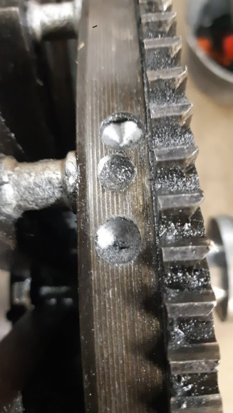

John's photo of the non starter flywheel is not like any Ford flywheel I have seen. Balance boring on the outer edge of the flywheel is not usual. The flywheels are balanced PRIOR to fitting the magnets on starter flywheels, as the boring registers are under the magnets. You can imagine how well that works when 16 heavy magnets and ancillary fixings are added. Often the balancing holes drilled on an assembled flywheel are in completely different positions to the factory ones.
Posts: 5500
Re: How to balance a flywheel?
Post by RajoRacer » Sat Jan 21, 2023 7:27 pm
It's a very early flywheel with those type of magnet bars.
I also use a Sunstrand static balancer.
