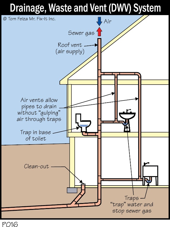

Sewer odors are often caused by problems with the drain "trap" which is a u-shaped section in the drain pipe near the appliance. It is supposed to retain water in the "U" which acts to block gases from the sewer line from reaching the home interior. The traps work in conjunction with vent pipes which usually pass upward and through the roof of the house. The vent pipes prevent build- up of pressure (or vacuum) in the sewer line from causing sewer gasses to bubble through the traps and into the home, and they also prevent any syphoning effect from water moving down the pipes from syphoning the traps dry, which will allow gases into the house. A poorly designed vent system, or any appliance with a clogged vent, can cause sewer gas to defeat the trap or traps and get into the house from time to time. In some cases, a very windy day can cause water to be sucked out of one or more traps. A clogged or inadequate vent can also cause slow drains. This can mimic a clogged drain pipe, but cleaning the pipes will not cure the problem if it is a clogged vent. A good plumber should be able to locate your problem and correct it. If any appliances that have a drain have been added to the system since it was originally built, or any bathrooms have been added, be sure the plumber knows about it.

The are several possibilities. My first thought is that it is NOT from your drainage system since its been gone through by you and plumbers, but the on/off smell still makes it a possibility. Now you may have tried all these things
The drainage system is supposed to be vented to the outside and the "trap" under the sink to prevent sewer odors from cumming up through the sink by it being filled with water above he U to act like a seal. Now the question is if for some reason that water level is not being kept high enough in the trap to prevent the gases from cumming out. So when you get the smell turn on the faucet enough to fill the trap (or if you have a probe look to see if there is water in the trap high enough ). Give the room a chance to clear - now if the smell is gone then the question is what is sucking the water out of the trap. Make sure the outside vent isn't clogged by a bird, varmint,or bee's nest. That would cause the drainage system to react like a vacuum when a filled sink, bathtub was emptied or toilet flushed.
The other possibility is the water itself. Here there are several possibilities city water vs well water. Another possibility is that most all water heaters have an anode rod to prevent corrosion. When these deteriorate to a point that some are known to cause a sulfide smell. So how old is the water heater?

Regardless, the p trap should prevent any sewer gasses or odor from coming up the drain pipe. Have you tried dumping some bleach in the drain when the odor appears?

P traps can fail to function properly for the reasons outlined above. The problem often comes and goes, depending on a number of factors. The odor of sewer gas can vary widely, even from day to day, due to the various soaps, detergents, scents, water conditioners, waste, use of garbage disposals, dishwashers, washing machines, bleaches, drain chemicals, etc. Appliances that pump water into the system, like dishwashers, disposals,, and washing machines, can provoke both overpressure and vacuum problems when a clogged vent exists. Flushing a toilet can also cause both overpressure and vacuum problems in a system that is not venting properly.

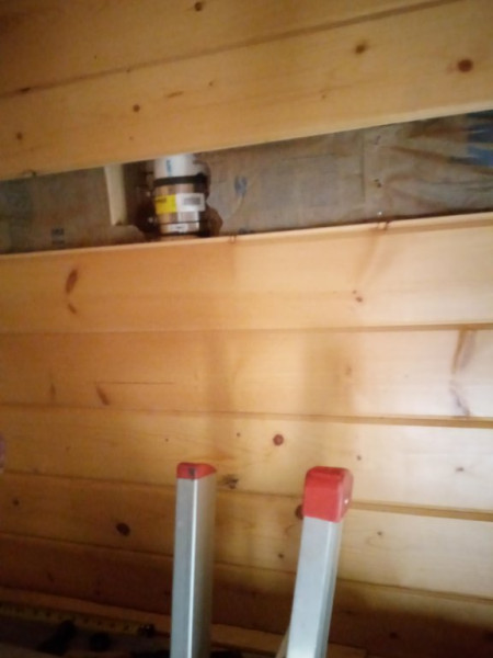

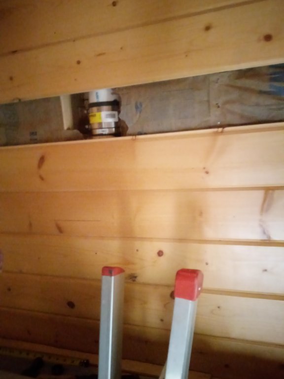

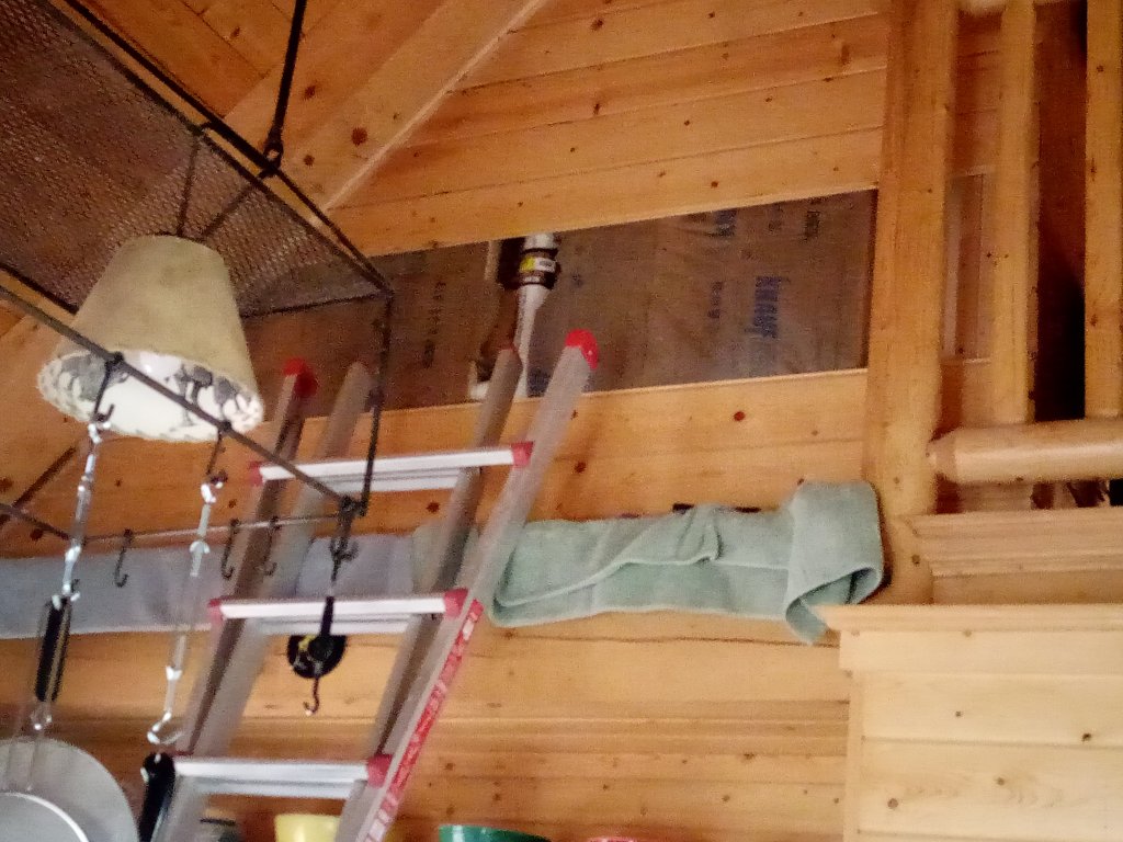

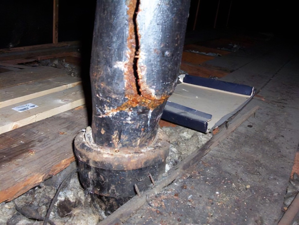

My cabin has had a horrid smell in the kitchen periodically and stops for days and then restarts. The kitchen ceiling is 2 stories tall, with the upper portion being a wall to the upper loft. We determined that it was directly related to wind direction. The roof is steeply pitched and when the wind blew from the West, it apparently "piled up" against the roofline and created pressure in the pipe, forcing the odor into the wall/house. For other reasons, I had to open up the wall. While inspecting, I accidentally discovered that the vent stack was at one point, two sections, joined (illegally) with a rubber boot inside the wall. The boot had failed, and thus, we got sewer/skunk smells in the wall (detected from the kitchen below) and now also found the reason for the dripdripdrip we'd here during our one or two annual heavy rain storms or occasionally in the winter (snow cones grow on the vent and drop back into the vent when it is -30F and then warms up). It was impossible to section in a PVC sleeve the way things were configured, so made a custom boot out of PSA rubber sheet (wrapped twice), sealed with Geosil sealant and clamped (like originally) with two pipe clamps. Since the wall is tongue and groove and took a long time to get the first board out (plus the others) I made 1 board easily removable next time, and the rest are minimally secured now rather than with a million and one air-gun nails.
I am strongly suspicious that you have a failure of the vent stack within your wall as it lines up well with my symptoms. You should be able to have a plumber run a camera down from the roof and see what is going on.
Finally, we get HUGE winds here. Enough pressure changes in our vent system that water in the toilet bowls will heave up and down at peak gusts occur. As dry as it is, occasionally, some of the lesser used fixtures will have the "P" traps evaporate enough that the blowing wind will be heard from those fixtures along with, of course, foul odors. Once a month, we will pour a pot of water down all seldom-used drains to stay ahead of this phenomena and we now rarely have odor problems due to it.
Two separate issues, but the same result: PHEW!
location of broken rubber coupling:

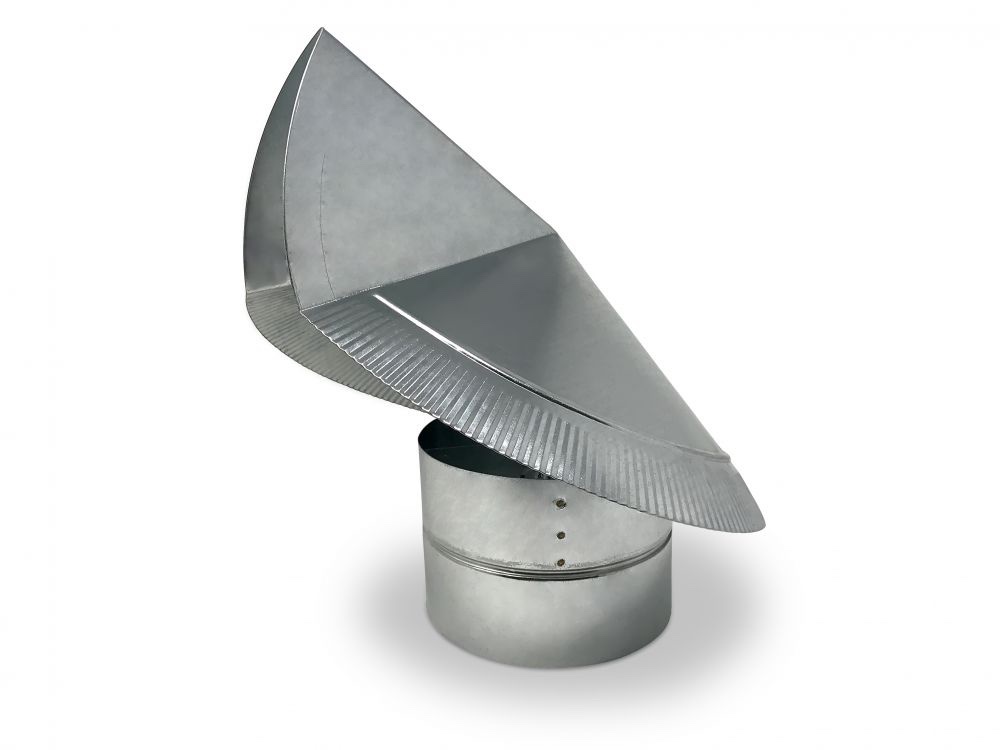

Im thinking Scott is onto something. Wind on a roof can pressurise the vent pipe. The vanity sink usually has an 1-1/4 trap that could be blown open if conditions are right.

If excessive wind is a problem, you can install a directional roof vent cap equipped with a wind vane that will allow the air intake opening to revolve so that it is always pointing away from the incoming wind direction. Jim Patrick

The only thing keeping noxious fumes out of the house is water retained in the traps at each fixture. The traps cannot function reliably if there is a situation where either pressure or vacuum can develop in the drain pipe system. Pressure will cause gas to bubble through the traps into the house, and vacuum will pull the water out of the traps, which will also allow fumes into the house. Venting problems can lead to pressure or vacuum in the system, or both.

Are your drainage pipes PVC or cast iron. If cast iron, is it possible that the cast iron has cracked inside the wall, or a lead joint or rubber joint boot has separated or failed allowing sewage gasses to enter the house around where the drain pipe goes through the wall under the sink? The cast iron could have been cracked by being hit with a nail that missed the stud. PVC is harder to break, but it can be done. Also, the plumber who installed the vent could have neglected to apply PVC cement to the joint and it could have separated. A camera lowered down through the roof stack might be able to see if this is the case. If the problem is the water being siphoned out of the P-trap, it is possible that the U of the p-trap might be too shallow and getting deeper p-traps might be the remedy for this phenomenon wherever it occurs. Jim Patrick

- Posts: 8665
Re: Need help, off topic, please read.
In cold weather, moist air rising through the vents could form frost in the portion of the vent pipe above the roof. Insulating that portion of the vents would prevent that. Snow accumulating around the vent outlets could cause issues.
If the flapper device is somehow restricting the free flow of sewage, flushing a toilet or operating a washing machine might cause the line to "burp" back through one or more traps due to a rapidly rising level of fluid in the line. The 15' drop might prevent actual backup, but some pressurization could still occur.
Adding an additional vent near where the line exits the house might solve your problem. Some sewer systems have lift pumps that operate intermittently. Such a pump could cause water to rise suddenly in the system and cause an unusual back pressure surge on your line, especially if the flapper was not functioning properly, which might briefly push gas through one or more traps.
