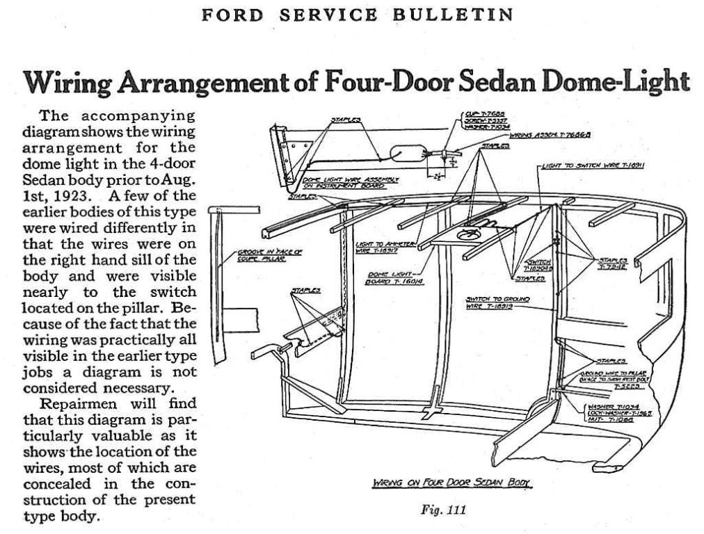

But....if you do want to add one to your Centerdoor, here is the schematic for the Fordor cars with those dome lights!
(Click on image to enlarge)

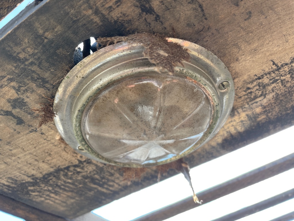

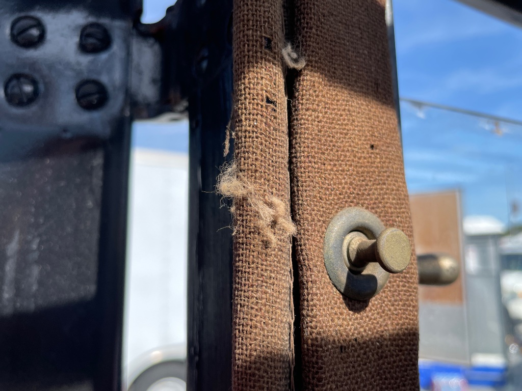

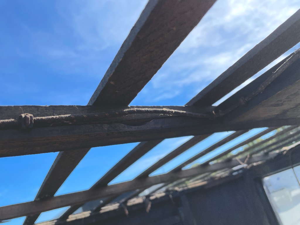

And photos of a 1926 Fordor showing the wire staples ( old time paper staple) holding the wire to the dome lamp. The lamp, and the switch type.
