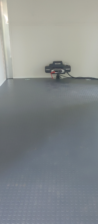

I installed a winch last year in my enclosed trailer that has a rope lead. Absolutely love it. Doesn't mark up the floor when you free spool it out and you don't need to worry about small wires poking you.

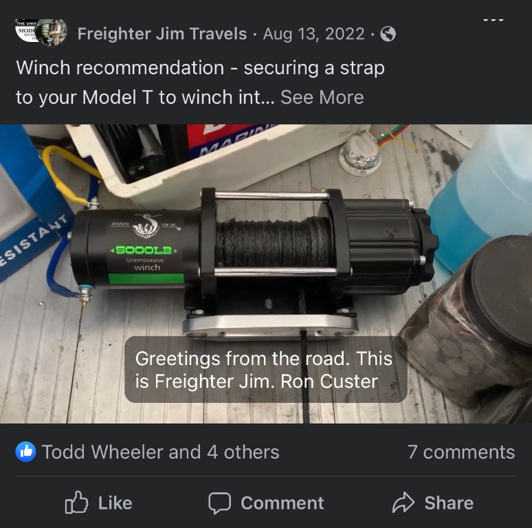

Tom
I added an all aluminum enclosed custom
car hauler trailer last Spring that I am using.
I researched & bought this winch on Amazon.
I am very pleased with it.
I recommend you go to a Batteries Plus
or similar store to buy batteries for the
remote & have them installed because
the tiny cover screws on the remote control
are difficult to access.
@ https://www.amazon.com/Tyrannosaurus-El ... TO807sVsVU

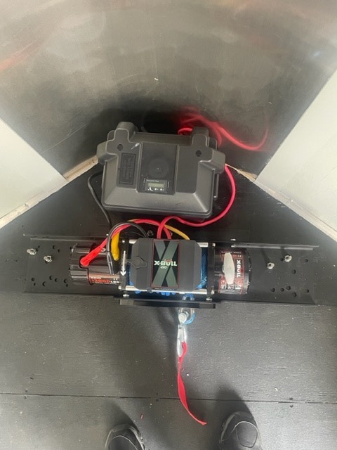

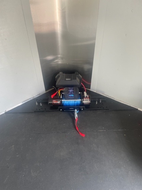

I bought a X-Bull winch. I was looking for a winch with rope, wireless remotes. I ended up with a 12,000 pound unit, it came with two wireless remotes. I don't know why two. Also, a wired remote. I wanted wireless in case I was loading by myself. 12,000 is a bit of overkill as I'm not lifting a car up off its wheels! X-Bull was cheaper than Harbor Freight, but I suspect it's made by the same company. I bought the mounting plate from HF and it fit perfectly. I bolted the mounting plate to the floor with U bolts, 3, going around the frame of the trailer. The battery is wired to the charging circuit for the truck. I carry 2" PVC pipe that I put in the gap where the dove tail and the trailer meet so the rope has a smooth surface in case the rope is down that low. Won't drag on the floor wood.

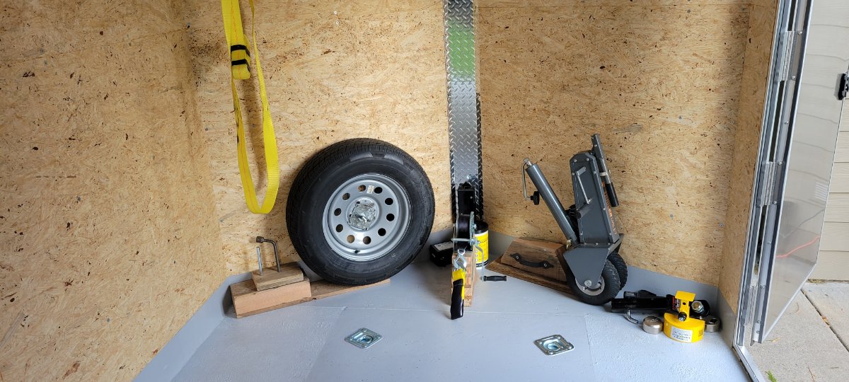

I put a Harbor Freight Badland Apex 12,000 pound winch in with the synthetic rope. Definitely overkill but it was on sale. Also, I mounted a piece of 2 1/2" tubing to a plate and bolted it to the floor. Mounted the winch on 2" tubing and slid it in with a pin. Now the winch can come out if needed, put in a truck receiver to use it or on my open trailer which I have the same mount. I wish I could show a better picture but the trailer is in storage for the winter.
