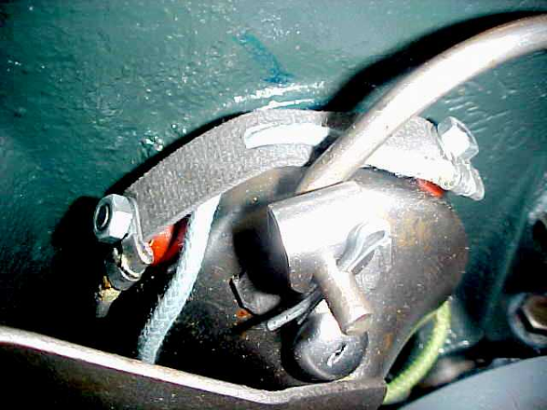

Commutator wire retainers are shown in Lang's catalog (5033B) page 77. Should I use these? They hold the wires, but what are they attached to?

Post by TRDxB2 » Tue Apr 11, 2023 12:22 am

They just fit under the nuts that retain the wires. They were on my unrestored '22 Centerdoor so I guess Henry thought they were a good idea but since they fell apart when I replaced the wiring harness and I didn't replace them I guess they are not necessary. I don't have them on any of my other cars either.

You certainly need these installed as they are there for a reason.

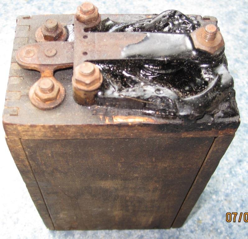

Factory #2124A Commutator Wire Terminal Retainer introduced in 1921 and two are required. This part addresses a common problem with Timer to coilbox wiring (near the Timer) chafing and shorting to adjacent bare metal and also forms the wire routing and relieves the strain on the wires to the timer terminals which break from constantly moving when the timer case rotates.
If you don't use them you risk the possibility to develop a short to ground in the timer wiring because these are not installed the coil will exceed its duty cycle and cause the problem shown in the attached photo. When the tar boils out the top of the counterbore on the wooden coil top it also jams the points closed exacerbating the heating process. Don't use them at your peril.
Ron Patterson

If a timer terminal wire shorts to ground and you drive 25 miles on a warm day one of your coils will look like the photo I supplied.
Good luck

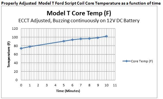

Timer wire retainers and/or a 4A fuse in series with the coil box power wire are good safe guards against wiring faults. That said, Wow! How the heck was that coil adjusted so the duty cycle caused thermal runaway and melt down? Gosh!
A properly adjusted Model T coil, tuned for equal and consistent Firing Time, will NOT overheat or melt the tar out if left buzzing continuously on 6V or even 12V battery for a long time in my experience. Here is how I know: viewtopic.php?t=20556#p157543

As the self appointed Model T ignition system expert (and pitchman for your products on this forum) perhaps someday you will figure it out?
So says the legendary FP forum pitchman from days of ol who goes by the moniker "Coilman"...... I DID figure it out! By actually studying and testing Model T coil operation rather extensively. Did you bother to view the link I posted? 102F after 10 minutes buzzing continuously.
Coil Core Temperature Vs Time.JPG (42.46 KiB) Viewed 2458 times
Proper coil adjustment really is not all that complicated and would be happy to discuss the technical details and dispel the myths further for the benefit of others here if you can leave the personal animus and snide comments out.
