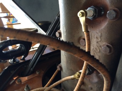

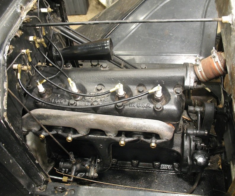

When the new set arrived, I noted the cloth cover on the cables was a sort of plain, olive drab color and not lacquered. The wires I had been running have a cloth braid, a "tiger stripe" yellow, and are apparently coated. My question is, if authentic 1913 "purity" is an issue, which is correct ? Either ? Both ? Neither ? (I like the yellow tiger-stripe better).
To end the story, I haven't yet changed the plug wires. As Steve J. is wont to quote, having them wahrs "fried" didn't hurt the runnin' of it none . . . so I left them on. My nod to the fashion cult of "patina", as I continue to wear out my Model T while I enjoy using it ! (Plug wire photos below)

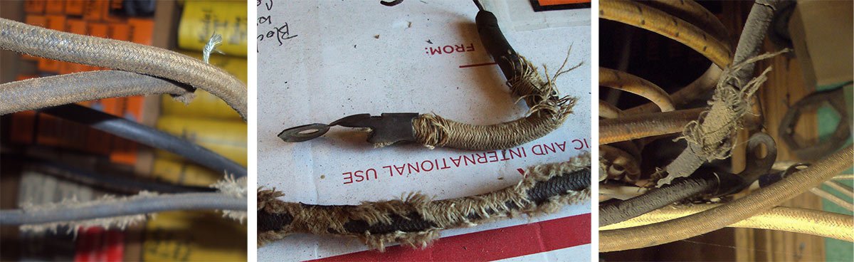

I can't speak to 1913 but your top photo looks awfully like the original wires on my 1923 White (left photo). These are other wires I have thought to be used in the '20s.

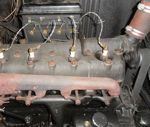

Don't know who's T these are from, but its a "period correct" fix in my book :lol:

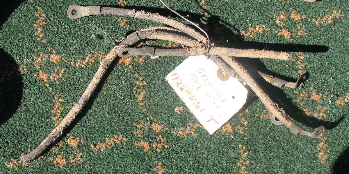

I don't now if they would be the same for 1913, but I saw these 1922 wires for sale at an auction. I can't tell what color(s) the cloth covering was when they were new. The color faded long ago. I think the only way to know original plug wire colors would be to find original wires that were stored in a dark place.

Steve, what ever those you show are they are very prevalent. I have seen those on many, many coil boxes and magnetos. I believe the ones my first photo shows is a less weathered one of those. Someone may know when this was first used.

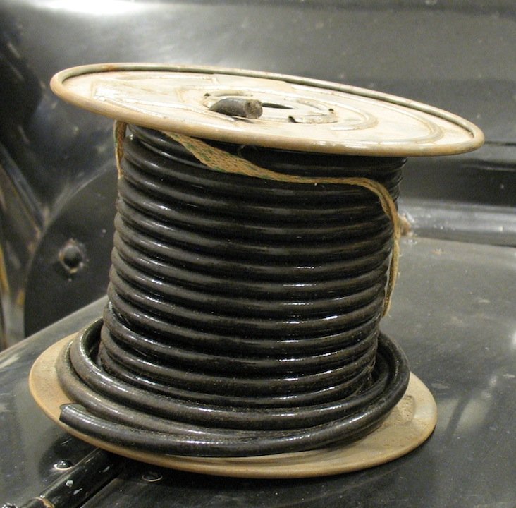

I'm another who years ago bought a roll of black lacquered plug wire. It may not be correct, but it works.

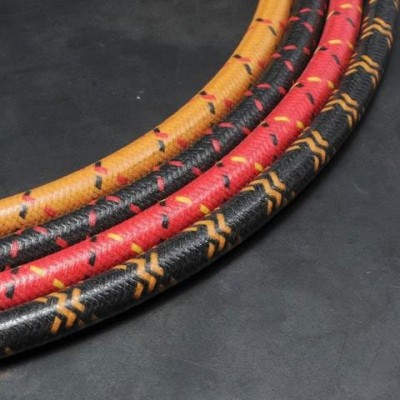

the brown wire (saddle color) is 9mm with a matt finish the 9mm Black with the double red stripes are also matt finish The 9mm oak with the black tracer is a gloss finish. We mfg these for Langs, Mac's Birdhaven etc.. www.rjlautofasteners.com

FWIW the motorcycle restorers offer a wide range of wire types. This is just one site.
https://revivalcycles.com/products/revi ... -cable-kit

Rich alot of those wires are 7mm unless you are putting on a distributor

Rich, those are pretty !! The offering looks like what is offered on the tractor restoration link George posted. 9mm is 3/8", 7mm is approx. 3/32" smaller. A thinner cable would work as well but the difference is noticeable visually.

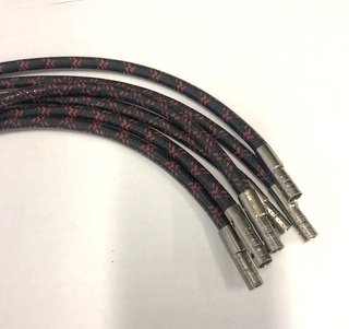

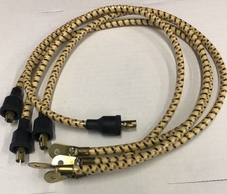

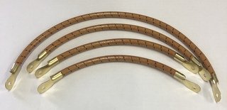

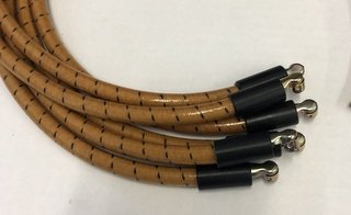

Post by Sparknwire » Mon Jan 14, 2019 6:33 pm

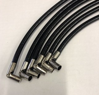

These are some of th e wire sets that we mfg. We also do custom wire sets.
