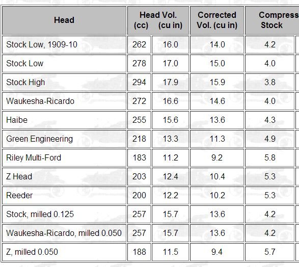

Re: Cast Iron High Compression Head
A Low head has slight higher compression than a high head.
“I hopped up” my 21 Touring with a low head that I bought with a 17 engine. If I remember. the earlier T’s with the low heads had about a one HP boost then the later high head T’s.
Of course a T’s weight has a little to do with its performance. We have to remember a stock T is around 20 HP more or less and there is only so much you can do with 20-21 hp.
If you mill a high head you might get closer to the performance of a low head. BUT that’s my opinion and others will have theirs. Max milling on a high head is 60 thousands or so I’ve read.

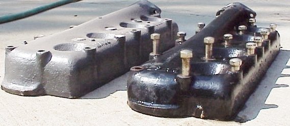

A period Waukesha head will have a vastly improved combustion chamber and yet adds very little additional compression. It gives very solid performance improvement with little to no additional stress on the bearings. I love them. And they're cast iron.
Does anyone make them today or do you just need to find an original? Does anyone have a photo of a Waukesha head?Scott_Conger wrote: ↑Sat Jan 28, 2023 9:41 amA period Waukesha head will have a vastly improved combustion chamber and yet adds very little additional compression. It gives very solid performance improvement with little to no additional stress on the bearings. I love them. And they're cast iron.
some good pix and info here: http://www.mtfca.com/discus/messages/80 ... 1239063958
and here: http://www.mtfca.com/discus/messages/25 ... 1350846062
they were made in the same time frame as the T for both T cars and some industrial engine/agricultural uses
