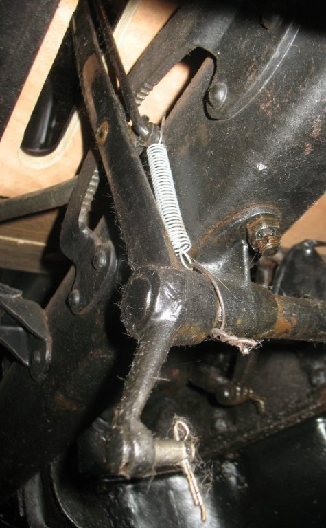

I may get around to that job someday, but if I don't it doesn't matter.
This temporary fix from the local hardware store is still working twelve years later.

Thats very much like what the vendors sell, but you dont have to wait for the mail.

Steve, that's exactly what I replaced. I had that on there for years and finally wanted to make it original.

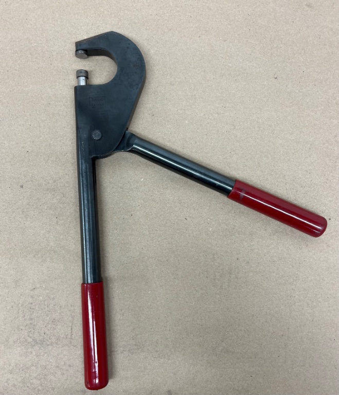

Hey Dave! This is what I used. Worked great, no need to heat the rivets, I squeezed them cold. I was able to keep the handle attached to the brake lever also. Let me know if you plan on doing another one.

Great tool tip, Ed; thanks for sharing. The original rivets in that spring & lever certainly were never heated during assembly. jb

Great to know, Ed. Thanks!
