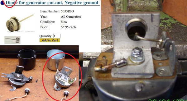

- Posts: 6541
Re: Generator Cutoff relay
Modifying an existing cut-out is a relatively simple task - just buy one from Lang's or eBay (32-748 Diode, 25 Amp 200 Volt 1/2 Press-Fit)
Not all cut-outs have the same insides as pictured (2 different pictured)- but their bracket is insulated to the base
1. Carefully remove the cover. usually one or two small take welds
2. Remove the solenoid parts and like the bracket
3. drill out a hole for the diode. The bracket acts as a heat sink
4. solder to previous point used by solenoid to battery
5. Replace cover and secure with silicone seal
6. Bench Test - continuity from generator connection (+) to battery connection (-). No continuity with leads reversed or either connection to base or cover.
