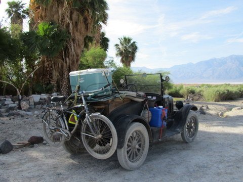

Post by Norman Kling » Wed Feb 01, 2023 10:56 am
Dennis,
Where is that picture taken? I have been to Madras Oregon and looks nothing like that. That picture looks more like Palm Springs, Ca area. Did you drive your T down there?
Not many date palms in Oregon. I think Coachella Valley is a pretty good guess.

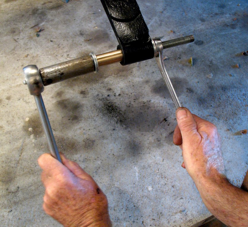

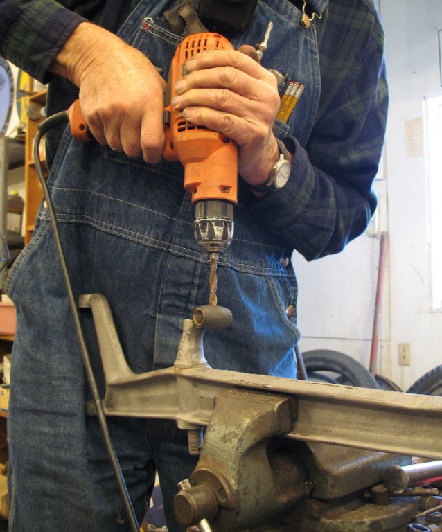

On the front end: Bushings cost a lot less than shackles, so I use bronze bushings to take the wear. Ditto for the rear.
If your car uses flip top oilers, don't forget to drill the bushings for them

Post by Dennis Prince » Wed Feb 01, 2023 1:39 pm
Norm, that picture was taken at the Saline Valley Hot Springs in Death Valley Park. The Saline Valley is a valley west of Death Valley it is 45 miles of dirt road in from the south and 55 miles of dirt from the north. If you are ever in the Madras area stop in for visit.

Thought that was Saline. Here's another.

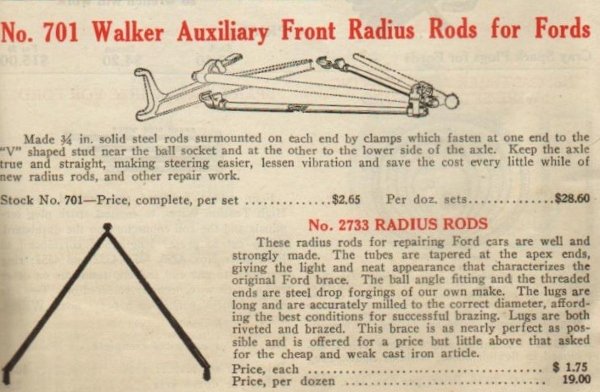

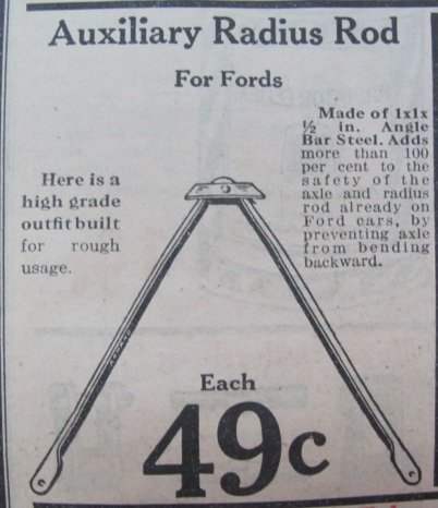

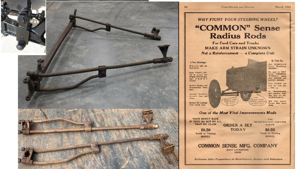

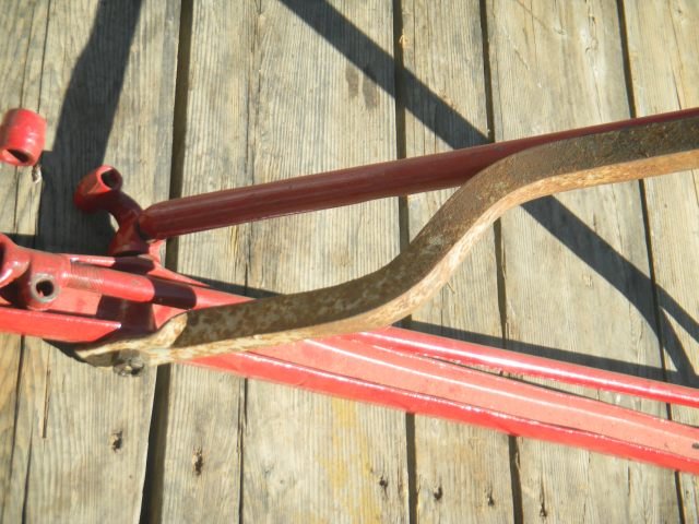

Im looking for a auxiliary front
Wish bone support, anybody have photos or one
for sale. Photo from the internet somewhere,
don’t remember where.
Wish bone support
Wish bone support
Posts: 6586
Re: Front End Strength

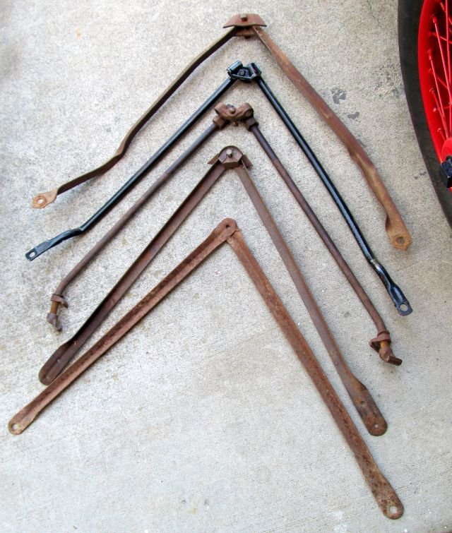

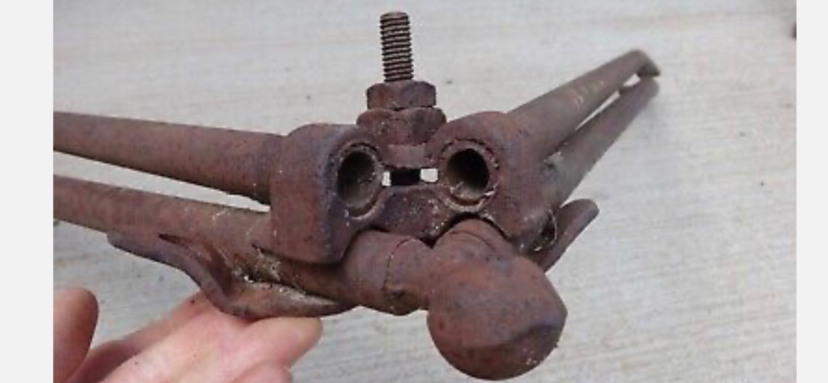

Post by TRDxB2 » Thu Feb 02, 2023 4:08 pm
Charlie_26_TT_Ccab wrote:
Thu Feb 02, 2023 1:28 pm
There were many variations. I think I have the top one. I'll check to see if I have everything. Many are designed where the radius rod was attached to the perch above the axle and the accessory bolted to the perch under the axle
For the later style perch
