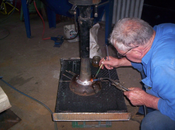

My brother has 52+ years' experience with soldering, Radiator service, as our father before us, the only soldering iron jobs would be on galvanized sheeting like fuel tanks. To get the heat in and a good flow a torch is used. This photo was when we pulled apart an axle housing, bead blasted, tinned and re-rivet, sealed with solder.
