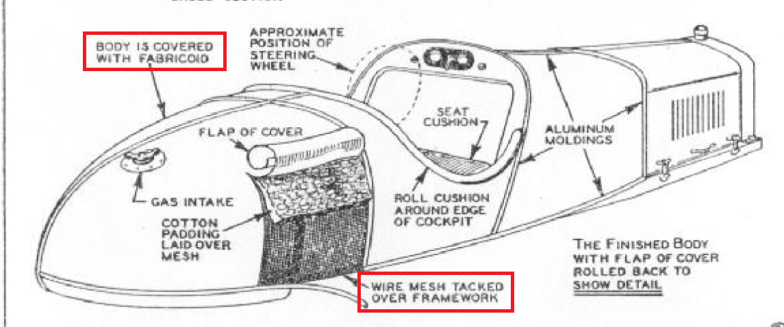

Fabrikoid consists of cotton cloth coated with pyroxylin (a less nitrated nitrocellulose, dissolved in castor oil, alcohol, benzene and amyl acetate). Fabrikoid has been used for luggage, bookbinding, upholstery and dress trimmings

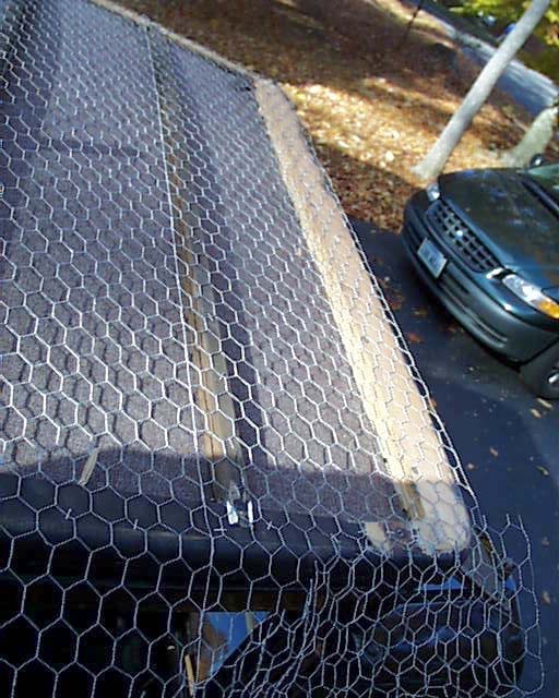

I don’t know if Ford ever used chicken wire on the assembly line, but here are a couple of pictures in which modern day T owners used chicken wire on top of the wooden frame of a new roof on a 1926 Model T coupe. Jim Patrick

It would be a good idea to place felt or something similar between the wood and the chicken wire to prevent any chance of rattling or buzzing due to vibration.

I always liked this approach - kind of like the old tube and fabric airplanes of the day. Actually, I considered doing something like doped fabric and tube for a speedster body - Of course, they would be a disaster if rolled, but you couldn't beat the weight savings... Also thanks for reminding me of the "recipe" for Pyroxylin... ;-)

I used chicken wire in my 24 T Coupe and it’s doesn’t rattle, click or nothing like that. As tight as it’s pulled over the roof line I don’t see how it could. Putting in some kind of sound deadener is overthinking something that’s not necessary. But that’s my opinion. It all goes back if you want to put in an improvement or not in something you can’t see after it’s finished.

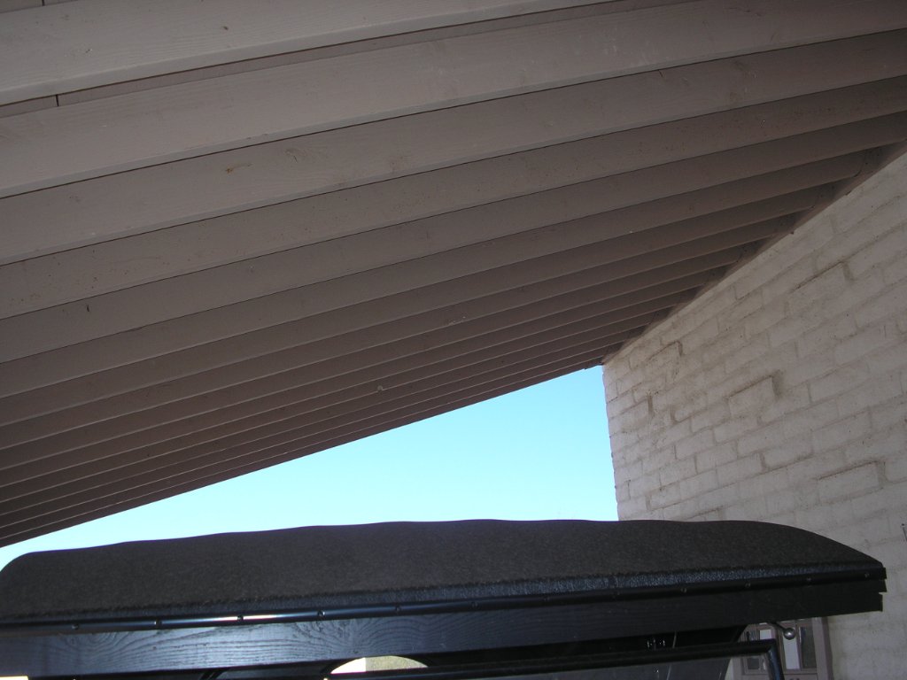

I guess chicken wire would have made the top smooth rather than wavey. I am getting ready to build a canopy top for my express bed with screen sides. I do believe i will apply chicken wire to the top. First, a layer of black fabric, then wire, then thin padding, then top material.

Donald, I missed the photo of the top you showed. It shows that there are just 7 slats in that roof. That means wide gaps, and that leads to the sagging between them. Close the gaps to approx 1" and the dips will go away.

Too late to change the cab wood now.............The top wood I had duplicated 7-8 years ago from what was on the truck. It was in good shape except for the slats. I assumed it was original. Anyway, I am making the canopy wood following the same pattern as the cab wood. This time chicken wire. I will probably redo the cab also.

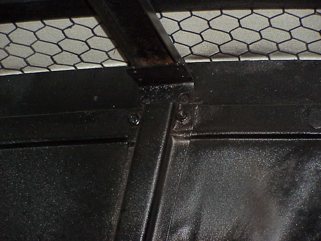

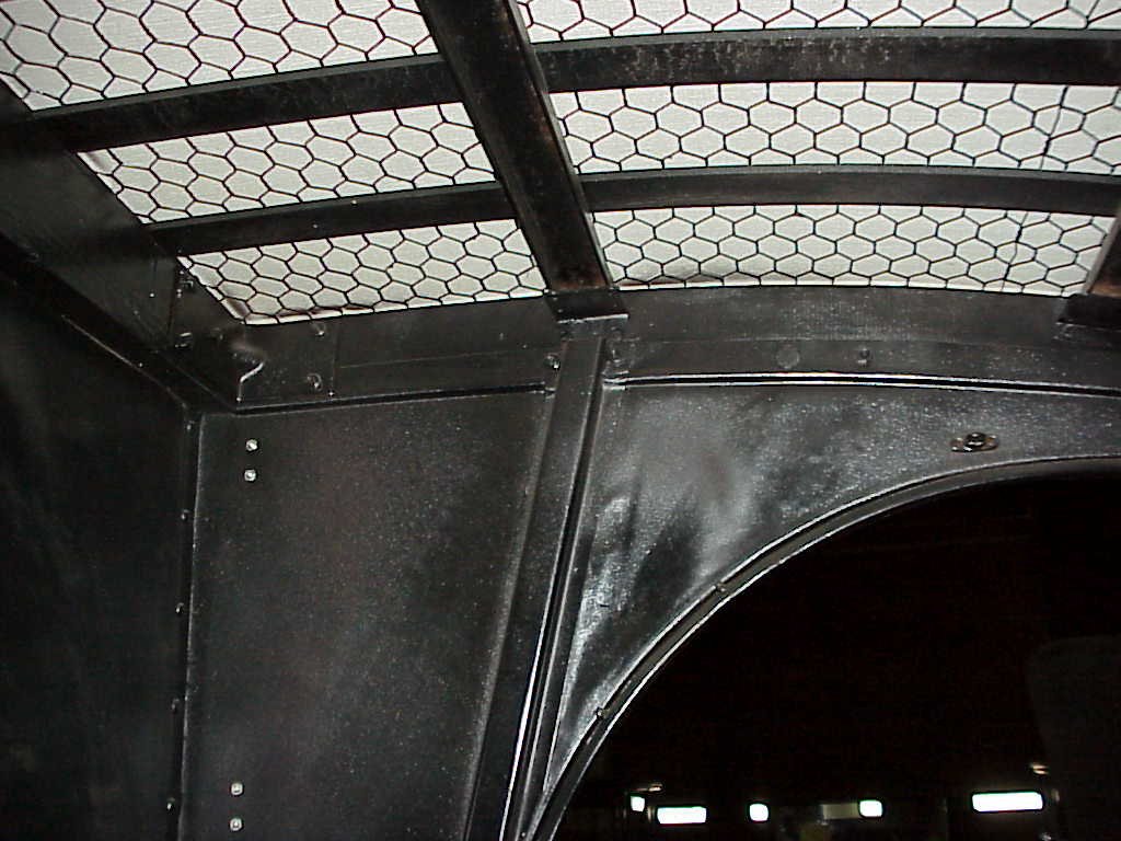

And then I found this buy accident, I was on a road trip thru NM, several years ago, stopped at a museum and saw this inside. Was more interested in the additional brace in the C Cab. My memory had it that I saw chicken wire in a T's roof somewhere,......well there it is. I did not note at the time the condition of the top wood, original or replaced at some time, but from the pics, it looks like the top was replaced. And the front corner brackets are incorrect. Should have laid down some black material before the chicken wire.

From a distance the backlighted cab roof resembles the chickenwire-reinforced window glass of the era, pretty cool, jb

Post by jiminbartow » Thu Feb 09, 2023 6:23 pm
Are C-cabs not upholstered on the inside? If they are usually upholstered, that corner bracket would prevent it. Jim Patrick
Posts: 5439
Re: Chicken Wire
Post by RajoRacer » Thu Feb 09, 2023 7:45 pm
No upholstery except where your butt & back go !
