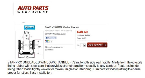

I had similar troubles using the vendor channels on my 27 Tudor. I ended up returning the kit and using channel sourced from Stanpro. They have been merged with another company now. I had to transfer the clips from my old channel to the new.

Thanks Gregory and John that's useful information.
