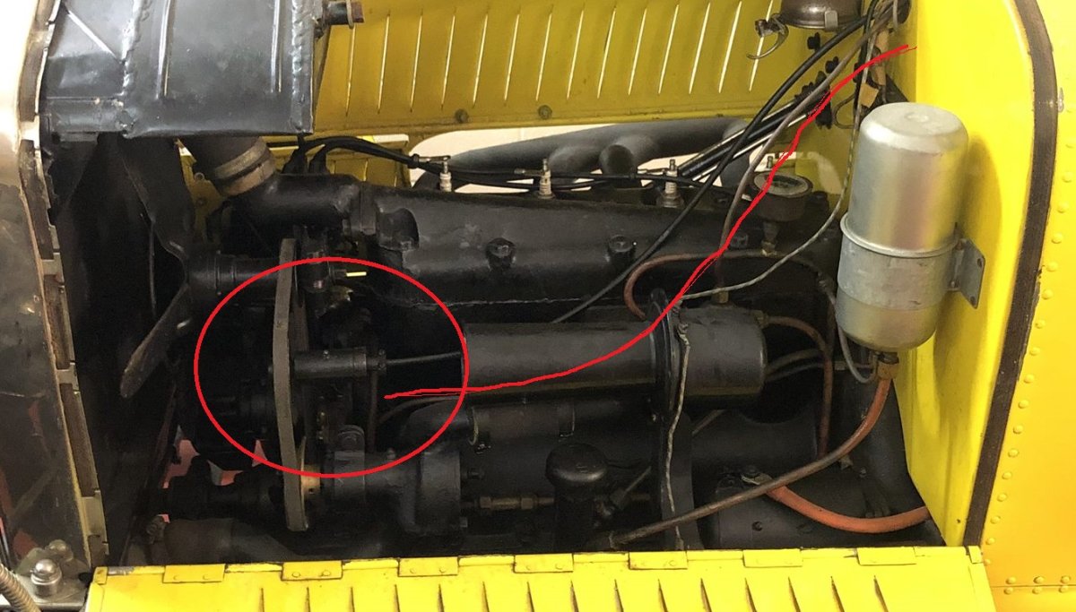

I saw an interesting drive on an English car that ran off the fan belt. It acted like a tensioner, but the pulley drove the tach. You might get some slip, but I don’t think that is a major issue and you can adjust the drive speed by adjusting the pulley size. You could do something similar and drive it off the back of a water pump (with some modifications) I am going to try making a tach drive running off the belt for my 26 speedster.

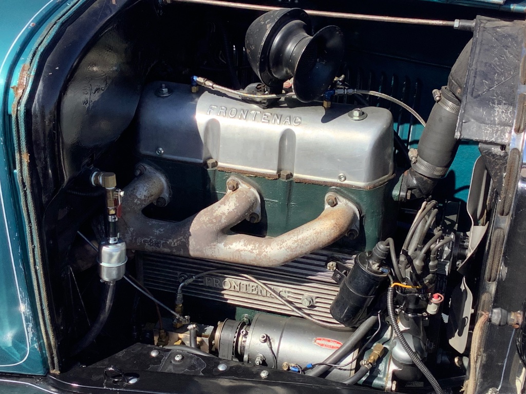

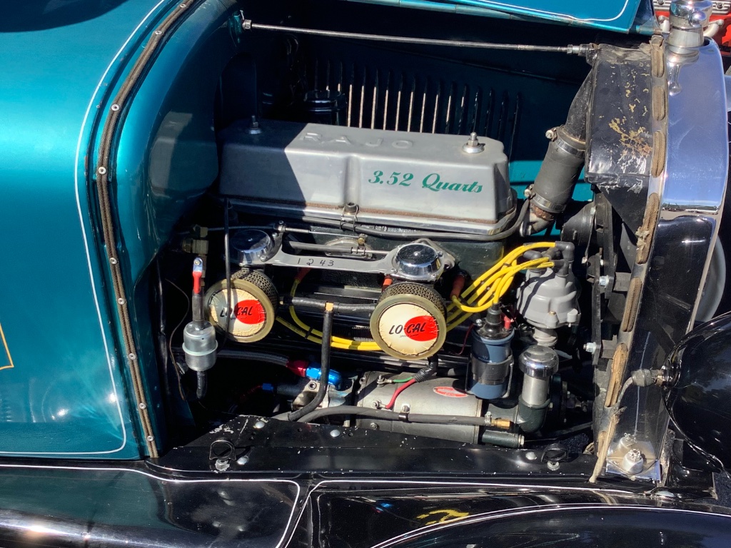

I feel like I saw a picture of a tach drive off the back of the generator on a speedster. Extended shaft through a sealed bearing mounted in the original rear plate I guess. attachment=0]81C37E8F-BC52-4E54-8084-816D70874A71.jpeg[/attachment]…may have imagined that after seeing the oil pump drive off the hour meter output on the fork lift genny or the Chevy truck one in “no1” and “no2”
Would run at camshaft speed so easy to double with a little gearbox or your brain gears, or repainted gauge face. I’d like a tach if I had an overhead or “high rpm” t motor just cause I love gauges and bell and whistles and such…-Chris, in Boulder.

I think what you're seeing there is an oil pump driven off the back of a non-model T generator. Cool stuff!

Yup. Those two generators in particular came that way. One is from a forklift and one is a 50 something’s Chevy pickup, so I was told. Can’t find the pic of the one out the back of the T generator, but same idea/layout.
It occurred to me that a housing and drive could be run there in place of the entire generator and its gear. Any of the side drive mag/waterpump combo set ups could include a tach drive pretty easily I would think. A distributor on a T would allow access to the front of the crank instead of a timer, if a cover could be modified right? Lots of shenanigans for a gauge we don’t really need but heck, any small nod to race car history is super fun and adds up tenfold in style points. The “because it works and because I could” factor runs high among the machinist type car builders too. (Check out Pete Aardema & Kevin Braun) Performance upgrade/conversation piece type mods will always be popular and enjoyable to see regardless of need or efficacy. Some just love to tinker, helps keep us outta the bar…-Chris, in Boulder

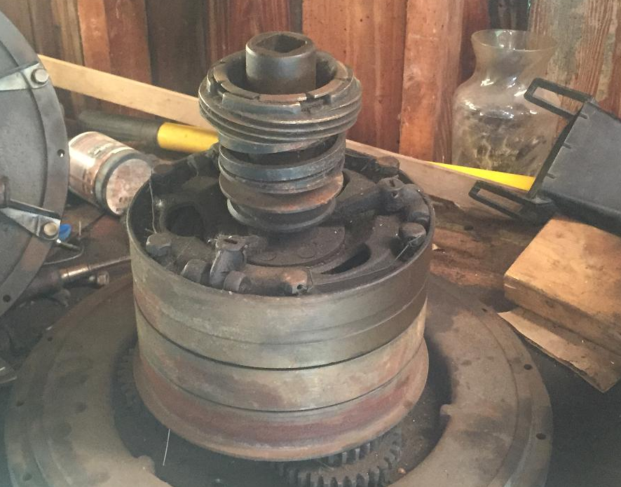

Ed, I have explored a transmission drive (Patterson or Nash which I have) only in concept.
The gearing could be a bit of a challenge for the Patterson spiral gear.
The Nash uses a square cut gear which may offer more options.
If properly calibrated for RPM in high gear it would be off for low pedal or
multi speed gearing. It would not operate in neutral .

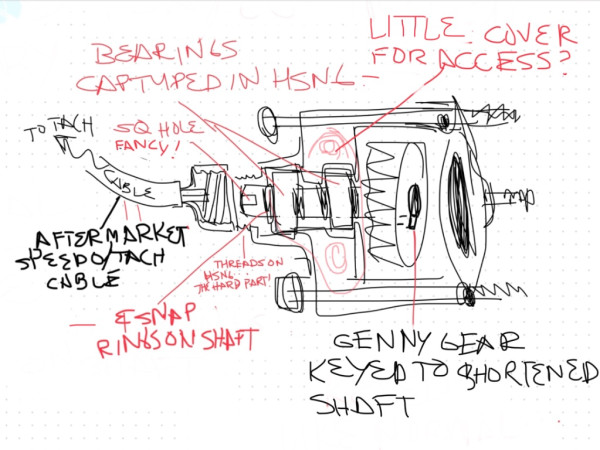

Whoa! Lots going on on there besides the tach drive- upper tank and a half, is that outlet and fan mount homemade or do something on the p-side as well? What’s that lurking in the shadow up front, distributor drive? That water pump/ oil pump combo sure is a stylish part, someone should repop that! Looks like oil pressure to the ahoogah motor….wait…. Hahaha! There’s a little manifold tucked in back there! Super clean setup considering the amount of shenanigans!
Belt drive cable housing mount sure is a simple solution. Is the housing “hanging” in an “alternator” type swing bracket for tension?
Anyone ever seen or tried a cable drive right off of the cam gear in the generator mounting area? Could be a machined casting or just a billet clod bolted up there like the side drive mag/pump combos. It would already be at half engine rpm and have oiling. Sorry for the crude and semi complete finger paint sketch, my magic pencil needs charging (that’s what she said), but you get the idea….
The generator runs faster than the crank. I don't recall the ratio but the gear is smaller than the crank gear. Maybe there is room to offset the shaft from the generator location to allow using a crank gear for 1:1 rotation.

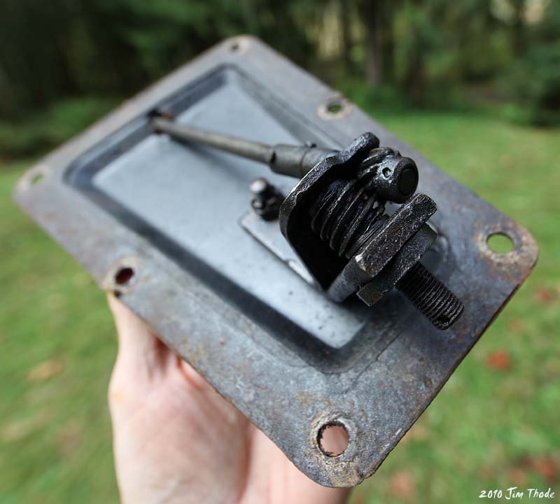

Harley offered an accessory tachometer listed for 61-69 big twins. Part numbers indicate 1965, -65 suffex.
Point being, the circuit breaker cover is replaced with one with a cable adapter attached to the "timer shaft"
This could be done on a T by modifying a timer, putting a fitting thru a clip on distributor, real easy thru a bosch front plate distributor plate,
(there is already a 1/2" threaded hole for the set screw that keeps the cam from thrusting forward), etc. to drive off the cam.
Might require a 90 degree fitting to clear the fan.
