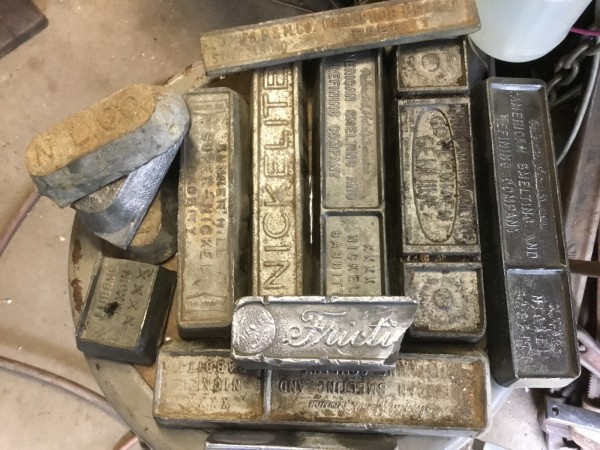

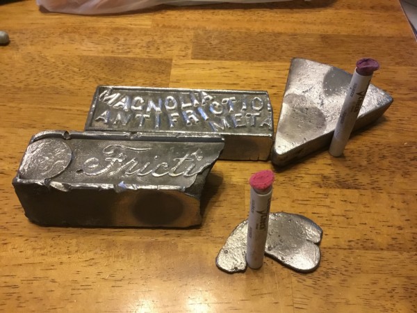

Anybody ever use a lead test kit to check babbitt? The gun at the scrap yard is broken.

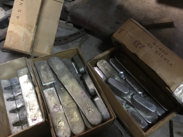

I’m with you when you say, know what you are buying. And not too long ago I lucked into 200+ lbs and got the MSD sheet. But I have been given and found a lot of Babbitt over the years. The Lead Test kit showed the Frictionless and the Magnolia not to have lead. The other pieces did have lead.

BobShirleyAtlantaTx wrote: ↑Fri May 03, 2019 9:51 amAnybody ever use a lead test kit to check babbitt? The gun at the scrap yard is broken. image.jpg
Sold by the Magnolia Metal Corporation, Magnolia Anti-Friction Metal is still available for purchase today. Introduced in 1886, Magnolia Metal (as it was commonly referred to) was advertised as "the best bearing material known to man and far superior than any other Babbitt." While there is no doubt that Magnolia Metal has it's applications and does generally perform well, it also has some limitations. Magnolia Anti-Friction Metal is a primarily lead based material but with the addition of graphite for to make it somewhat self lubricating.
Composition (approximately):
Element Percent
Lead 80.00%
Tin 5.00%
Antimony 15.00%
This product is equivalent to the following specifications:
ASTM: B23 Grade 8
According to the Magnolia Metal Corporation, Magnolia Anti-Friction Metal "meets all requirements for general use. Offers good resistance to compression and has the lowest co- efficient of friction of any known bearing metal... 1/3 that of genuine babbitt. Is graphite treated and largely self-lubricated. Typical Applications... Line shafting...electric motors 10 to 250 hp.... winches... pumps... propeller shafts... cement mills ... general machinery."
Pouring temperature for Magnolia Anti-Friction Metal is 750-825 degrees F.
Don't use it.
