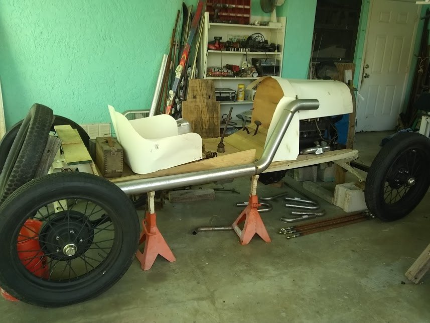

I would recommend changing out to a different steering box and not retaining the stock T steering. Dropping the rear can be done a few different ways and some can work with certain body styles and not with others. Having said this here's what I did. The front can be much easier to dial in than the rear as you can play with it up and down depending on those little bits (later spring, later spindles, chevy spindles, inverted eye etc) where you can gain or lose a half inch-inch. I opted for a rear Z but not massive making up the rest of the drop with a "bent" spring. On the front I used similar to a laurel bracket but allowing for a 4 link setup. The drop in the rear is "set" so as its assembled and weighted down I will be able to play with the front to bring it up or down so it all lays right without looking like a massive drop.

There are so many variables in Speedsters. Number one is making it safe with the modifications. Steering geometry when lowering or raking the front will be your first obstacle but not difficult. 8 leaves is not necessary 7 should work well depending on the condition of the spring.
I would set ride height first with an extra 1 1/2” in the rear. Be careful about going to low as the flywheel area of the pan can get a nasty hit. Normally, a 5/6” drop makes for a nice ride.

Another factor in this lowering problem is that the torque tube should never go beyond level- even on the biggest bump with your other-in-law riding with you. This is very bad for the universal joint! As I remember this gives you about 7" to play with. I have found that 7" is normally enough!
