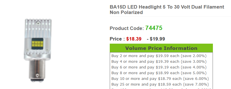

I'm guessing this is the bulb in reference https://www.ledlight.com/led-headlight- ... rized.aspx
For positive ground or negative ground. 5 to 30 Volt wide voltage. Long life up to 30,000 hours. Made with 2525 LED's for long life. Dual filament up to 1200 Lumen low beam. Works both in a socket that is wired for a single filament and works in a ba15d socket that is wired for dual filament. Up to 1800 Lumen high beam. The base is BA15D the diameter is 15mm with two contacts on the bottom and parallel bayonets.
I assume that you tested each individually and they worked.

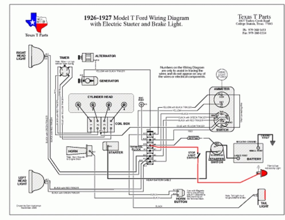

What isn't at all clear is how you are hooking these up. The wiring diagram shows that they are hooked up in parallel so each bulb is independent of the other. If both bulbs are good and work on one side and not the other then there is an issue on the bad side (ground, socket and/or wire connection). Something else too, even though they are non-polarized, you might try reversing they way you inserted the bulb that doesn't light in its socket. The reason for this is that even tough they are nob-polarized (for voltage) they are dual filament so both need to be oriented properly in their respective sockets for your High/Low beam to work equally

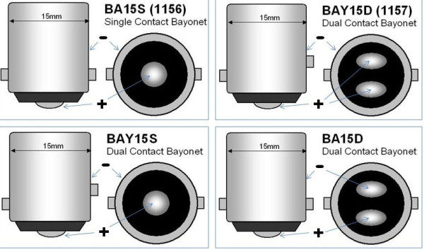

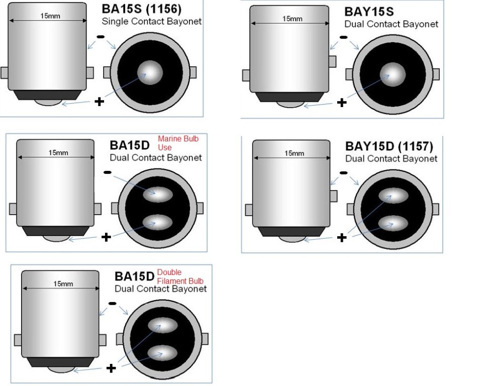

Testing direct to battery (wire to tip to shell (or other tip) to battery) if one of the LED bulbs is NOT working when hooked directly to battery the LED bulbis at fault. If said bulb doesn't work one way but then does work the other, the internal rectifier bridge in the bulb is faulty and not allowing current to pass. IF you have a series circuit (common on early electric lighting) then the faulty bulb is not allowing the ground side of the good bulb to carry through to the ground on the other bulb.
This is a common problem on 15-18 T's when converted from mag lighting (OK, darking, if you know what I mean) to battery lighting... People change the electrical source wire from the mag post to the switch, leave the rest alone, and don't realize that if one bulb or its connector is bad, you now have the famous Ford Unlighting. I was playing at this before we moved, but I was considering using a single coaxial cable as a supply source, that way it still LOOKS like one wire is feeding everything but actually each lamp has its own power supply... and covertly grounding the shell of the bulb socket to, well, ground to complete each individual circuit.
But using an LED (even tho they say it doesn't matter) sometimes polarity DOES matter... if your bridge rectifier is broken or insallled wrong, then you have a traditional LED bulb - one direction it works, the other it's at best dark, at worst it sends up the square smoke ring of death.

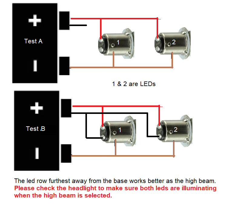

It would be better to address the leds by number to better understand which is which. Note that the directions for LEDs state "The led row furthest away from the base works better as the high beam. Please check the headlight to make sure both leds are illuminating when the high beam is selected. Just one row of leds on both sides light when low beam is selected" so this may or may not have something to do with the problem.
I diagrammed some tests. If one bulb does not light , reverse it in its socket. Your testing with an incandescent bulb is pointing to this as the possible problem. Since things are connected in parallel each bulb should be working independently of the other. If they were connected in series then as Susanne stated one would affect the other

Okay, I figured out my problem! And I don't feel like the sharpest pencil in the pack! I ordered the wrong bulb and didn't read clearly or understand what I purchased. Here is what I ordered:
https://www.ledlight.com/ba15d-led-head ... rized.aspx
When I saw Frank's post, I didn't notice the small, but important difference:
The price and image is the same... I assumed dual connectors on the bottom would mean dual filament. To get these working I figured out on my own as clearly stated in the instructions: "1142 Configuration meaning ground on one contact and 5 to 30V on the other contact." BTW if you are trying to figure out why it worked with the other headlight installed, the second filament of the incandescent headlight give a path back to ground.
When I went to make the order I was dizzy reading all the descriptions and restarted my cart more than once.
I appreciate everyone's' patience and insight! In the end the issue seems to be the nut behind the wheel.

Matt, what your order, BA15D - 1142 Bulbs are referred to as Marine bulbs. Easy mistake to make.
BAyonet base: 15 millimeter diameter: Y offset pins (no Y = parallel pins) : Single Contact:Double contacts
Model T bases are either BA15S or BA15D. Currently many filament & LED bulbs for BA15s/d sockets are described as taillight, brake light bulbs and 1156 bulb. (1157 bulbs take the BAY15D socket). So that's one of the reasons why those bulbs aren't bright enough for use in Model T headlights.
6v 1158 filament bulbs are dual filament, consume about 3amps and not very bright.
Note the diagram below from a manufacturer is a bit confusing so I am added another further down in this posting

Frank, is the figure in your post from a bulb manufacturer? It shows pin arrangement, but the BA 15D base contact polarity must be a typo, I would expect base and pin contacts to be same polarity as the for the BAY 15D?
It's small things like this in what I assume are Chinese to English translated specifications that sometimes steer the buyer to the wrong conclusion/wrong purchase. Just a rant, YMMV, jb
Posts: 6596
Re: LED light issues
Post by TRDxB2 » Mon Feb 06, 2023 12:12 pm
jab35 wrote:
Mon Feb 06, 2023 9:35 am
Frank and others: Thanks for the information.
Yes the picture of the bulb bases above is from "a" manufacturer. It is unlikely case has a connection to one of the contacts on the bottom of the socket. Likely they artist was referencing the type bulb connections vs the socket. New BA15D sockets have just 2 contacts & its up to the type of bulb to decide its ground position (as you have found out). "Marine bulbs" or bulbs wired in series like Model-T's with a dimmer.
Let me know if this revision makes sense

Thanks, Frank:
Your edits/corrections make it all good. When I see an obvious error like this in a technical spec, I immediately wonder what other 'lies', intentional or not, are being told, and how many of them I've accepted as fact. The 'fact-checkers' on the forum have filled in gaps and corrected false information in many similar situations and I appreciate that. Best, jb
