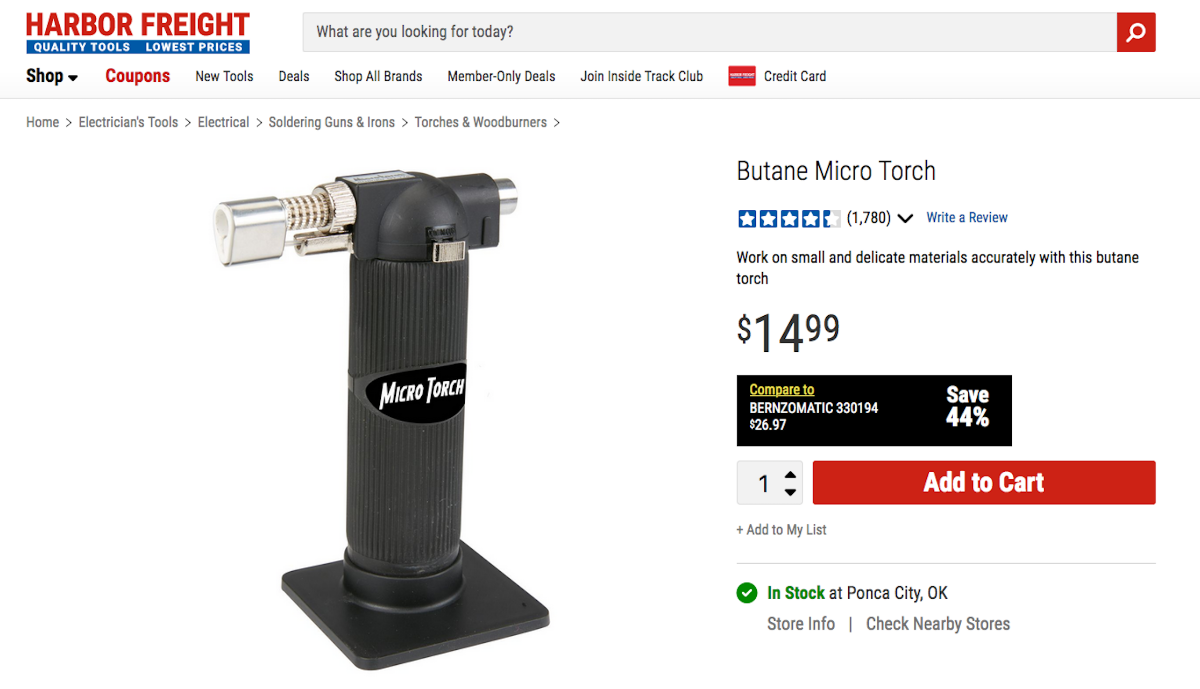

For many years I was disgusted as one soldering gun after another reached the point of Not Enough Heat, no matter how tight I turned the screws. Then I learned about the butane micro-torch. Much better, and I can use it to melt the butter on my oatmeal.
